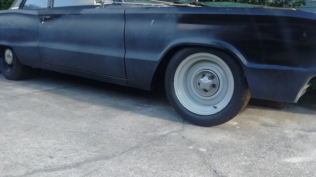

First of all, I would like to giveto all of you guys that do all or most of the work on your cars yourself! About all I can take credit for is driving 30 miles to go pick my car up from a friend (that does OUTSTANDING work) who has done the following work on my 69 Coronet 4 door:
Front Suspension and Steering:
Replace Inner, Outer Tie Rods and sleeves. Remove and replace upper control arm bushings. Remove and replace lower control arm bushings. Remove and replace upper and lower ball joints. Remove and replace upper and lower control arm limiting bumpers. Remove and replace strut bars and bushings. Remove and replace torsion bars and seals. Degreasing of all hardware and parts. Bleed and adjust front drums. Set front end height at 26” to wheel well opening ( approximately 1 inch lower that previous ). Grease all fittings. Pre alignment adjustment of TOE and steering wheel.
Rear Suspension:
Remove and replace real leaf springs. Remove and place bushings, spring shackles. Replace axle U-bolts.
Sway Bar:
Drill mounting holes in K-frame. Install K-member mounts and lower control arm mounts. Install sway bar with bushings ( greased with lubricant to avoid squeaks) . Lower car and tighten all connections with loaded suspension per instruction manual.
