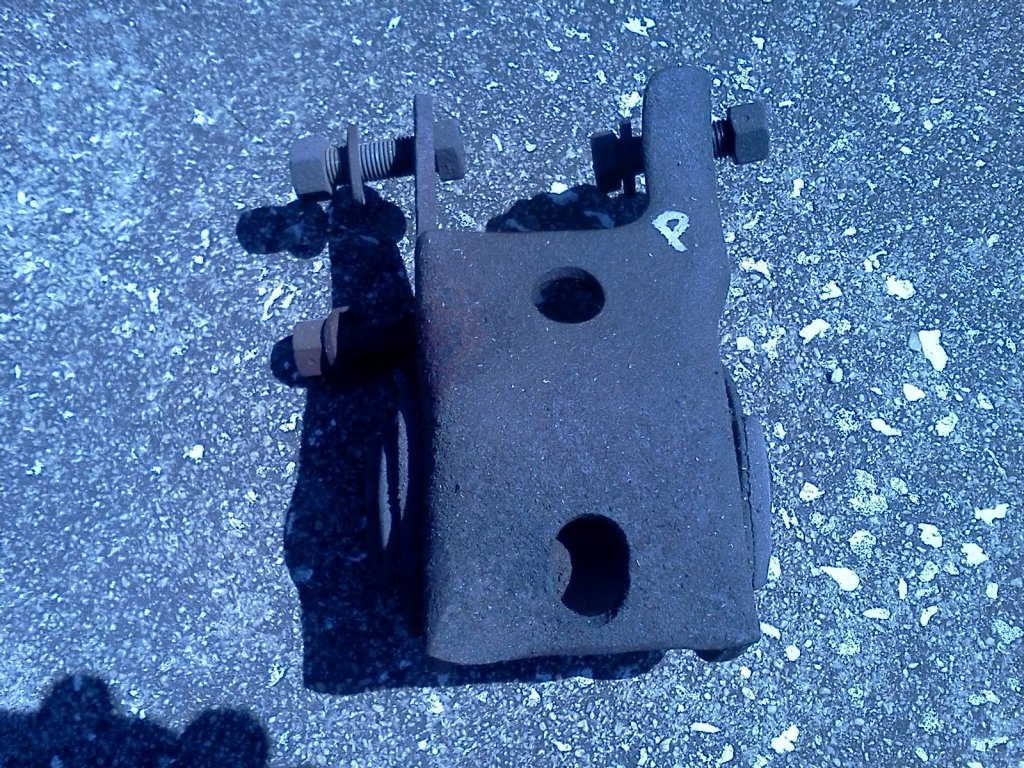

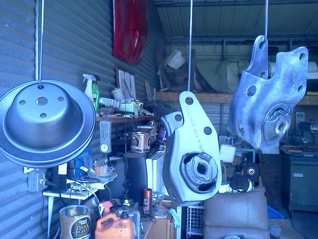

More blasting and painting.
I'm really loving the Krylon Tough Rust semi-flat.

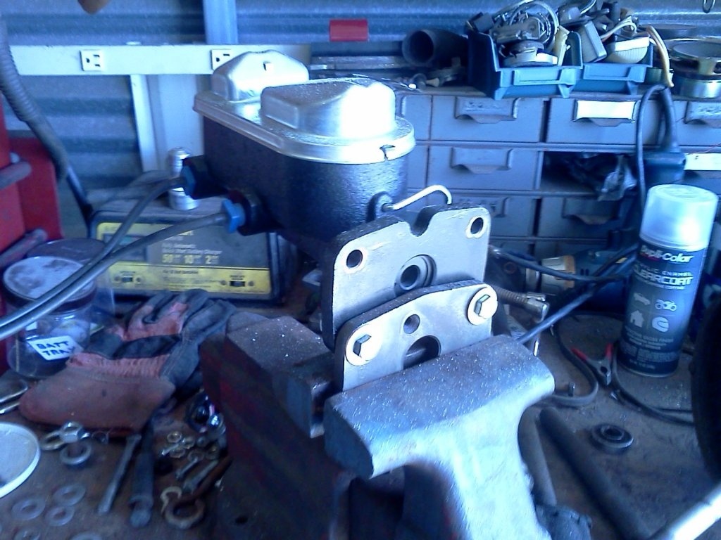

Fabbed up a jig to bench bleed the M/C, so I wouldn't scratch off the fresh paint.
It's a mounting plate I cut off a single pot, froze up M/C a while ago just to get the 1/4 plate.
What ya know, I found a perfect use for it. My go to plunger pusher is a #3 Phillips.

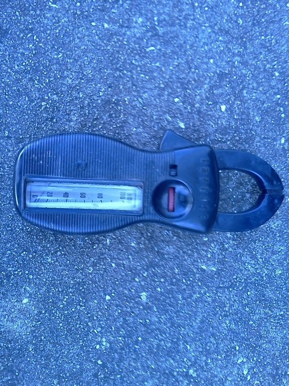

Scored this Amprobe clamp on at a yard sale for $1.
Rusted shut, but 10 min with liquid wrench...
It works.

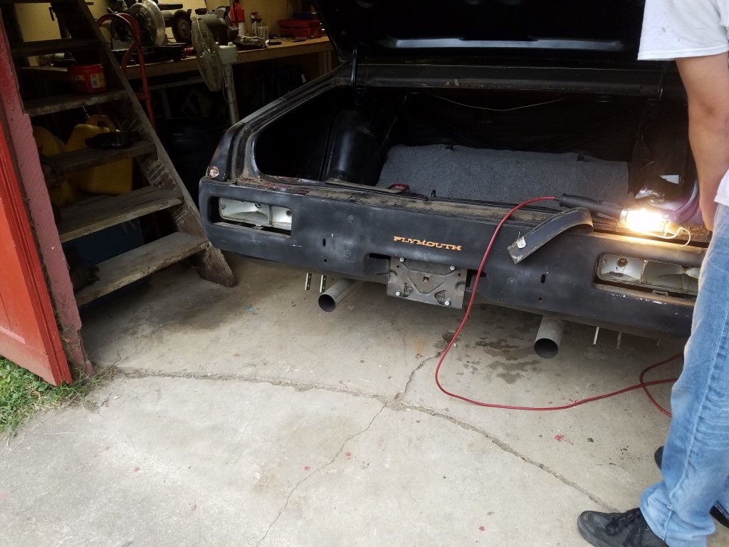

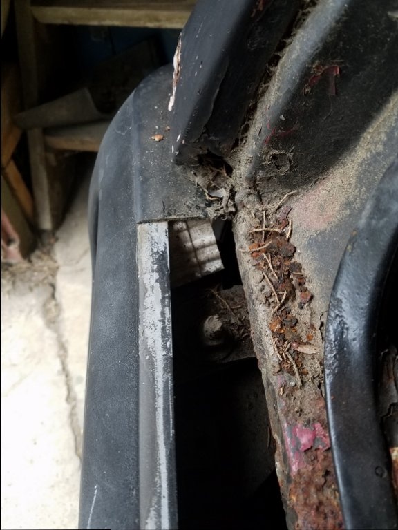

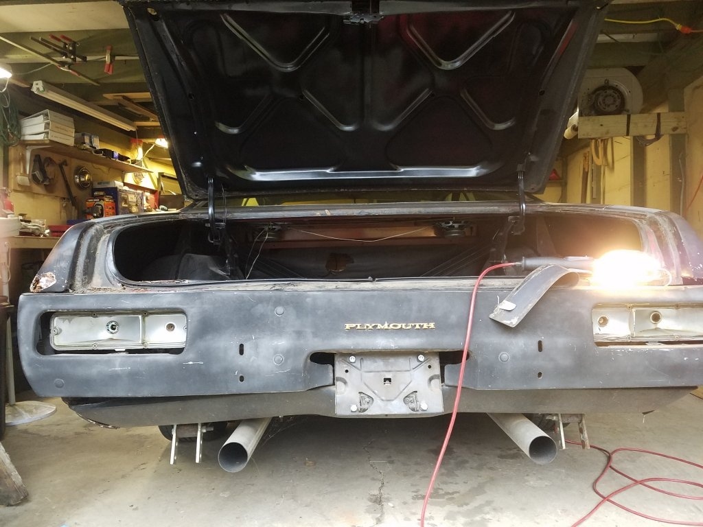

Today my son and I stared at the car for a bit trying to decide what we were going to do, it needs a lot of work. I looked at my son and said, winter is coming and suggested we do a complete tear down. He looked at me and without hesitation, OK let's do it!
We put the car in the garage today and started the first day of our complete tare down. I hope I'm not making a mistake doing this.
If you look real hard at the first pic, that's a white piece of plastic gutter down spout! I will show you at a later time where we have 2x4's in the rear fenders. I tried to edit this post due to the pics and it will not let me, sorry.
If you look real hard at the first pic, that's a white piece of plastic gutter down spout! I will show you at a later time where we have 2x4's in the rear fenders. I tried to edit this post due to the pics and it will not let me sorry.

Bag and tag EVERYTHING and take lots of pics for reference!!!
Yes lots! Luckily for us we have a second floor to our shop that is the same size as the first floor. Our plan is to divide that space up into sections, body, interior and so on. As the new parts are ordered put them with the old until reinstalled. Then take more pic's.

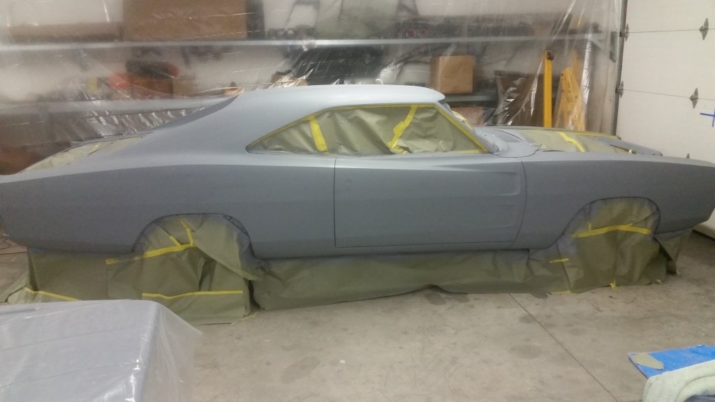

finally got a coat of primer after a couple
weeks worth of shaping body lines

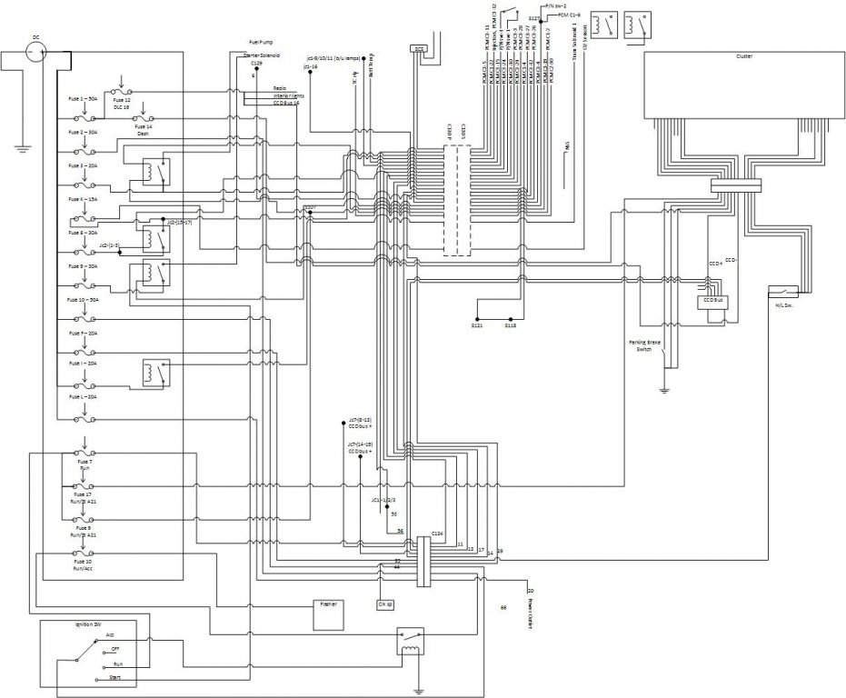

That's some nice looking wiring. You're making your own custom harness? Love that bulkhead and fuse block. I sell that stuff for a living.
It would be more accurate to say customizing the factory harness. I Started with a complete 98 Ram and have it down to just the drivetrain related components in the harness. I have been slowly depinning the factory connectors and rebundling the remaining essential wires to go through the bulkhead behind the engine. The other side is going to 2 Bussman fuse/relay panels that replace the entire factory power distribution center and junction block. CAN communications are still functional, as it the entire Ram instrument cluster. There are a total of 30 wires that remain and will pass through those bulkhead connectors. The remaining connections will be used for things like the lights and wipers rather than the OEM bulkhead connector.
This is an older version of what I have compiled for the harness. The current, organized and re-routed version of on my other computer, but this will give you and idea of what I am working with.
