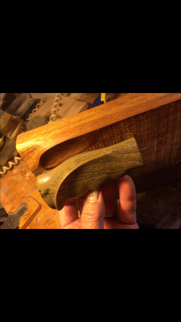

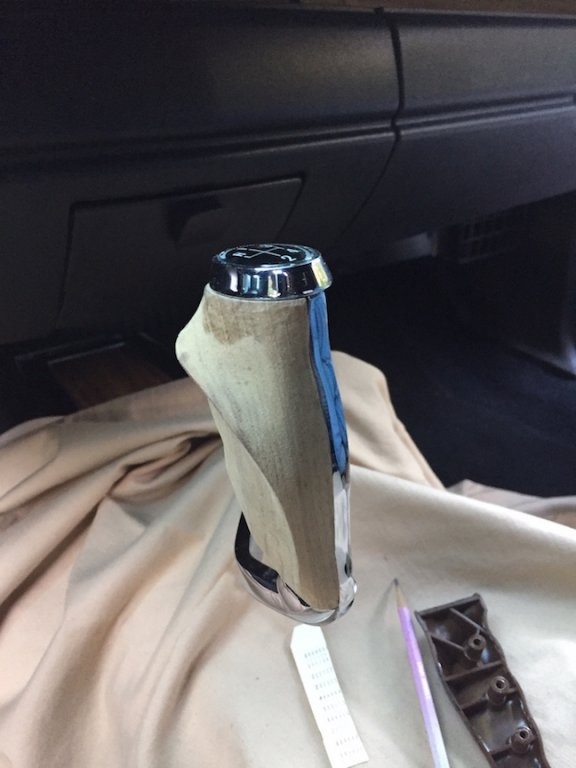

Had someone make me a real teak wood handle for my shift...didn't like the plastic one, work in progress

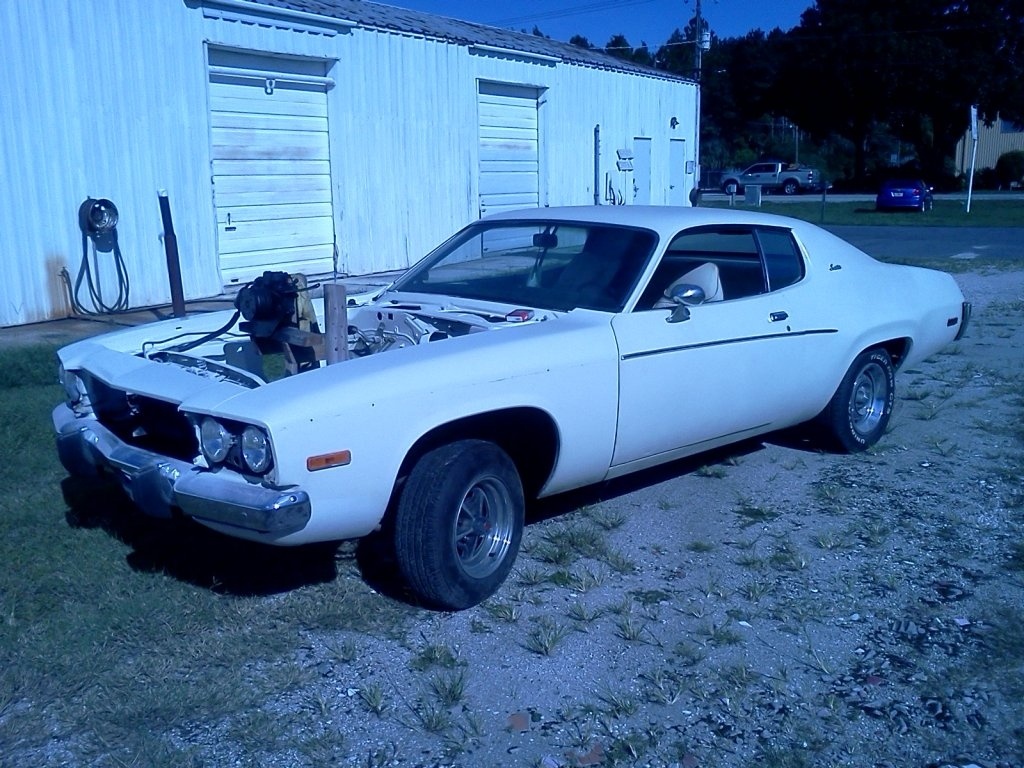

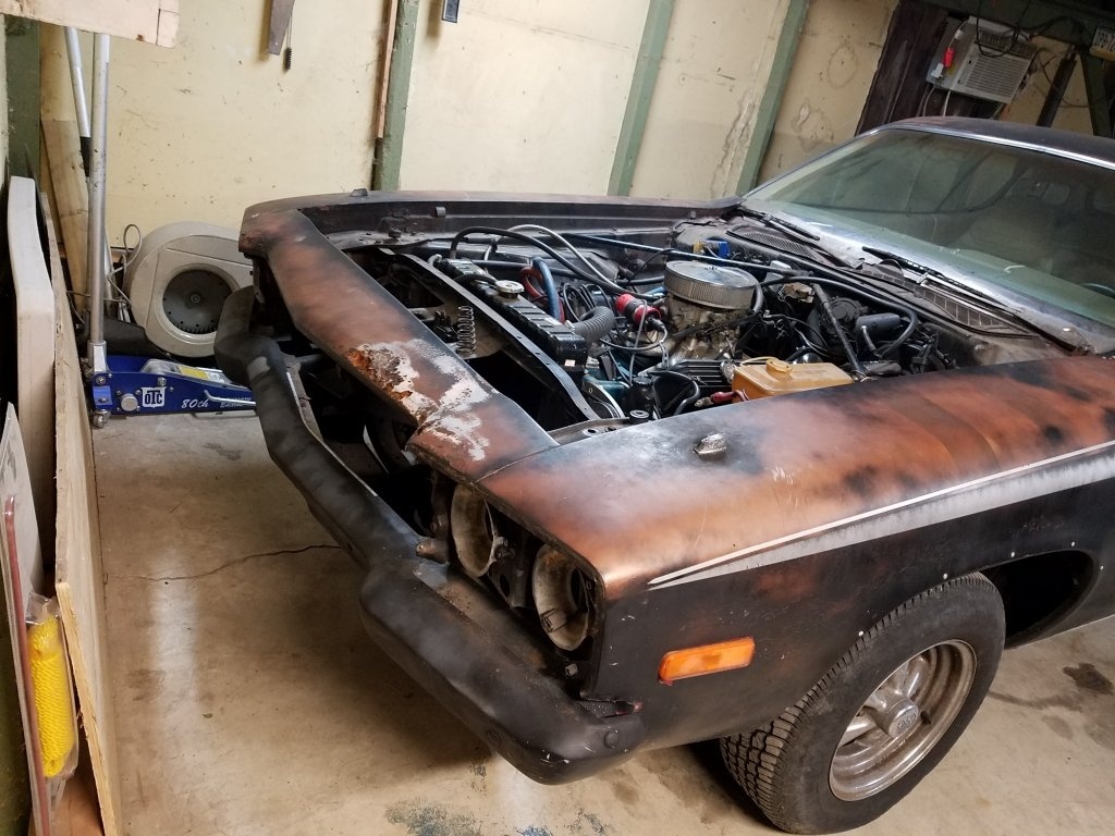

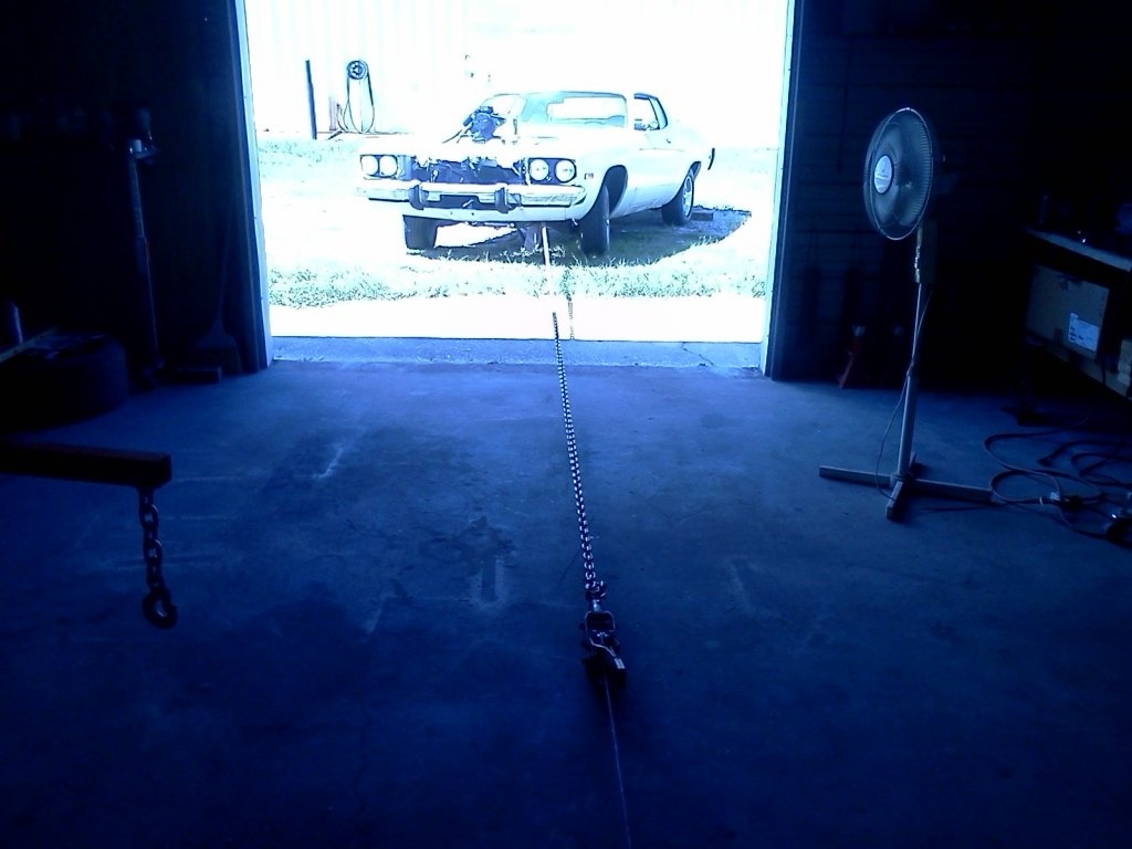

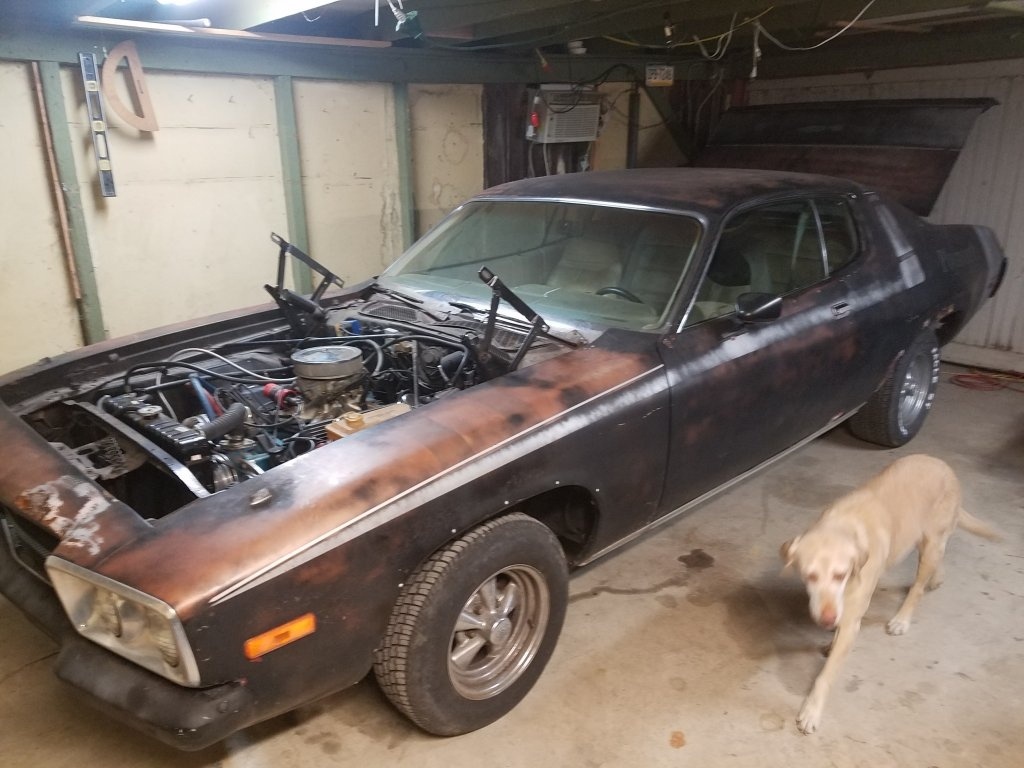

Turned it around in the bay to facilitate using the engine hoist.
Next time it comes out should be under it's own power.
Starting to get excited.

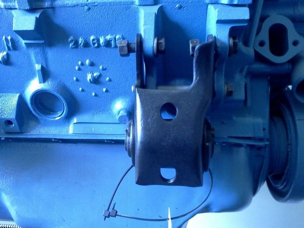

Say, is this motor mount on correctly? Should have taken a "before" pic.
Not sure if it goes ahead of the boss or behind. Not sure which 3 of the 4 holes get bolts and how they orient.
I likes me some teak!

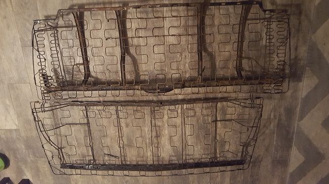

Rear Seats.

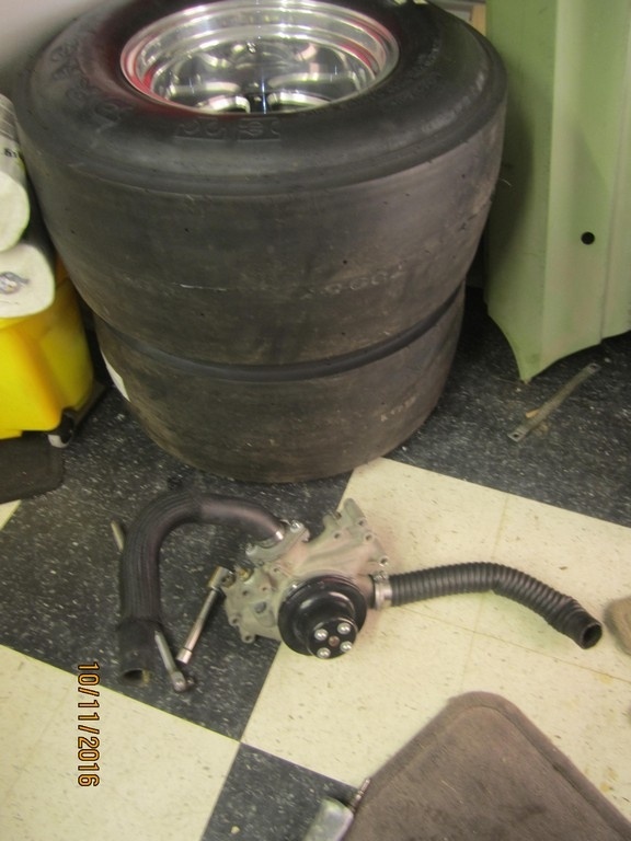

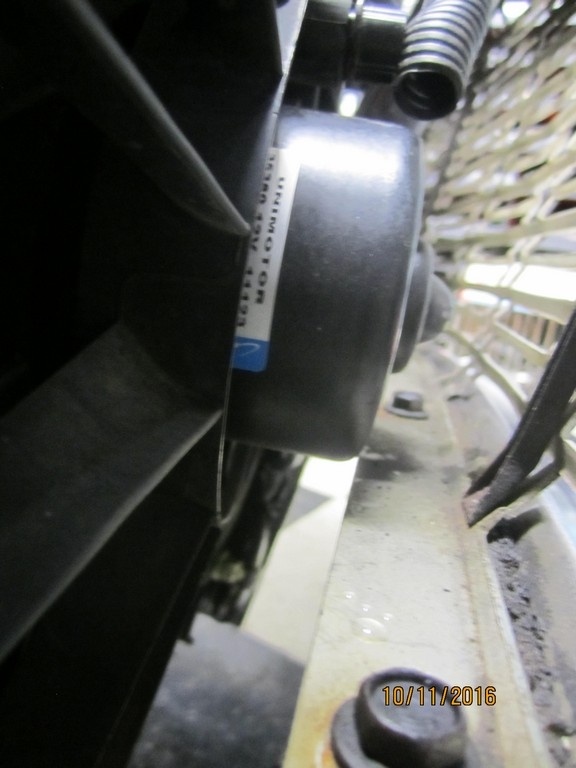

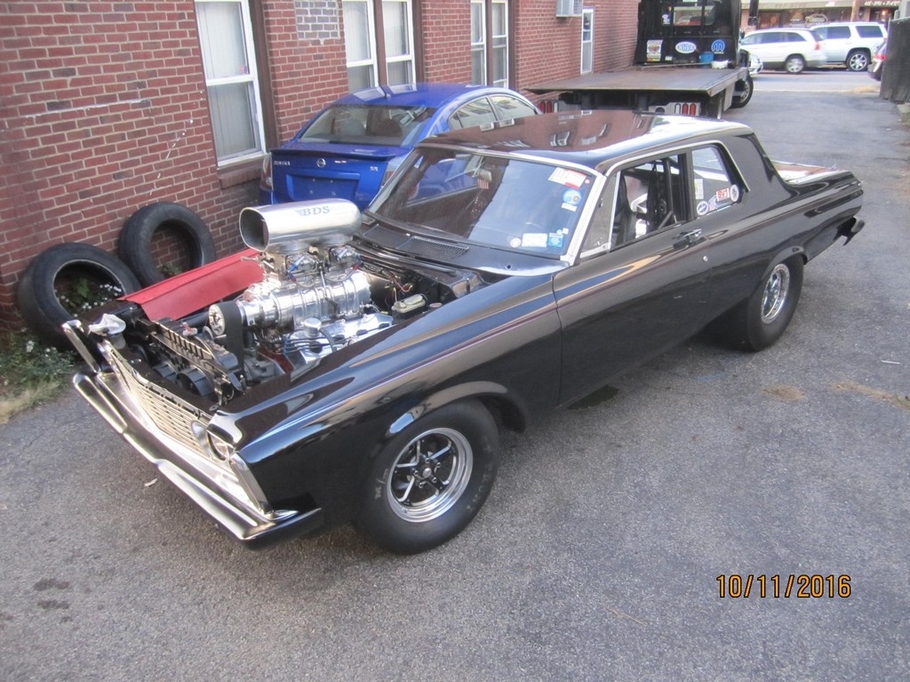

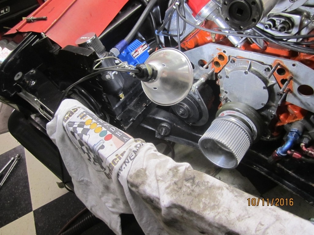

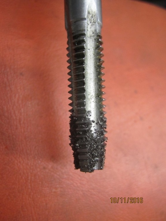

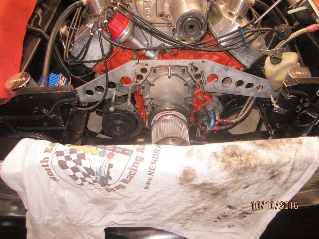

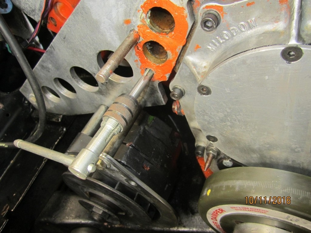

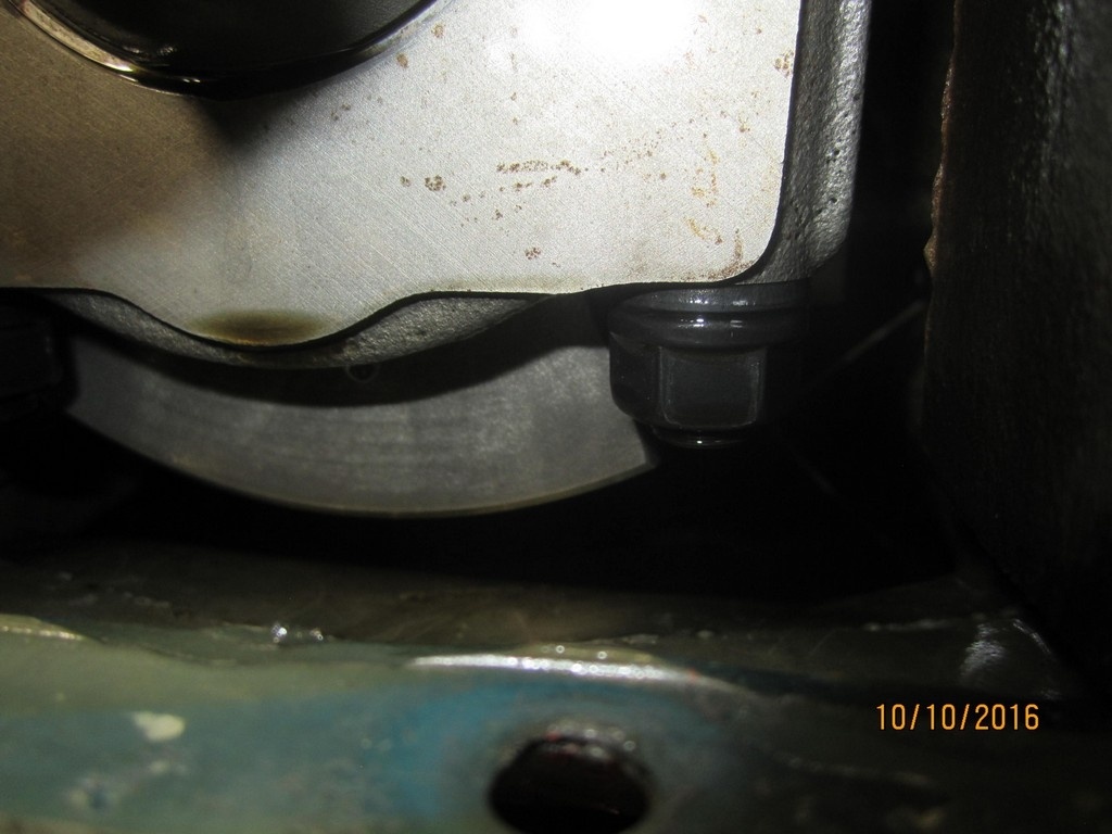

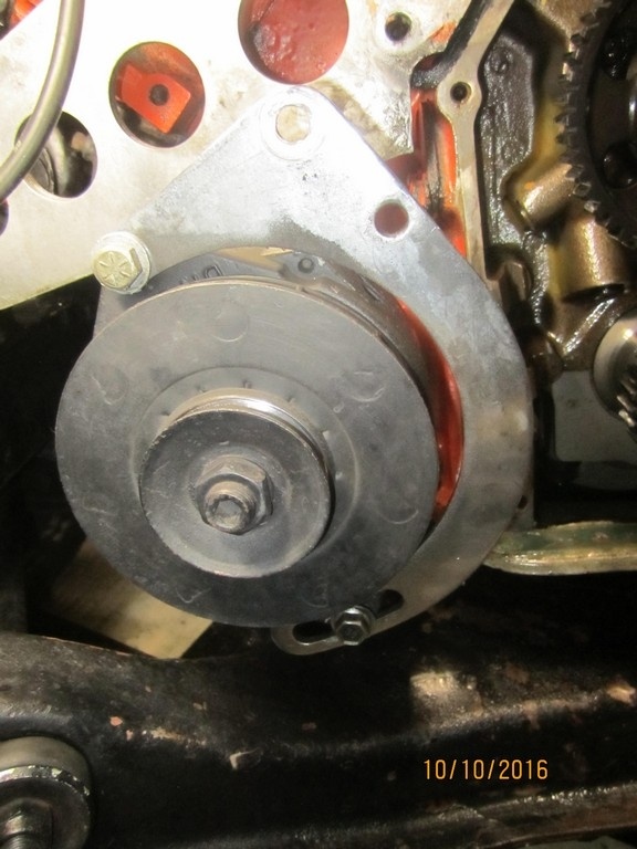

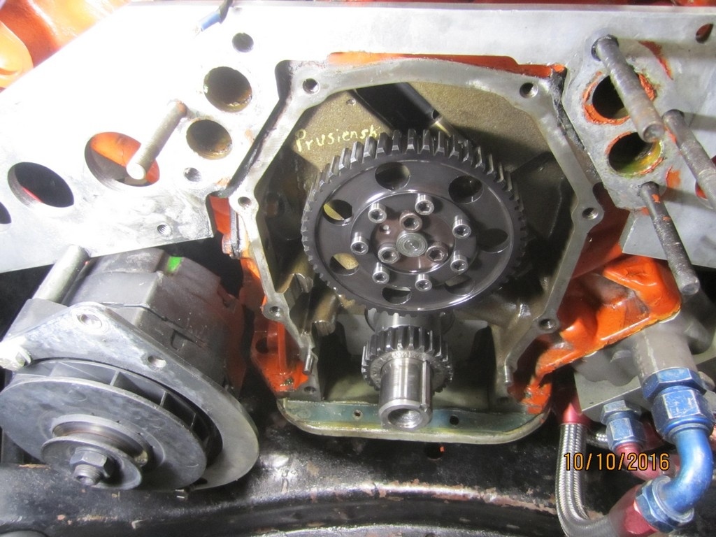

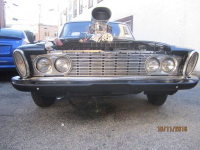

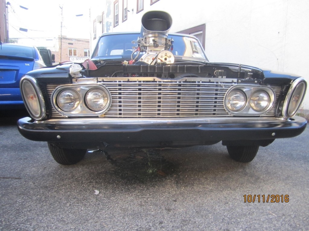

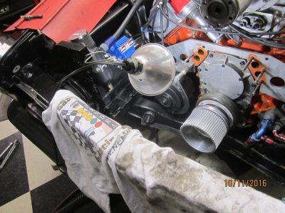

Had to address an oil leak that been buggin me.So I had to degrease the underside from the oil pan & "K" frame to the trans.It ended up being the gear drive cover idler axel cover.Remover the cover,heli coiled the 3 holes and put it back together. The other trans fluid leak is coming from the yoke off the back of the trans.Thought it was the rear seal,,but it leaks from INSIDE the yoke.There is some kind of plug in the center.Mark Williams said to clean it and silicone it,,,,,
10.10.16 004.jpg 10.10.16 005.jpg 10.10.16 006.jpg 10.10.16 007.jpg 10.10.16 009.jpg 10.10.16 011.jpg 10.11.16 001.jpg 10.11.16 002.jpg 10.11.16 003.jpg 10.11.16 004.jpg

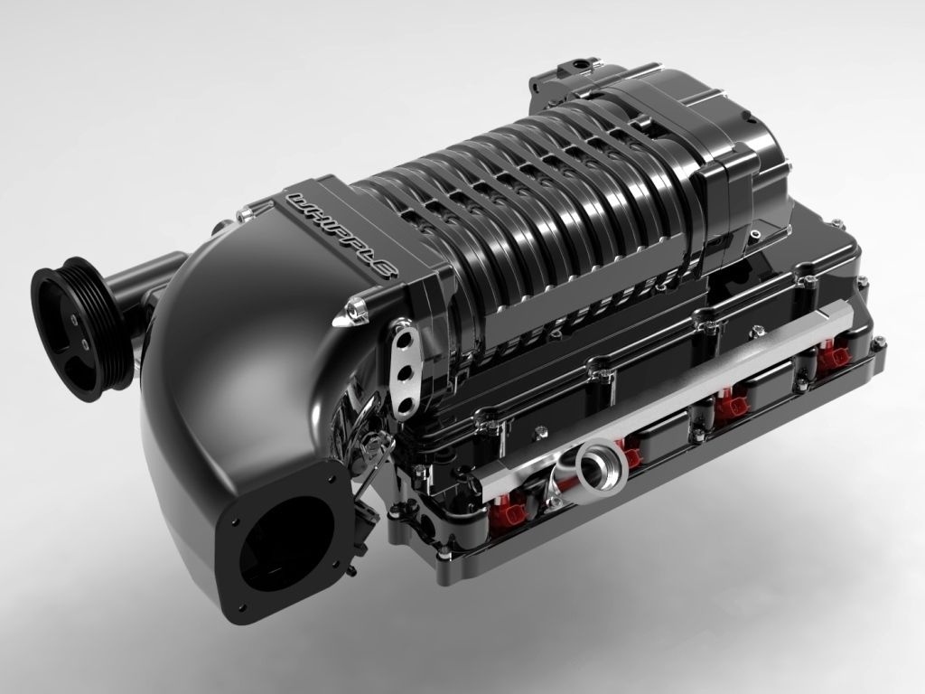

Than I did 4 drain & fills to get the antifreeze out,going to a track rental this week and will be my 1st trip to the track since last year. Had 2 daughters get married this summer which put a hurtin on the race budget. One of them picked my Chrysler Carlisle weekend to get married. So I'm looking foward to making a few passes. Have several smaller pullies to turn the boost up, want to see how fast I can get this street heap to go before doing anything to lower inlet air temps.
Had to start it after every fill with water,it just kept getting GREEN!

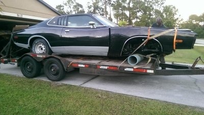

I sold my 74 s.e. sunroof charger today never thought I'd say that!

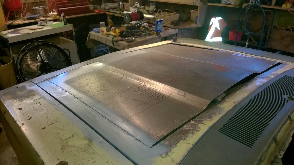

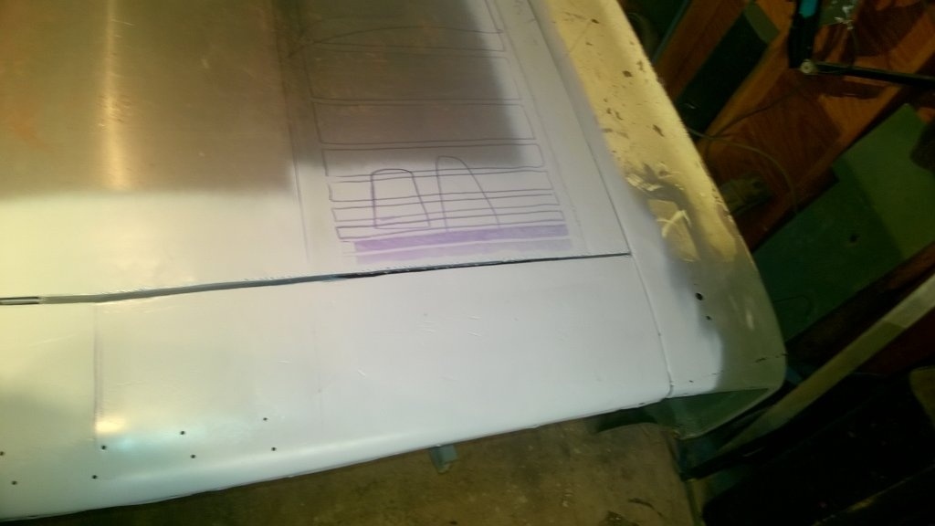

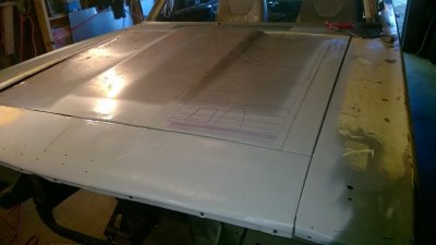

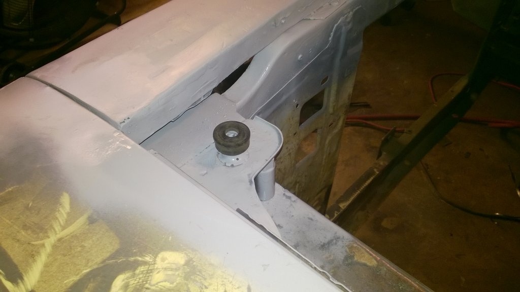

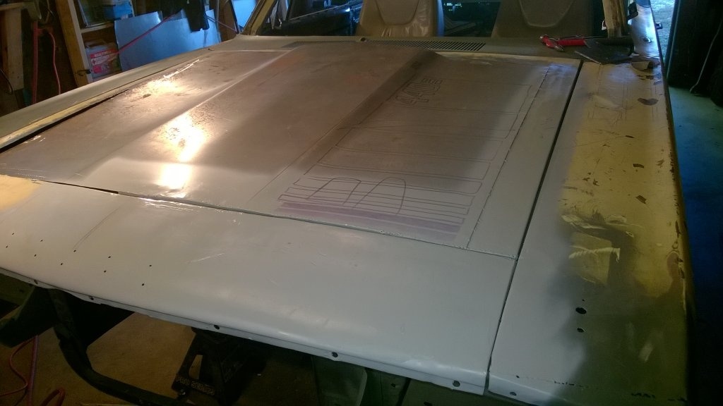

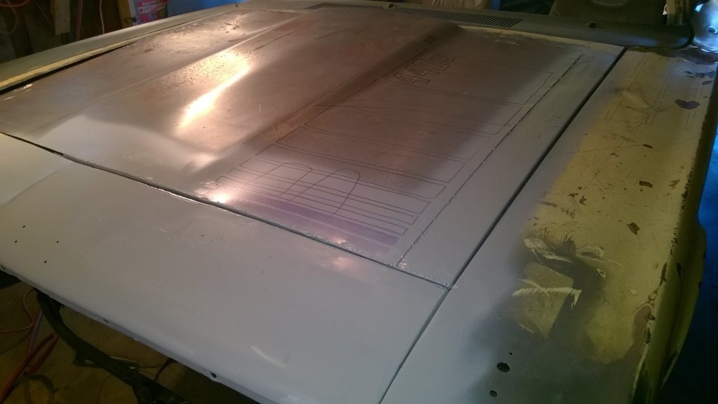

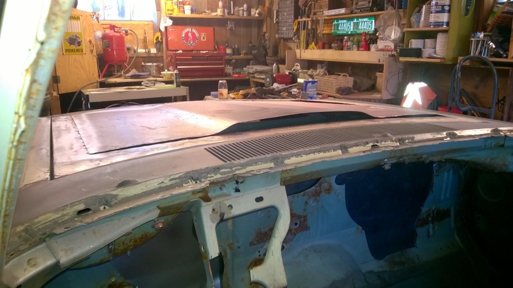

got the driver side of the hood situation worked out along with the front nose section. Also moved the bumper towards the rear to catch the new section as it comes down. Got some filling and sanding to do, and more welding of course. It is nice to see how it will look though. I like it! I doodled a bit on the hood to see what different stripes would look like. The doors and fenders need to be moved forward anyway so that will give me the correct 3/16ths gap at the rear of the hood and on both sides. Once everything is fitted up correctly I'll run some mud over the gaps and slice out the nice straight gaps with a razor tool.
