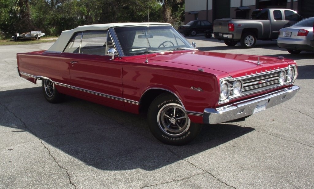

I took my 67 Satty convertible for its finish shakedown cruise!!! Took it out to I-95 between Port Orange and Edgewater and ran it up to almost 85 mph just to open it up. It was GREAT! You guys don't know how long--well many, if not most of you probably do know... It's been just over two years since I bought this old girl and she's 99% done. It was so good to have her on the open road and driving like she knew what to do again.

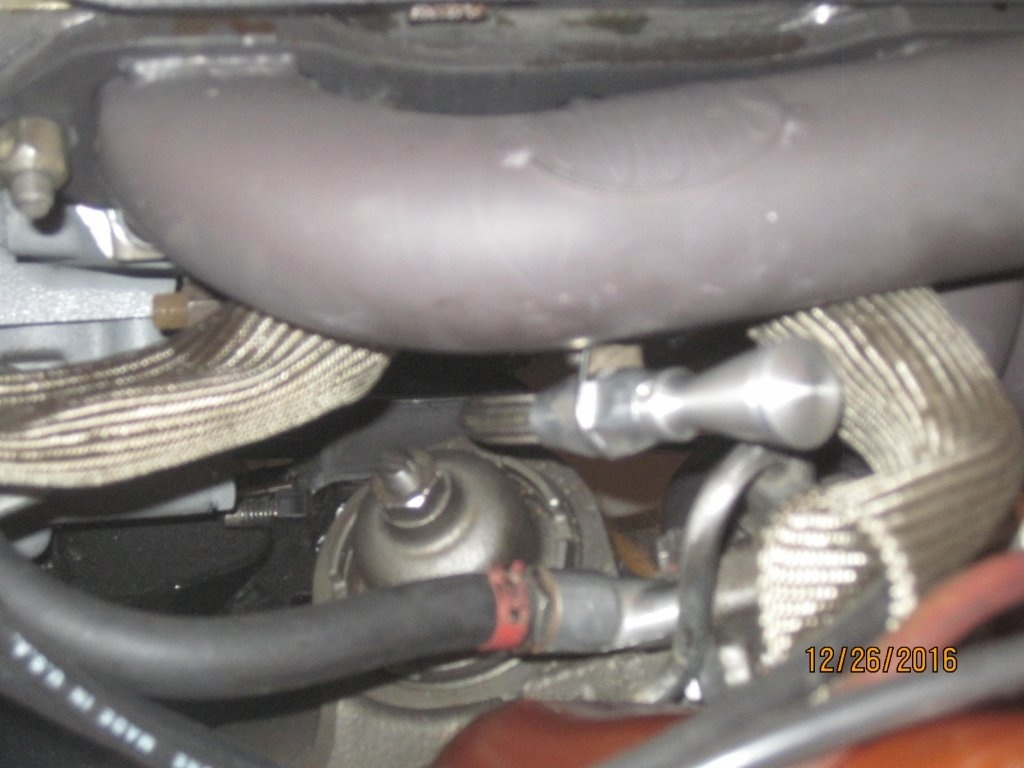

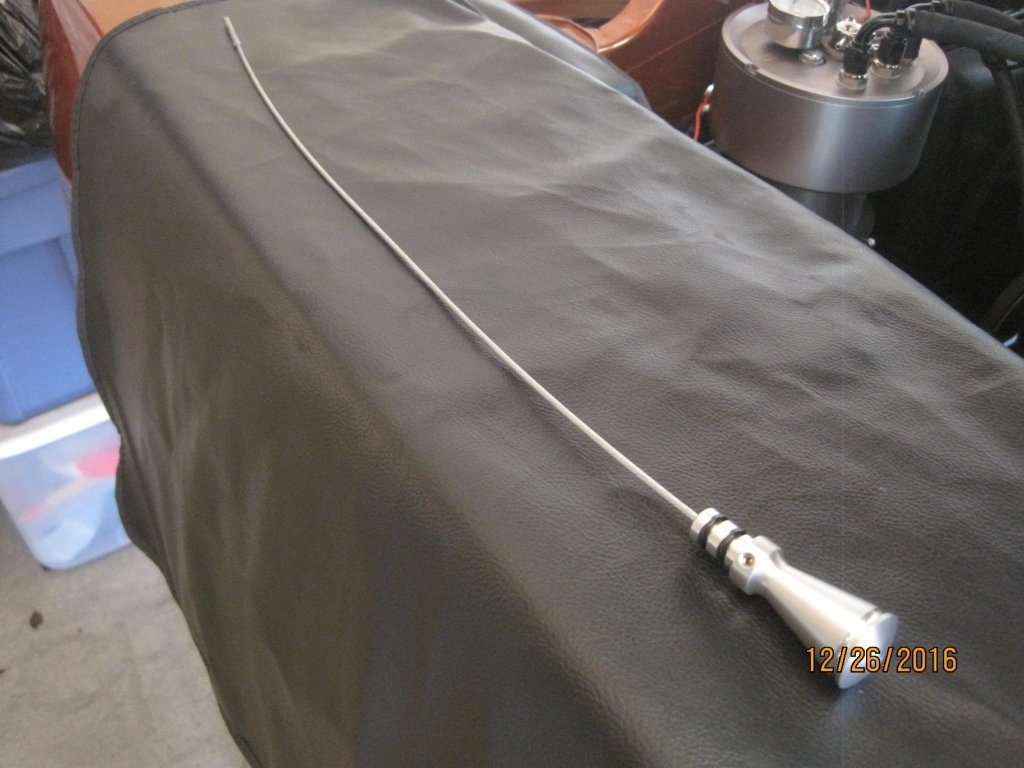

Replaced the cracked and leaking OEM dipstick tube with a Lokar flexible unit.

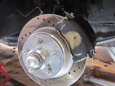

Later, jacked up the car to see what the clunking noise was - the RH caliber bracket bolts were finger tight. Damn! Re-torqued with Thread Locker and while I was at it, knocked about 1/16" off the brake pads; they were a little tight on the rotor.

The Lokar is a nice piece - double O rings down in the block, two more at the top of the 'stick.

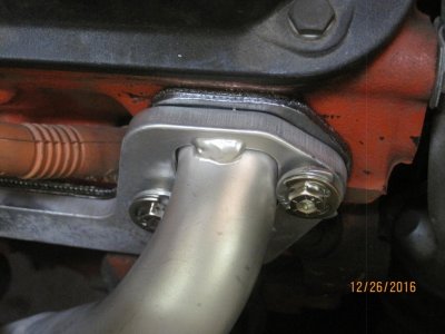

After almost two years of listening to an annoying header leak, finally replaced the gasket on the Dart. It's a Remflex - super thick with a 50% crush. Added Stage 8 locking header bolts - no more leaks. IMG_3756.JPG
