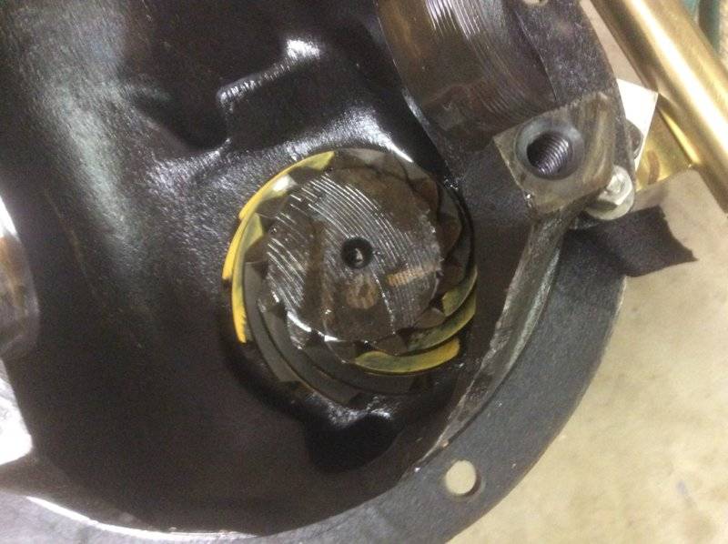

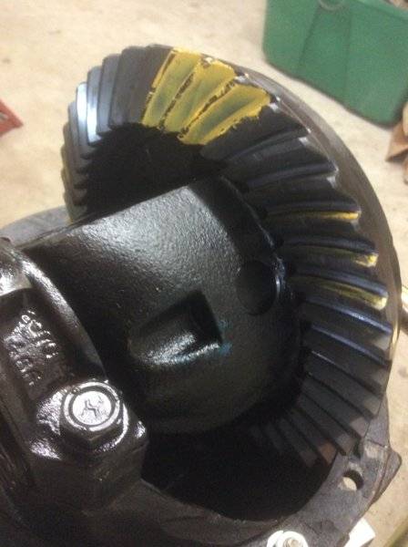

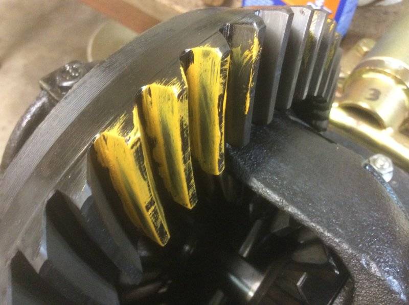

Marked the bearing caps. loosened ring gear bolts. Pictures of gear pattern. Loosen adjuster locks then tried to loosen bearing cap bolts, were they tight! 1/2" drive breaker bar no go, bench would move and couldn't stop it and pull on B bar. Ok, start air compressor get the air wrench and socket out. First 3 bolts came off fairly easy. The last one 4 times waited until compressor shut off at max presser before it broke loose.
This is a 66 open diff and I'm switching to a cone type suregrip can I use 66 bolts or do I need the later bolts with the larger shoulder. Think I have a set but finding them as with most of things I don't use often. Gear pattern before disassembly .011 backlash.View attachment 669419 View attachment 669420 ......
No GM puke yellow compound.Is that curious yellow?
