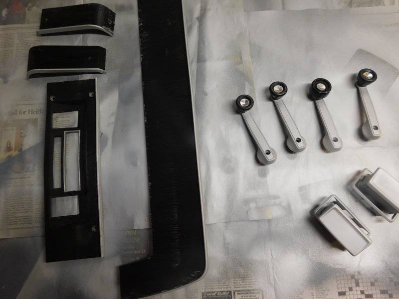

Clean up the dash pieces and the console. Will paint the black part when the argent trim color is good and dry. I did the handles and ash trays because the chrome was a little pitted, and I like the gray matching the door handles and the plastic behind my door arm rests. Pulling the cluster this week and will begin pulling that apart. Putting a 4" aftermarket tach deep in the factory tach opening, but I'm going to retain the other gauges. I don't like the fact that they're small, but I don't want to change the look of the '68 dash, other than the tach.

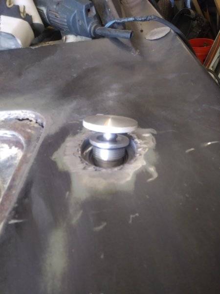

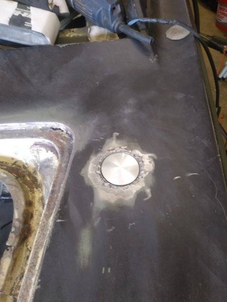

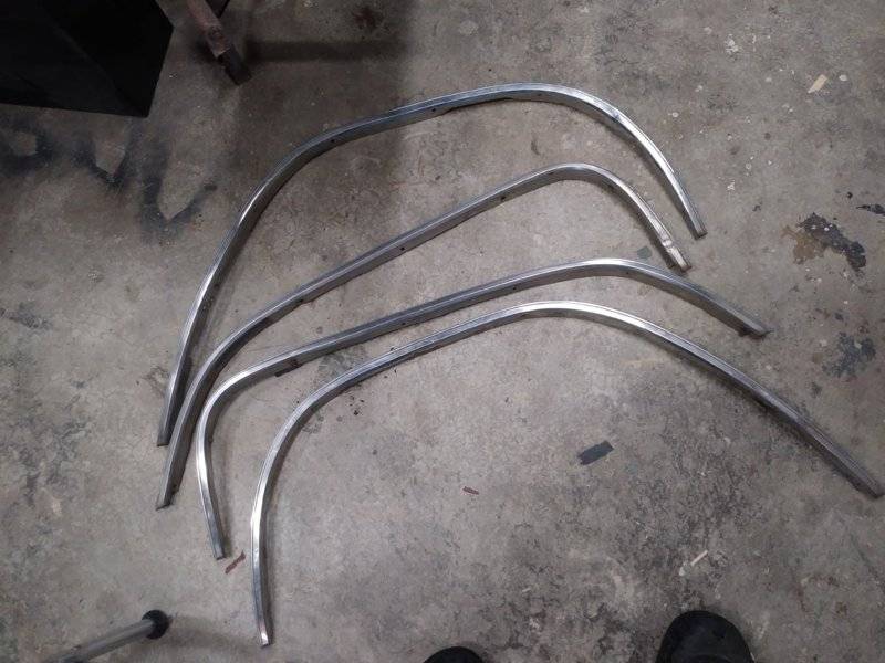

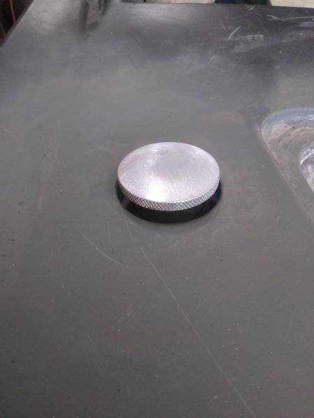

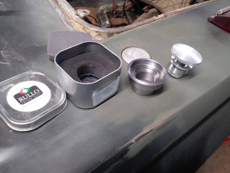

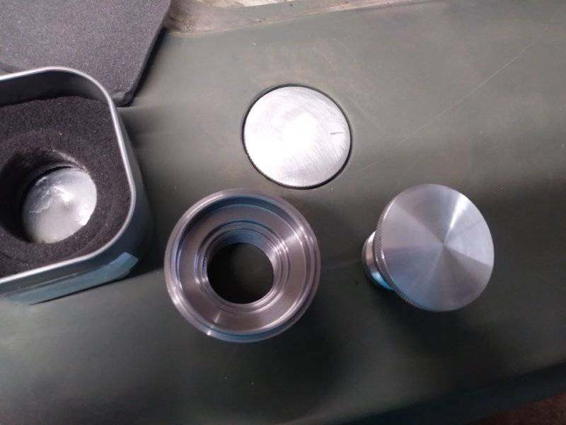

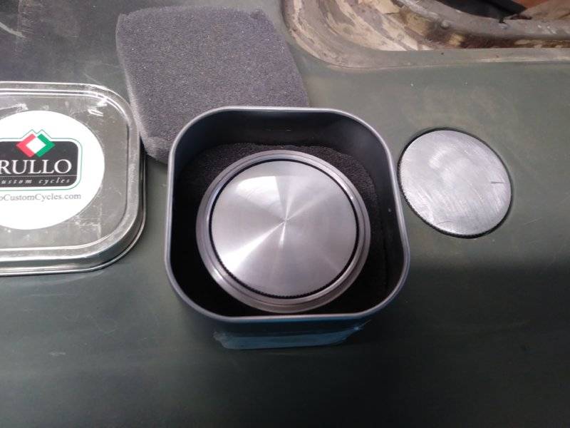

Ordered and installed a second pop up fuel cap....on the OTHER quarter top opposite the first one. Two reasons, use either side of the pump & symmetry. Will likely order up a lettering decal in a circular pattern slightly smaller than the caps in a tiny font. One will say "NITRO" only and the other "JETFUEL" only in a complete circle repeating over and over. Also I went over to NH to Mike 67's place and picked up the '67 R/T wheel well lip trim pieces. Also bought a gallon of smooth filler so I can finish up the body work.
How is the inside the trunk plumbing going. Want see pictures of that.
If you mean me, I cut a hole in the left trunk lid gas lift support and slid a hunk of pipe through it at the correct angle and welded it in place. Now two 90* gas hoses and that side is done. Now that I have added the second cap I need to locate/fabricate a "Y" gas hose/pipe to feed the right side in. I will be cutting another hole for the right gas lift frame to pass another longer pipe that will go across to meet that "Y". Haven't decided exactly how I want that to look yet though!

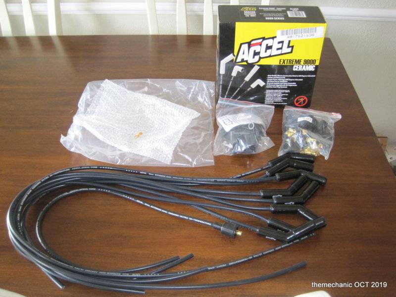

I installed the new HEI style distributor cap and 6 of the 8 ACCEL Extreme black ceramic boot plug wires (135/45 degree boots) #9002CK. I don't know why they don't just say 45.
Anyway, with 2" header tubes and 45 boots I could not get #1 and #3 on. I looked at buying the individual 90 degree boot wires but at $26 each (and only in white, :mad:) I opted to try the ACCEL shorty plugs and ordered from Amazon. The wire set only cost $110. The plugs arrive today by 8 PM. So, I'll let you know if that works.
I received the ACCEL shorty plugs but they are not short enough to solve my problem (see above). I reckon I'll have to order 2 individual plug wires for $53 plus shipping. :mad:

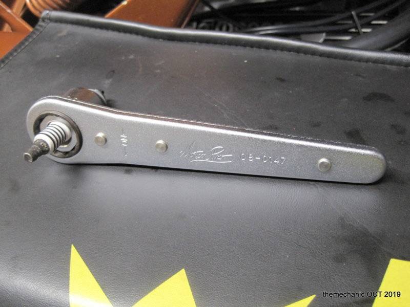

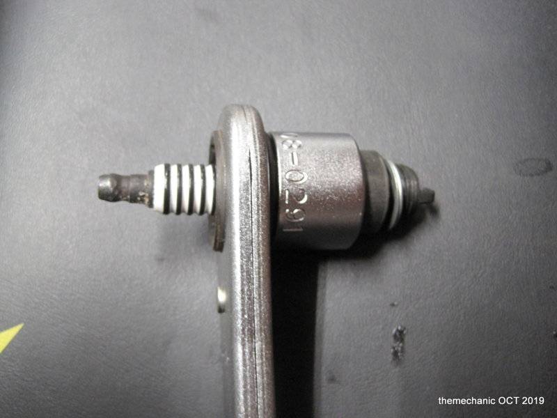

On a more positive note, the new plug wrench I bought works like a dream o the hard to get a wrench/socket on plugs. I bought one with the 13/16" socket. You can get a 5/8" socket for it, as well. "Where can I get me one", you ask?
https://www.amazon.com/gp/product/B000UKJ6AU/ref=ppx_yo_dt_b_search_asin_title?ie=UTF8&psc=1
On a more positive note, the new plug wrench I bought works like a dream o the hard to get a wrench/socket on plugs. "Where can I get me one", you ask?

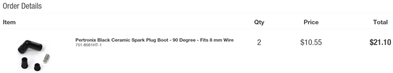

View attachment 853853 View attachment 853854
Thankfully, I found these and ordered them at Jegs since I have store credit there. I can just cut off the 45 degree boots and install these and Bob's your Uncle.
