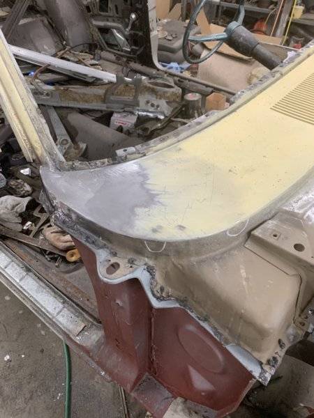

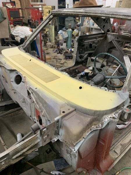

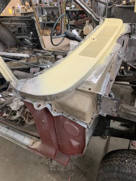

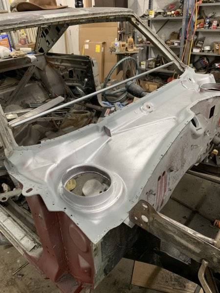

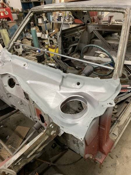

got the top on and spot welded up. Lead the ends tomorrowGot the bottom back on, top maybe tonite or tomorrow View attachment 885351View attachment 885352

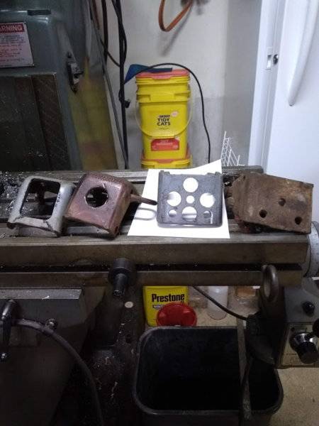

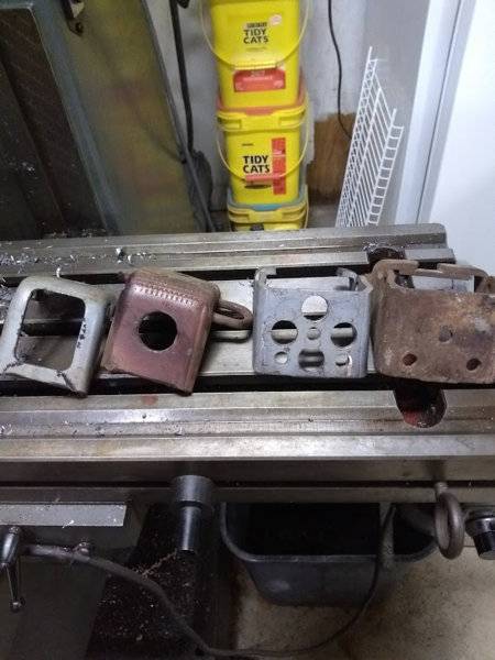

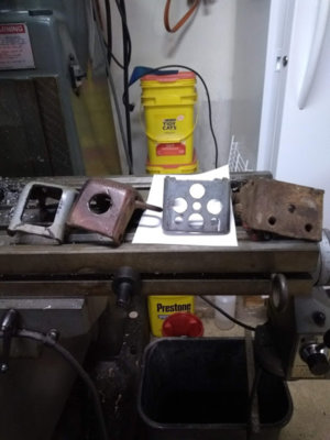

Unmachined hinges=1182 grams.....75% machined hinges=825 grams. 825 grams is 29 oz and change while 1182 grams is a little over 41 oz. I'm thinking that there's a good chance to get this hinge to be 50% of original weight. These things were designed to hold up some pretty heavy doors and my doors are no where near the weight of say an E body door weighs plus mine have been lightened somewhat too.Working on the lower door hinge.....weight reductionLoaded two pics as one might show better clarity. Still have more to do on that one but need to come up with a good way to hold the parts steady in the vise.

One side leaded in, took awhile, learning.View attachment 886898 View attachment 886899
