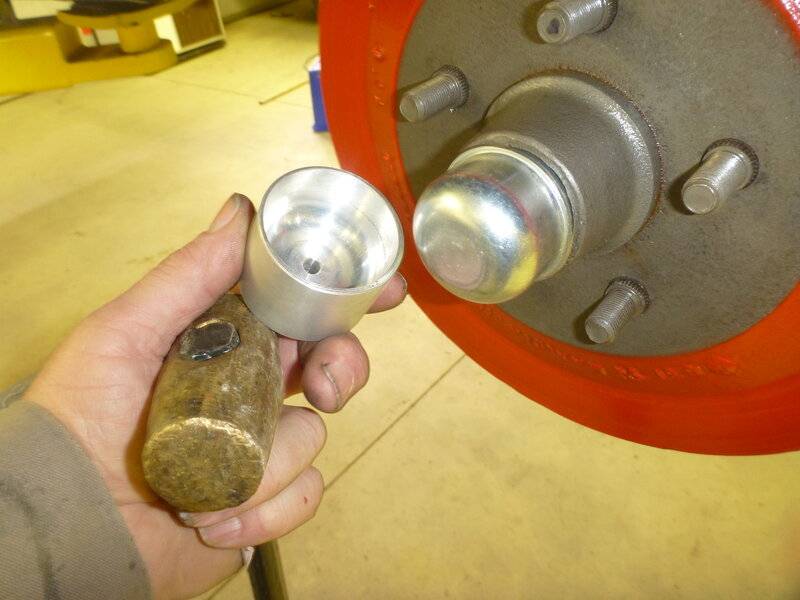

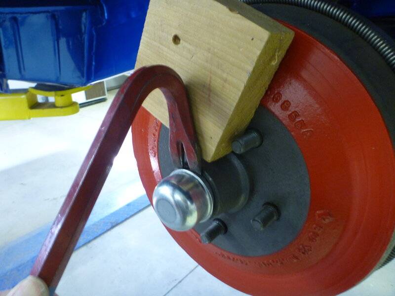

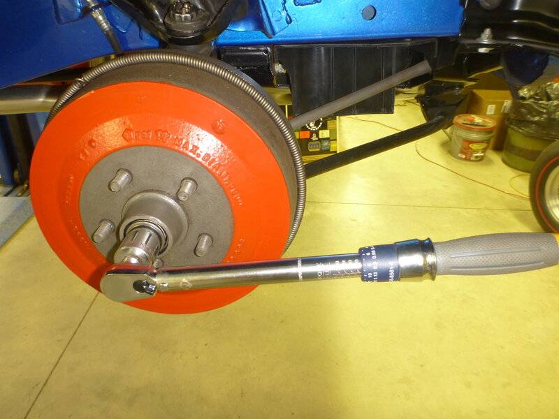

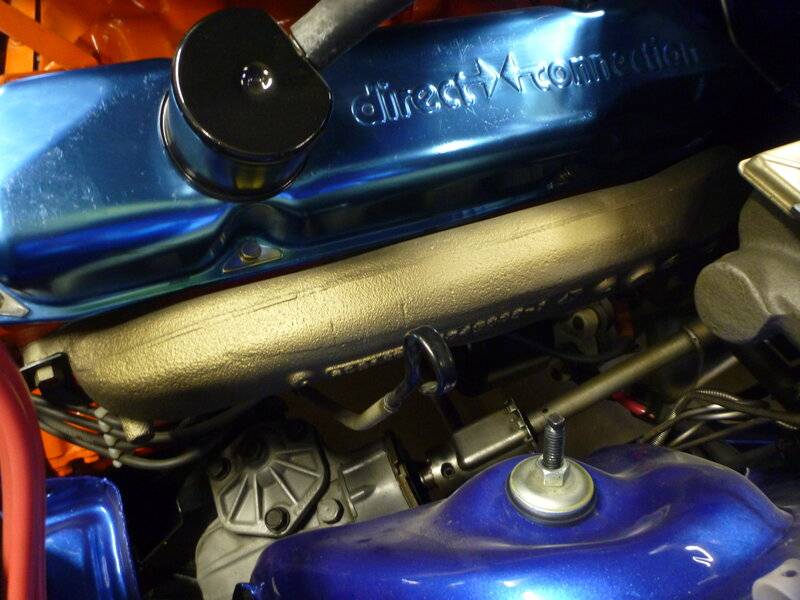

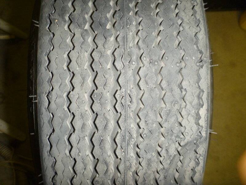

Checked my front outer wheel bearings conditions (fine) and retorqued both spindle nuts at 90in-lbs. Was a lot easier back when we used a hammer to removed dust caps. :eek: Tire wear looking good on my Goodyear Redline Raceways. Snugged up my weeping rocker covers and :praying: that stops the drivers side from leaking and noted after 204 fairly hard miles, power shifting all the way, there is yet to be any discoloration or burning off of the VHT Cast high heat paint I baked onto my HP manifolds. Ready for another cruise... :steering:

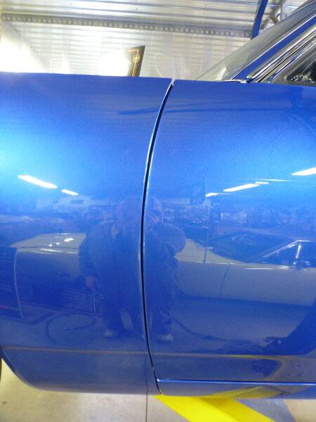

One thing I will add for the guys I see doing body work on jack stands. Make sure you have said stands in a location to simulate front and rear wheel locations. Lifting a B body on a 4 arm hoist certainly changes the door gaps. Not as much on my B posted Bee as compared to my hardtop Bird, but even on the Bee the top of the fender to door gap grows around 25%. Hard to show in pictures, but it's definitely "there" in person.
On hoist:
Wheels loaded on floor:
It's true, even on floor jacks. These rascals twist a lot more than you'd think!
In comparison, the '12 Charger R/T we have flexes ZERO when jacking up any corner.
You try to get one corner up, the whole side comes up the same amount every time.
It's hilarious when you straddle a drainage ditch or some such and the thing lifts a leg like a dog. :-)

Wayne, don't you have anymore paint for the drum? LOL!(4th pic)

Wayne, I admire your attention to detail, but you snagged me again and I have to ask.....re post 8004, did u remove, then replace/re install the outer drum vibration springs. If so, how’d you do it. Mine were missing, purchased a proper length set from a member, but can see their gonna be a PITA to put on. Was thinking about trying brake spring tools or trying to fab something.......Jim
