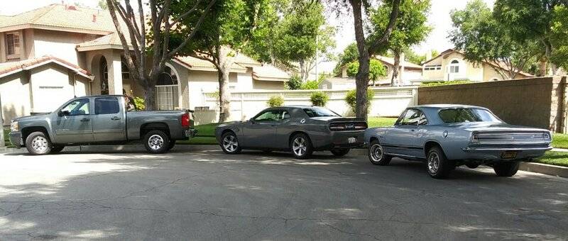

Washed all 3 of my vehicles this morning. ..

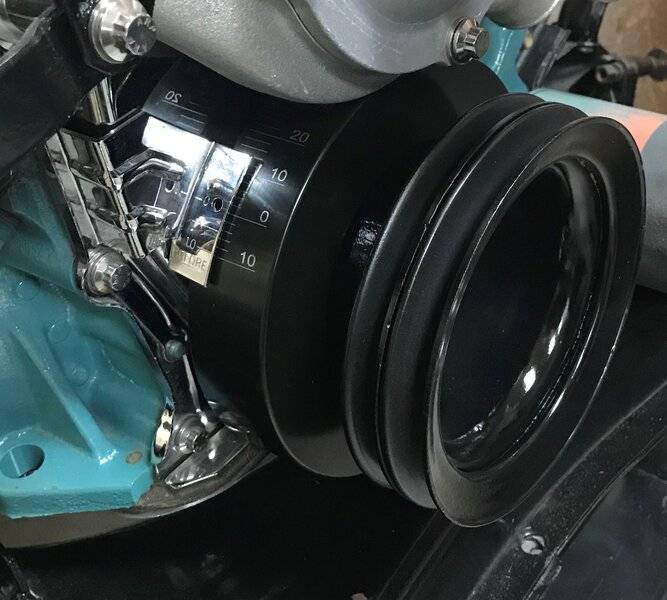

Installed the new Fluidampr from 440 source. Thing is built like a brick sh!t house

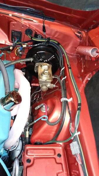

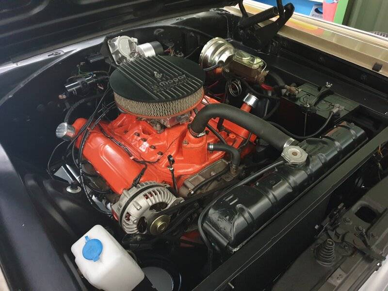

Got the new headlight hose kit installed tonight. Nicely made kit. It was harder on my back leaning in the bay routing everything than it was to figure out where everything went. Herniated a lumbar disc 12 years ago and still paying the price...but still feel fortunate to be able to enjoy this hobby for 35 years.

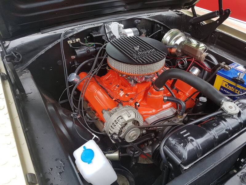

Painted the battery black. I hated the yellow/blue one in the engine bay. It's a good brand, made in Australia, just looked out of place. Hope I don't need a warranty claim....

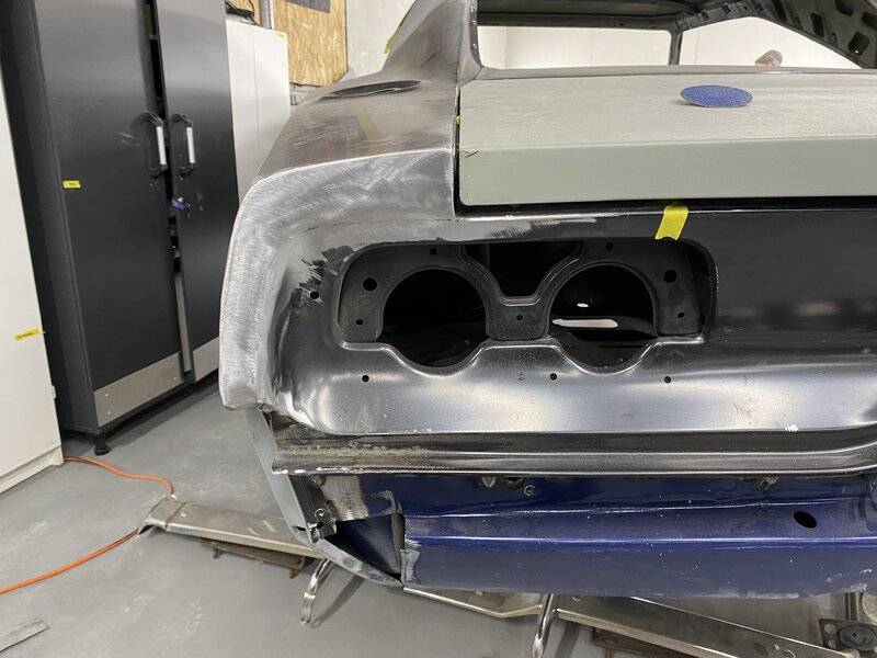

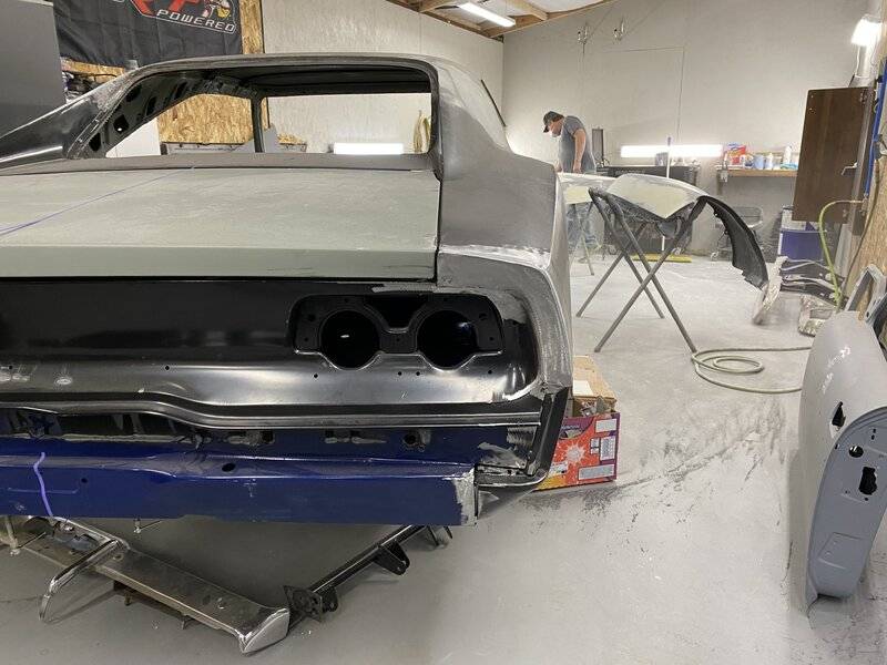

Deleted the pot metal quarter ends and gaskets and Aaron hand made full metal with no seams.

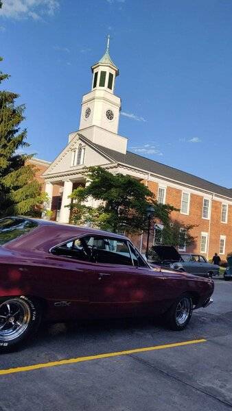

Attending the local cruise-in with my wife this evening. Gorgeous weather finally.

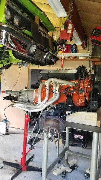

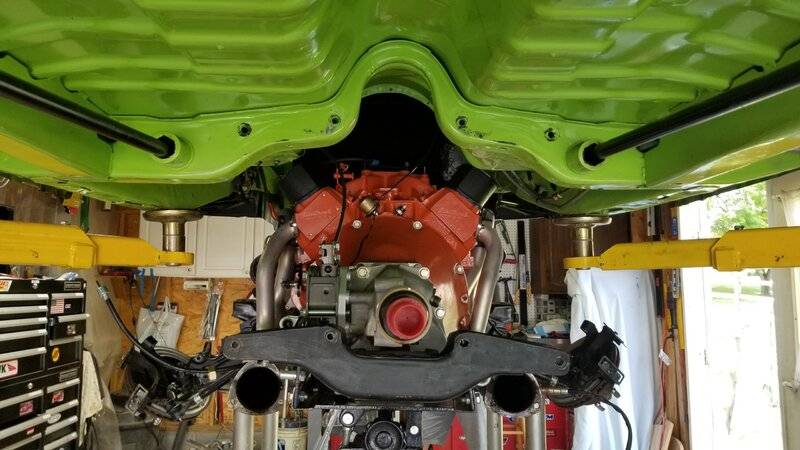

Pulled my drive-train today to fix a leaky rear main seal. This time, I dropped the whole K-member assembly onto my welding work bench. A regular transmission jack held the transmission. It worked great and I never needed to crawl around like a worm! Once out, I simply unbolted the bellhousing and slid the tranny back, then lifted the engine onto a transport crate.
View from the back
Here is a side view once the whole assembly was pulled forward
Here is the engine on the transport crate. I will load it into my truck a week from Monday and then put a new cam and rear main seal in the car.
