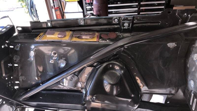

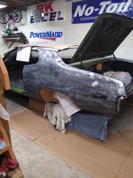

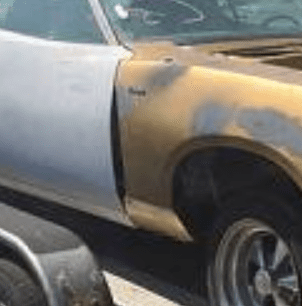

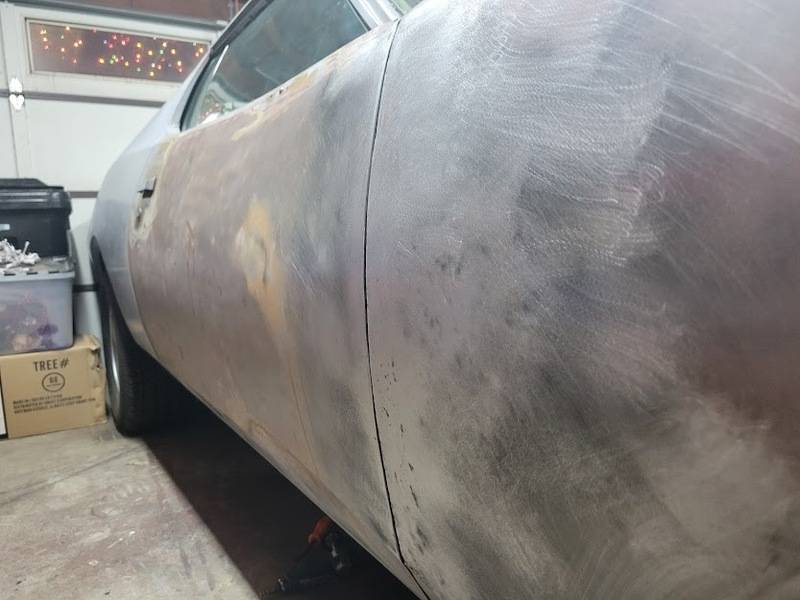

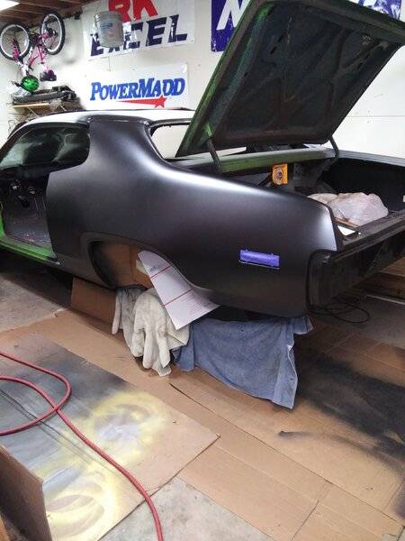

Finally got everything buttoned up on the driver side quarter panel. Smoothed out welds & scuffed it up. 2 coats of epoxy topped with 2 coats of 2K high build!
This was the last big area, rest is small potatoes!

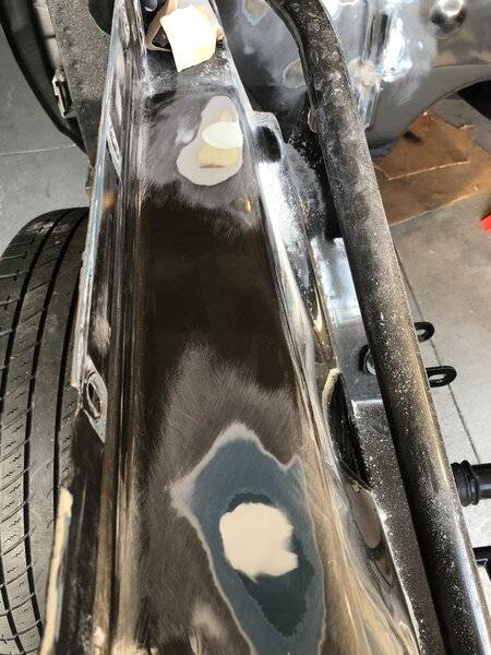

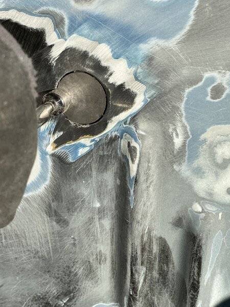

Back to work on pass side fender edge. I think it's about as good as I can do. Ready to sling some mud.
jMt-P8OKWdXOjvdm9h_YVdZPsJ84ASJSOUFuh1-5lf49UfmNbkfUOrGdzm39yib8rnigsalM=w681-h511-no?authuser=0.jpg
I did clean up the gap after this pic was taken.

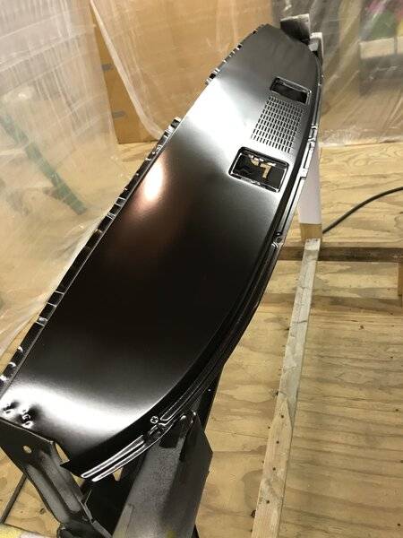

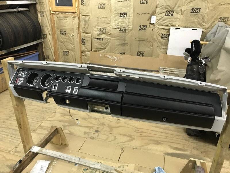

I test fit my gauges, bezels and dash pads on my dash frame before I paint it. Need to make some minor adjustments to the lower left dash pad to get it to fit properly.
Painted my dash with SEM Hot Rod Black. Still has to dry some more to get to the matte black.

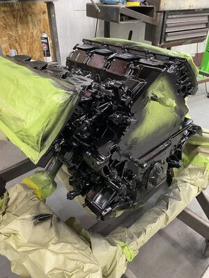

Put bushings in my dual distributor housing. Painted it and put it in the garage oven to cure it.

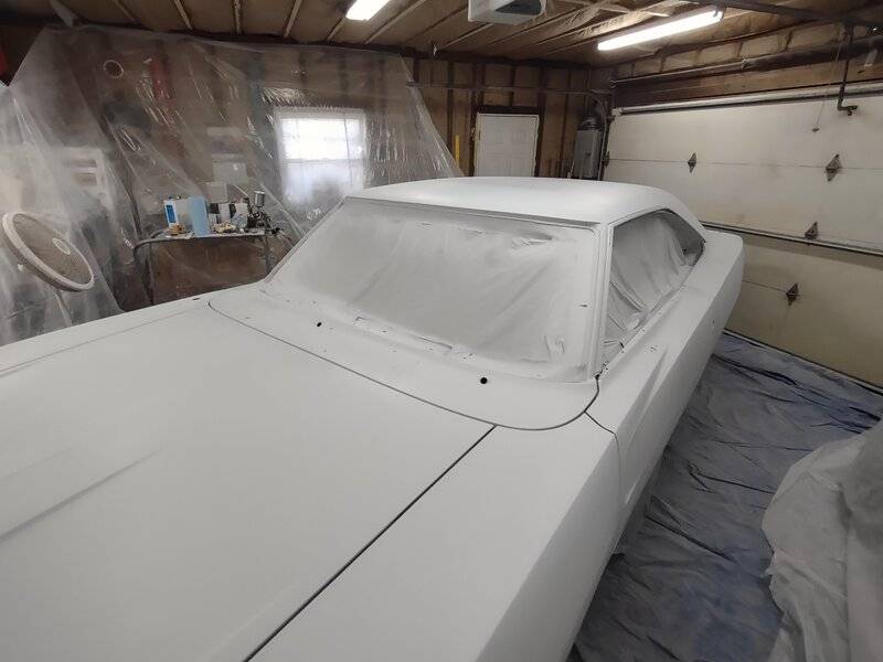

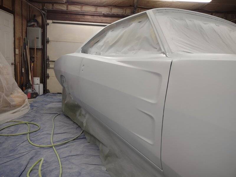

Over Thanksgiving weekend I sprayed the Charger with epoxy to lock down the filler and cover any bare metal spots. I got the epoxy sanded and today I sprayed the car with polyester
