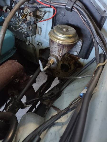

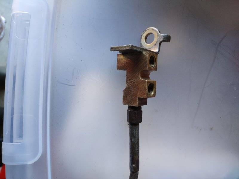

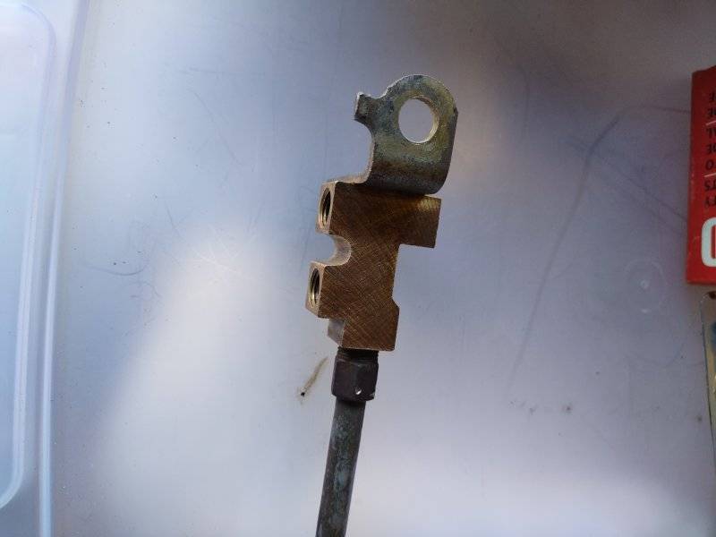

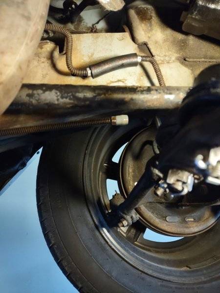

Brake work today. Yes, the old single pot master is finally history. I love working on rust free desert cars. A quick blast of penetrating oil and all the 57 year old brake fittings came right out. The factory distribution block will be used for the front disc brakes, and the line to the rear drums will be separate and run through an adjustable proportioning valve. The old inlet, the one with the line attached, will be plugged.

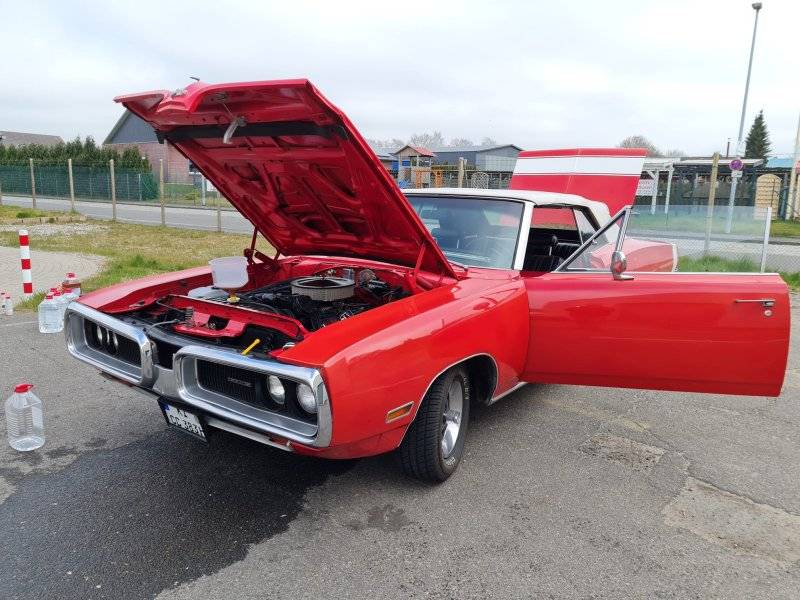

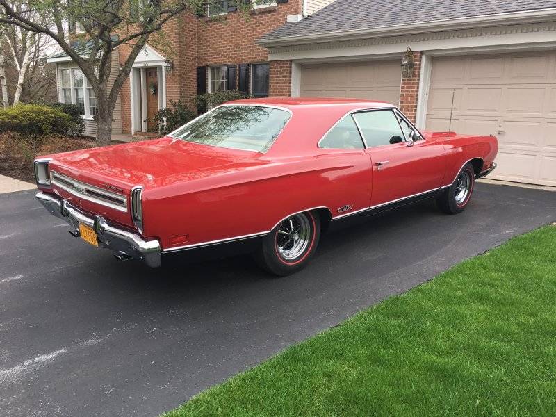

Got the Charger out of winter storage yesterday, went for a long drive today. Good to have it back home..

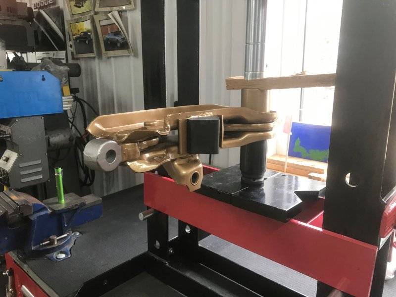

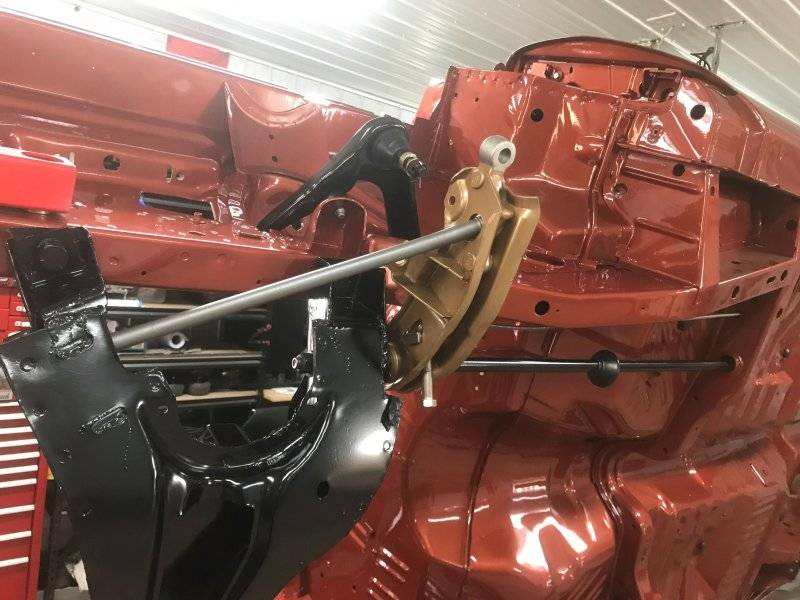

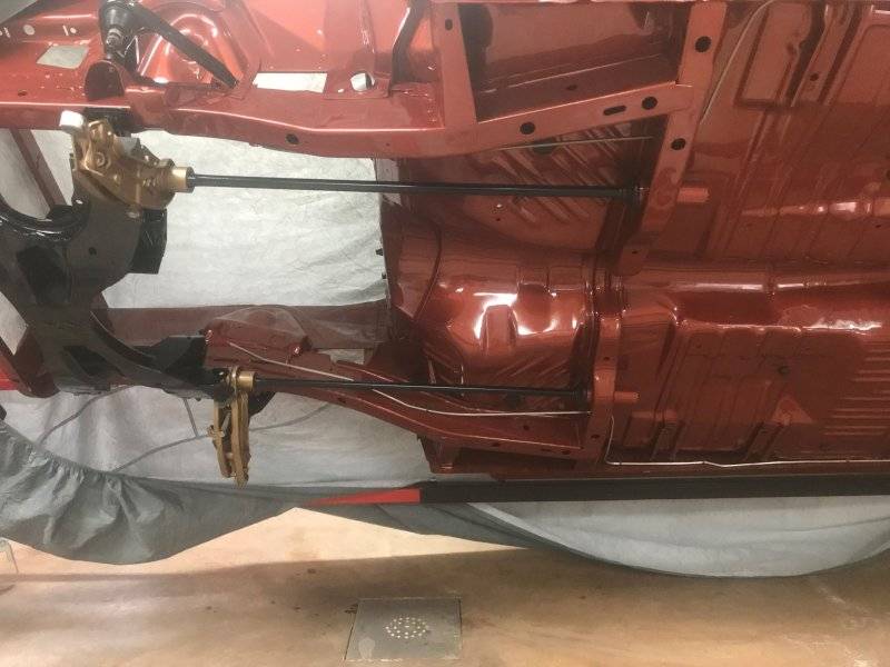

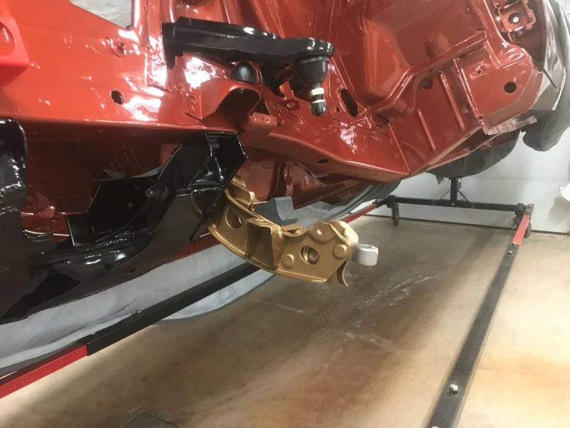

Woke up early after working all night. Decided to press in my LCA bushings and put the torsion bars in.

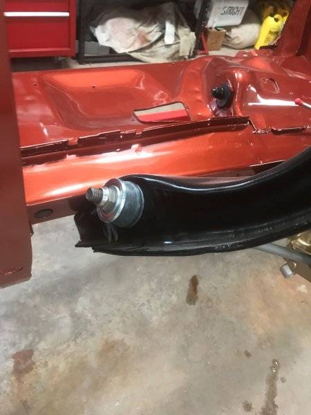

Took it all apart tonight for practice. Three times for fun. First time yesterday, forgot to put the strut rods in. Then put the "Improved" bushings in last night. Then took it apart again and put the standard bushing in tonight after supper. Didn't like the look of the newer style. A bit of friggen around but no better time.

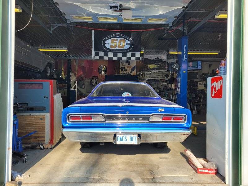

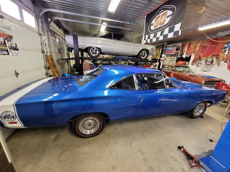

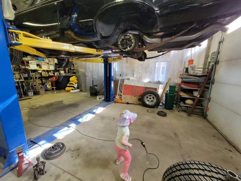

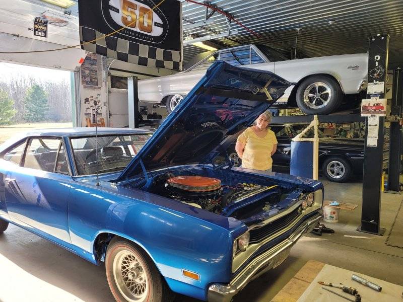

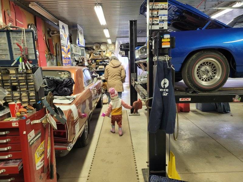

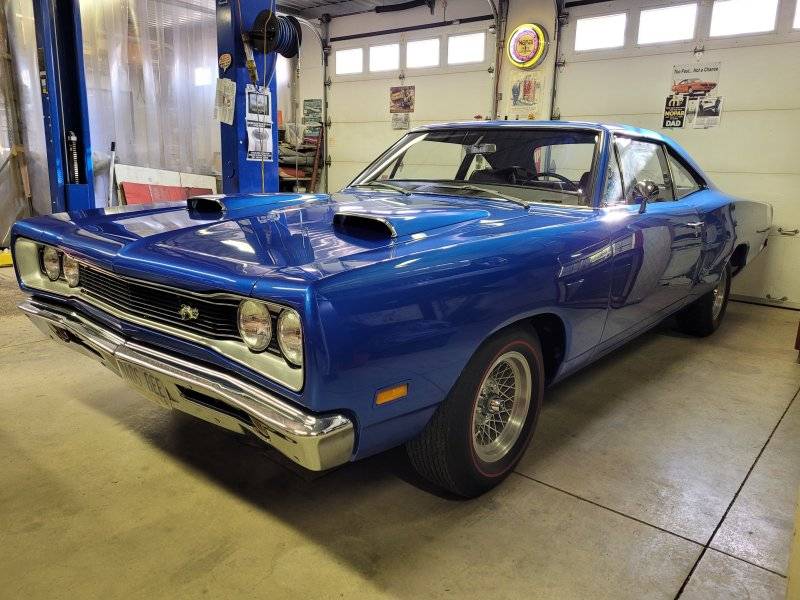

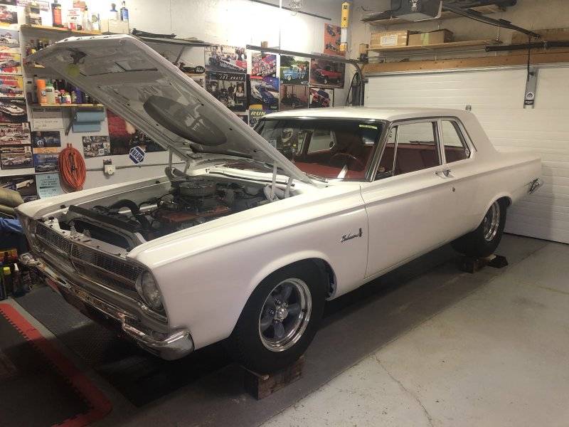

A week of 20C+ weather and I know the roads haven't been cleaned but she's going out! Gotta love a car that has sat all Winter and starts with 3 cranks and 2 taps of the pedal and then runs absolutely clean. Amazes me every time I start it, considering the engine was rebuilt by Bennett and Hanson in 1978 for about 300 bucks! Wife right into the shop, "should I lock the door and grab my purse"? What's not to love there?! Ready for a cruise tomorrow, we were already too far into the afternoon today.

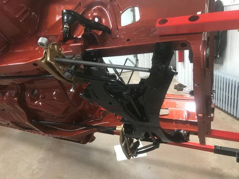

Little by little guys. Put the sway bar brackets, sway bar and end links on this afternoon. So be some spindle time!
Oh yeah had to rebalance the rotisserie today before I started adding more parts. It was getting kind of heavy to spin. To far out of balance. Wheel of fortune again! When you can let it sit in any position without the locks on, your golden!
