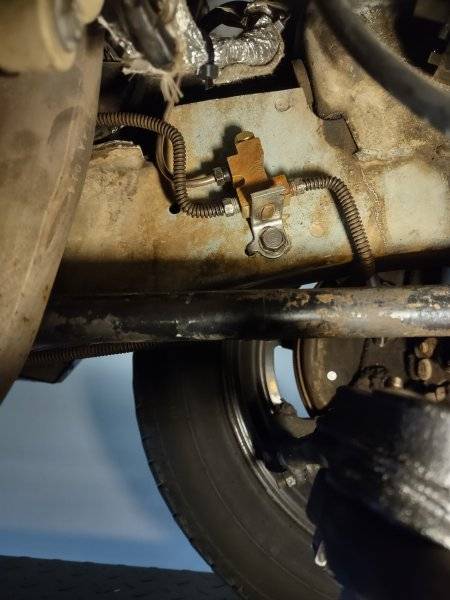

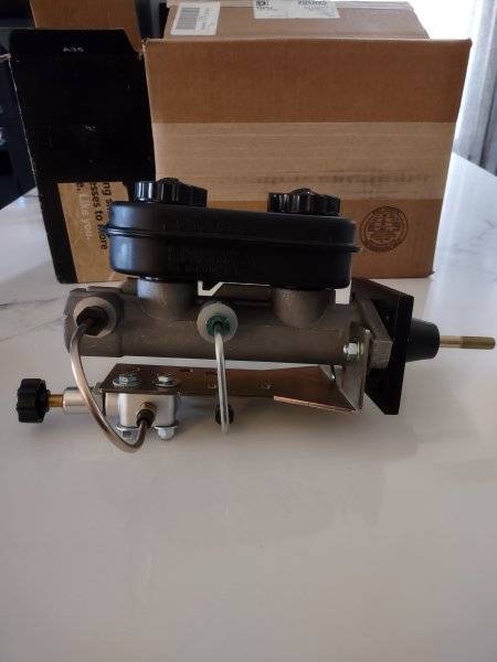

I mocked up the new master cylinder tonight. The rear brakes feed through an adjustable proportioning valve mounted under the master to the original rear line, and the front disc brakes feed directly into the factory distribution block with the original inlet from the single pot master plugged.

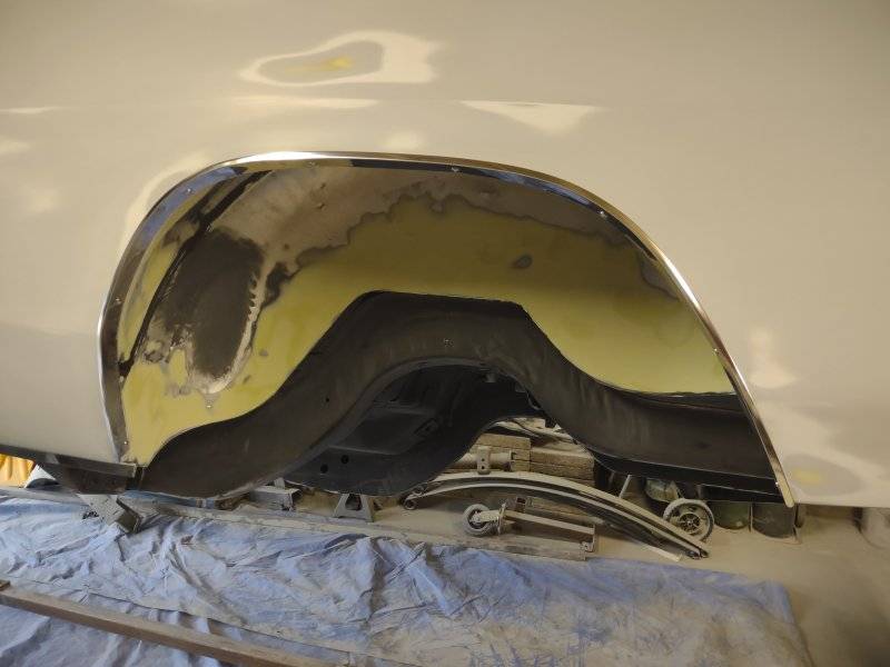

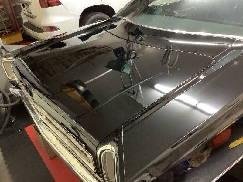

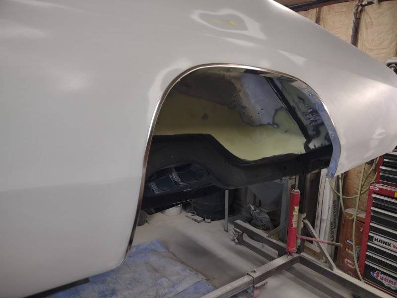

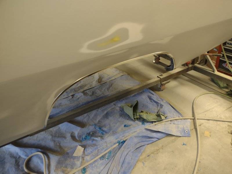

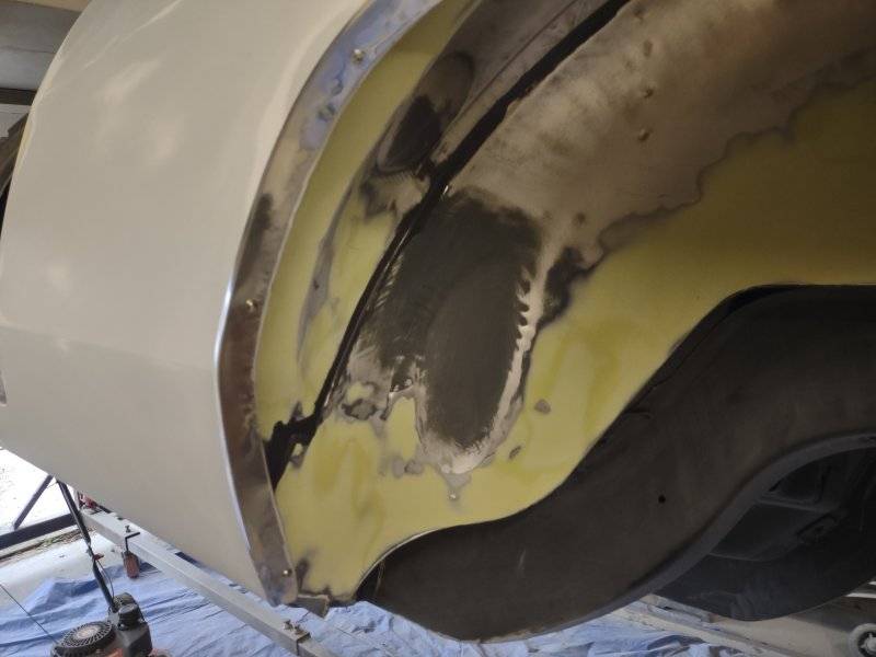

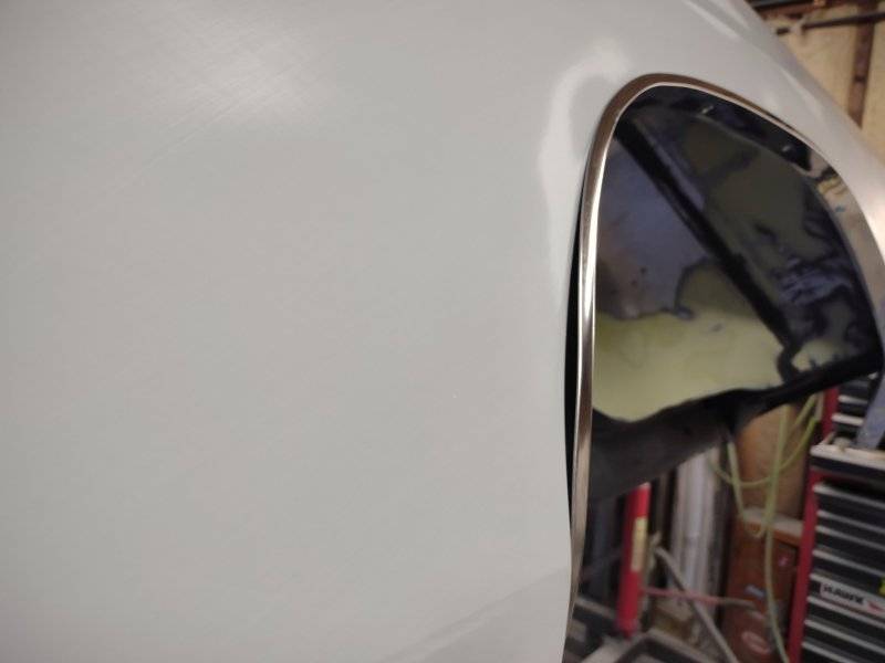

Started to fit the wheel well trim on the Charger. Originals were long gone, and the new ones fit like OJ's glove, so some light shrinker/stretcher work and we're in the ballpark.
Before:
After:
Do tell the technique you used to get that molding to fit.
I brought home the shrinker/stretcher from work. I just slowly bumped the areas around that needed it. The stuff is so thin that it doesn't take much effort to move. But basically you do a couple small light hits then check it, do a couple more, check it again and repeat however much until you get it laying how you want. I'll sand the areas that got marked up from the tool and polish it up.

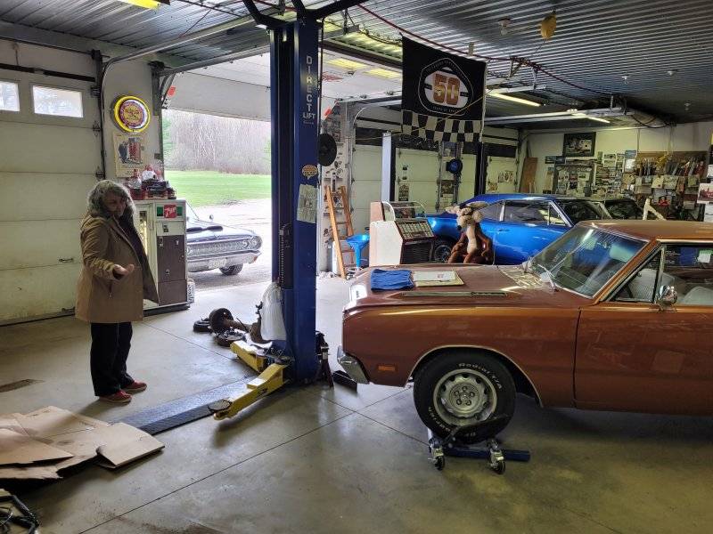

Well, not my Mopar, but i went back to one of our local Pick-N-Pull wrecking yards and pulled the lower control arms out of a 69 Dodge Dart that they put out in one of the Mopar rows at the beginning of the month.
Had to go back with the official torsion bar remover tool to clamp down on the bars to get them out, before getting the LCA's out.
The bars were kinda stuck, but with the tool, they came out pretty quick.
