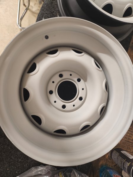

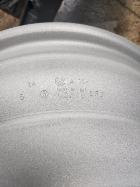

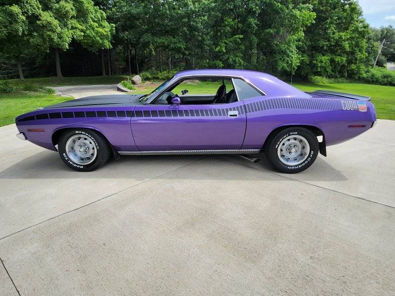

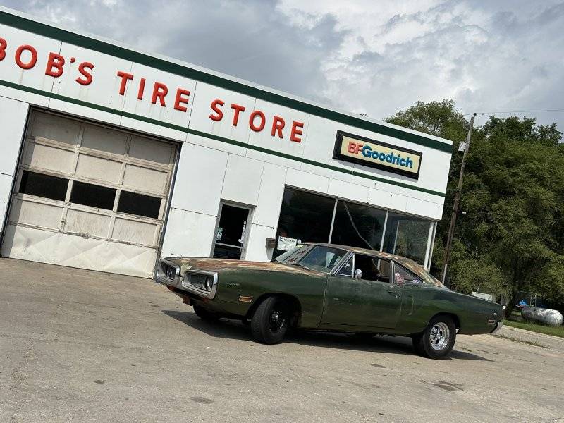

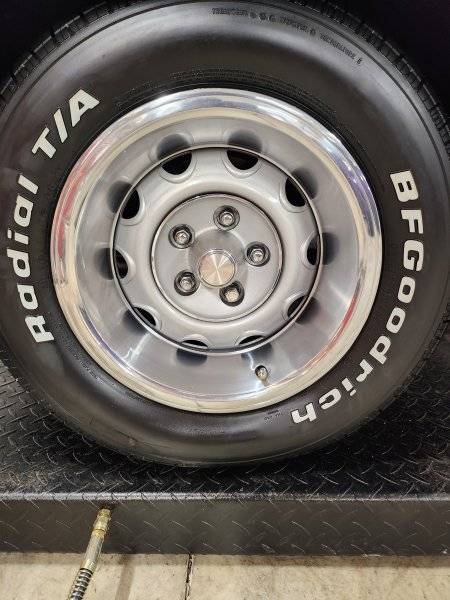

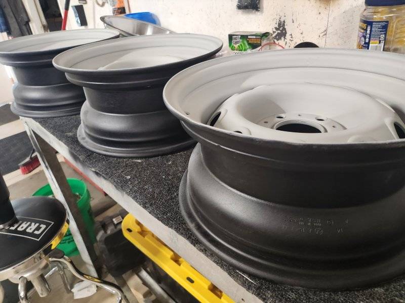

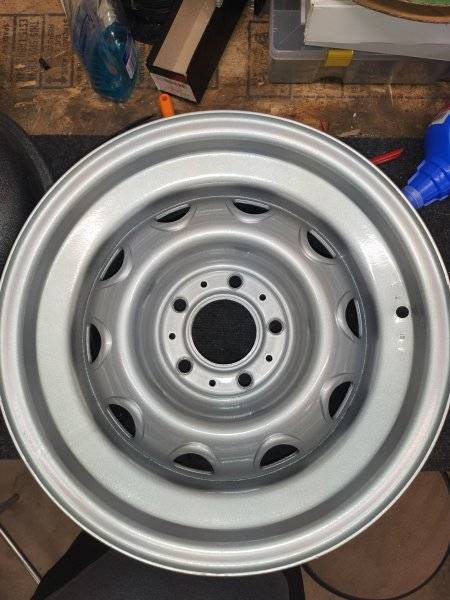

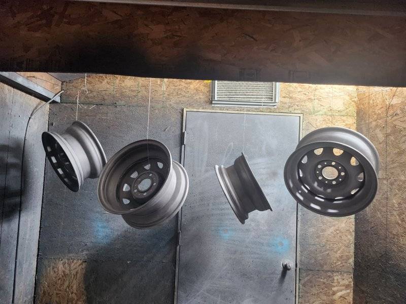

Got a new set of tires for the AAR. Ended up blasting the rims, hated to do it to originals but the rust was creeping out from the cracks. Sprayed them down with some afterblast to hopefully stop the rust from creeping again, Painted the backs and inside with some SEM black, then 2k primered the face sanded and shot 3 coat of oer argent silver. got them on the car shinned em up made a big difference

The wheels look great! Fantastic looking car!

Thank you. Has always been my dream car since I was a kid. Had the opportunity to buy it last august, jumped on it. It came in pieces but was pretty much all there. got it road worthy about a month ago and have racked up about 750 miles. plan on driving the hell out of it.

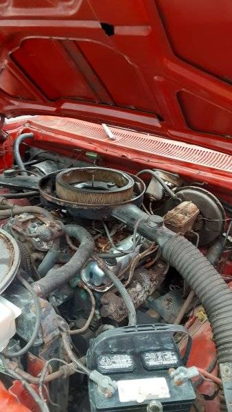

IT'S ALIVE! IT'S ALIVE! I put a battery in the Little Red Express truck and got it cranking over,then I put some gas in the carb and she fired right up! I ran it 3 or 4 times. So good to hear it run again! Great day!

That's what they are for! Congratulations on acquiring your dream car!

Love those trucks!

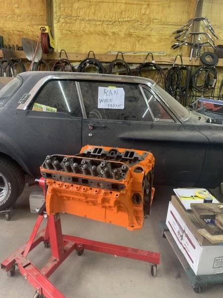

Returned to working on my project after a trip to Carlisle…Painted the 440 Block on my 62 Dart.

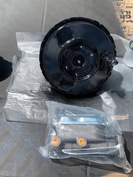

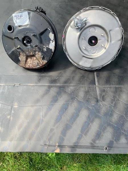

Took 4 weeks to finally get my new Brake Booster. It was a PITA getting the old one out, especially that upper right bolt under the dash. Sometimes I think Mopar found a Rube Goldberg design for the connections between the brake pedal and the booster arm:lol:. At least it only took 4 Corona's to get it out.
View attachment 1691093View attachment 1691094
Well......the new Booster became a POS. The seal broke on friday. Now I have to go thru more body contortions to remove it again. This one came from Federated Parts. Will not be getting anything from them anymore. This will probably take another 4-6 weeks to get one and so ends the car season for me this year. I might get September in for a cruise.:BangHead:

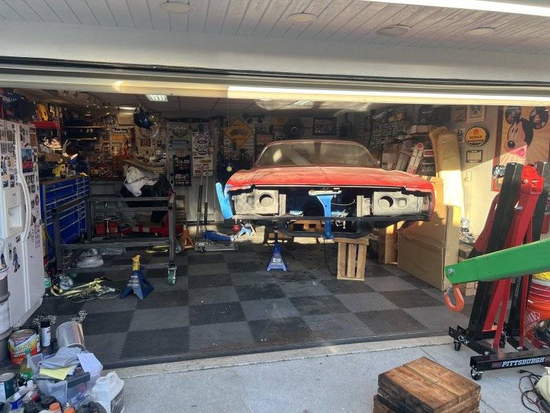

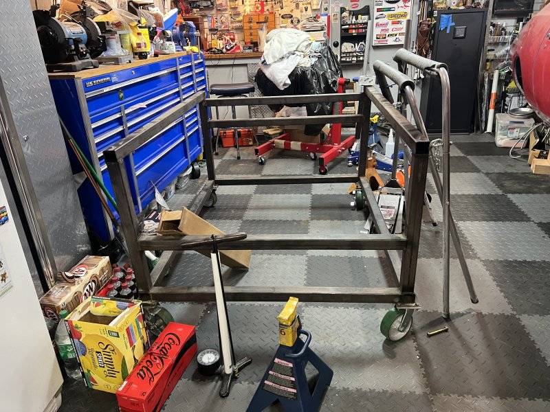

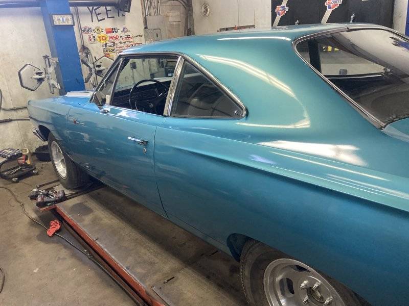

My son and I finally took the car off the rack that I built that wasn’t very helpful. It was brought down to four 6 ton jacks so that we can start to put the drivetrain. It was a somewhat scary job of floor jacks and an engine hoist raising it up and then getting the cart out, and then lowering it slowly on each side to get it on the jacks. Now, to sell or do something else with the rack and get back to restoring the car!!! Here’s to my son for helping along with a friend!!!!!
