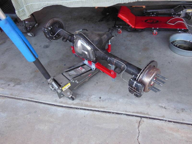

----fixing a couple of issues, pulled my dana 60 out today to correct pinion angle the right way, and ad sliders,,when u guys done this, did u bolt it all back in , no welding on new perches , use the u-bolts to hold it , and set pinion? rearend wont turn when full pressure of jack lifting it?View attachment 886871 View attachment 886872

thanks! i was planning on just resting it on the jack stands instead of tires, should be the same? my only concern was , i usually jack it up in the center and dont want the rearend to suddenly rotate while in the process, i guess torque them to a full 50 ft lbs and it should be o.k. the rear end cradle is only rated for 800 lbs, not the full weight of the back of the car.super stock springs with cal tracs bars.----
I set my pinion angle the way you have described except that I had the car sitting on it's tires at ride height. Once I had it set where I wanted it I tac welded the perches. I also centred the rear diff before the perches were tacked in place. My combo was with calverts / Caltracs and I set the PA @ 5 degrees negative. Make sure to box those perches.

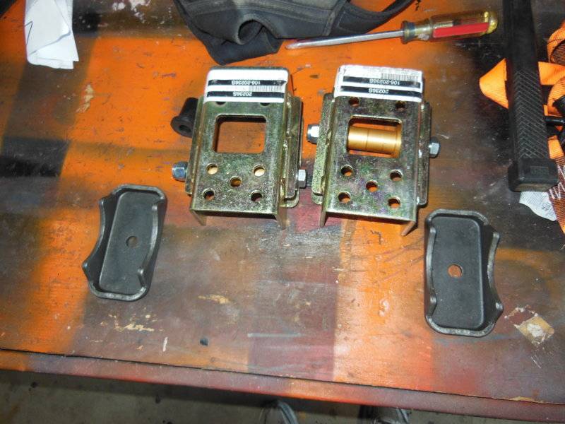

mine r from speedway,,they r the 1's with bearings..expensive little bastards! wanted more free travel from the springs. AND to correct most of the below std work that was done on the car from the previous owner..My question is why are you using sliders, did you consider the "angled slot" Calverts and why did you choose AFCO?
Why not the Calverts, and what about the angled slot in the Calvert? Opinion?from speedway,,they r the 1's with bearings..expensive little bastards!
went with what most everybody else here are using,,only reason,,car is not back up to race ready from the 70's yet, just correcting problems and installing upgraded componets where possible..thought about installing ladder bars which i have done in the past but too much trouble for what the car will be used for..calverts angled slot could be a gimmick to set them selves apart from all the rest? it should work o.k. as is..Why not the Calverts, and what about the angled slot in the Calvert? Opinion?

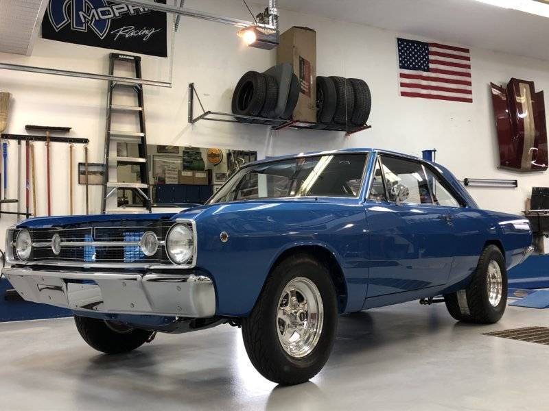

---Traffic job you have done on that dart a real show piece. What going to power that machine down the road.
Aar has been good to me. My parts have fit well and very little prep work needed. Did you do the lift off or hinged.B body is in storage and the A body has been getting all the attention.

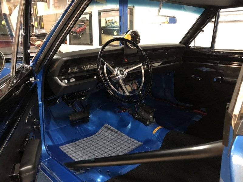

Exterior is pretty much finished, glass hood and hemi scoop ordered from AAR today.

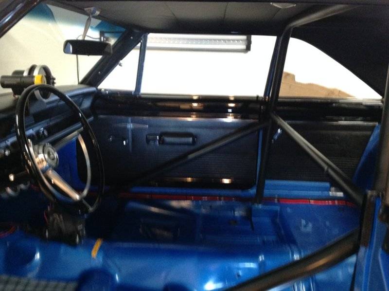

Glass in, adjusted, weather stripping all in and door panels on for good.View attachment 891360
Dash finished up. Everything tested and operational.
Rug and seats next up.
