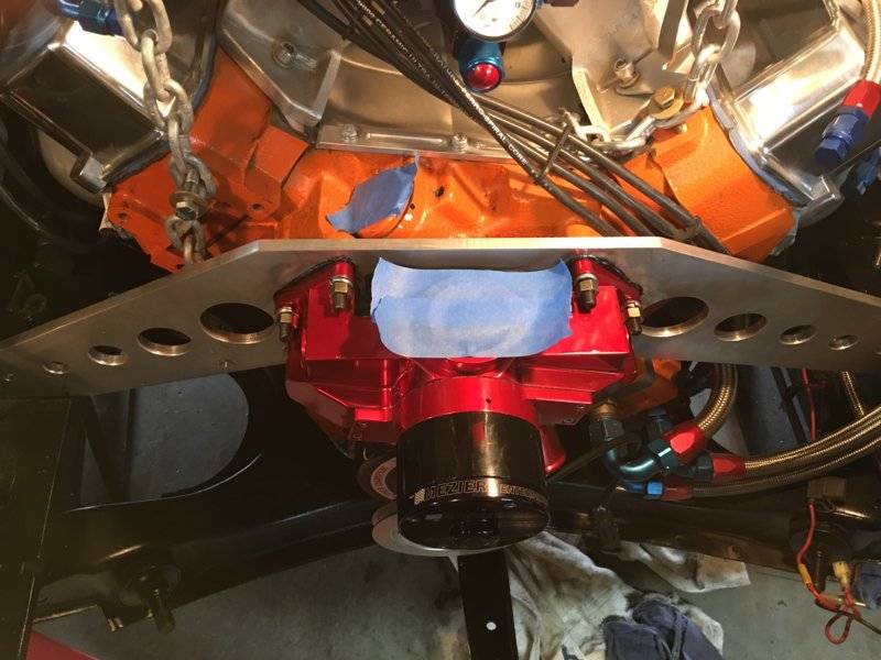

installed a meziere 55 gpm water pump with housing today,,managed to break the old water pump housing loose from the motor plate without breaking the seal to the block,,had to ream all 6 holes on the new pump housing though, for the money it could have fit better. final torque on the studs tomorrow after the silicone sets up over nite.
installed a meziere 55 gpm water pump with housing today,,managed to break the old water pump housing loose from the motor plate without breaking the seal to the block,,had to ream all 6 holes on the new pump housing though, for the money it could have fit better. final torque on the studs tomorrow after the silicone sets up over nite.View attachment 933376
That's a pretty good looking engine plate. Been lots of good work happening over there.

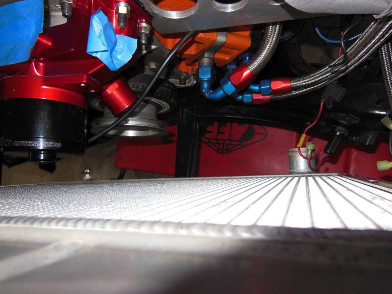

hemi-itus set me up with it thru vignogna performance, its heavy duty,,it looks like i will have to have some kind of custom lower radiator hose with this pump.:(
I think our pump housings should be or are likely the same. I was able to use the same lower hose as what I used on my aluminum mopar housing.
your lower hose outlet appears to be a differant angle then mine, those flexible hoses can solve alot of problems,,i think i can get it done with a 45 and 90 degree elbows with a spacer tube between them.
Yeah it does look a little different angle, but you'll find a hose to fit.

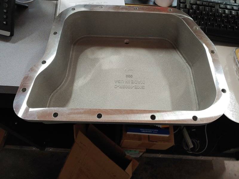

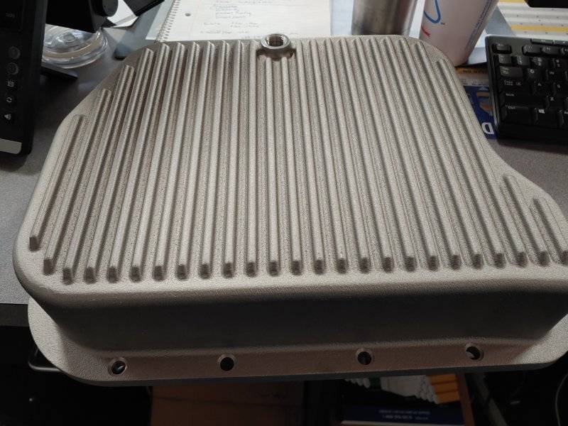

I installed a deep sump aluminum pan this weekend. I had been using the 518 truck pans. I figured the aluminum would add some strength and the flat pan mating surface eliminate nagging leaks. Very happy with the non-branded Trickflow piece that was made in USA! It even came with the filter extension!
