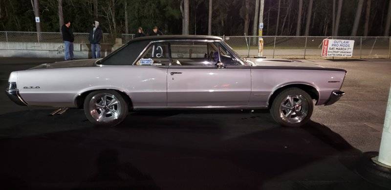

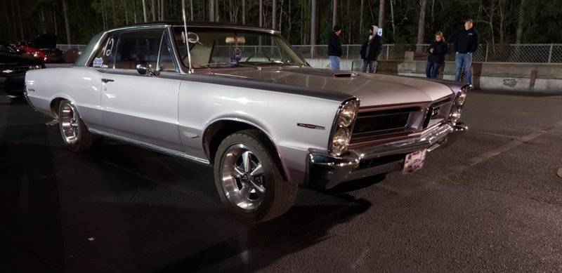

Well I am going to have to measure the diameter of the 17" wheel + tire on the GTO so I can calculate the RPMs w/the 3.80 in the QP rear axle assembly. The highway drive to and from the track had the 421 spinning up more than I'm comfortable with (but certainly within a safe range) in 4th with the Muncie transmission. BOY am I glad we got a deal on a TKO600 because it really needs that OD 5th gear!I'll post results once I make some runs Wednesday night.
I made 4 runs, and the best I could do was 13.58 @103. My 60ft were all 2.1 seconds, but I didn't have excessive wheelspin. Since the tachometer is in the not yet installed Dakota Digital gauges, the only thing I could go by was feel, sound, and the 5,800 RPM rev limiter, which I "brushed up against" in 2nd or 3rd (not both) on every run. I also don't know what RPMs I left at, but on the 1st run I had no spin at the launch, but on the 2nd I had a little but not really detrimental. The line lock w/2nd gear worked fine.
I haven't done any of the fine tuning available with the Pertronix distributor, but I did raise the advance. The vacuum advance I believe is too aggressive when the total timing is set w/vac advance disconnected, so I'm going to have to see if the total timing can be limited, which I believe it can.
I had a fun night, beat a Camaro, was door to door with a Mustang GT, and did the "no lift shift" in the GTO for the first time, and that has shaved about 3/10ths off the Roadrunner's 1320 times so I know that helps.
My dad managed a 12.8 in his 65 GTO back in 65, and he had a 389 Tripower with less performance mods and what had to be less power than our modded 421 Tripower, so there are probably a worthwhile amount of horses still untapped and I think I'll find them in the ignition system.
So I've still got 8/10ths to go to top the "old man", but the GTO is really becoming a contender.
