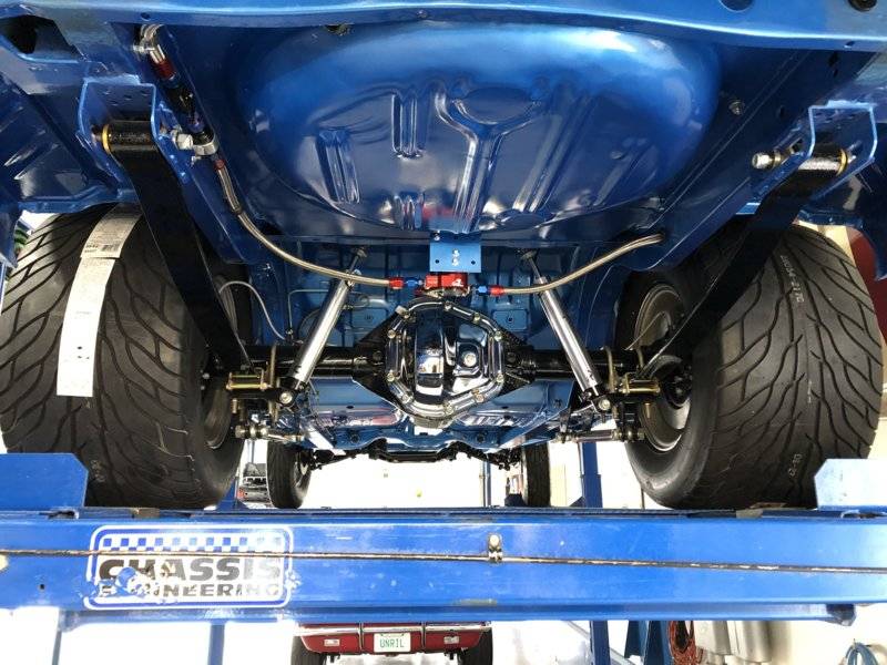

Got the bottom ready to epoxy prime. Mini Tubs, Springs relocated, frame connectors, front floor boards, rear spare tire tub, etc. Raised the tub 3" too so it doesnt hang down like a donut.

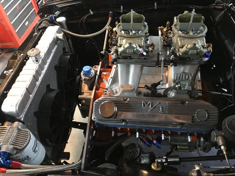

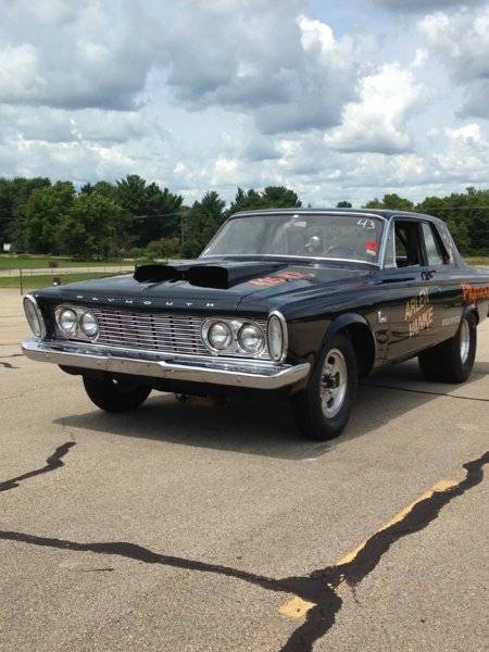

finally coming together,,,engine compartment painted,,bolted on the tunnel ram today,,waiting on 2 parts before starting it up,,,this motor is right out of the dick landy playbook from back in the day,,,440 block,max wedge rods and heads,440 crank,milodon oil system,solid roller
,etc,,i have a magazine around here somewhere showing all this play by play from him,,superstock 1968ish i think...will run around to the car shows until end of year when the upgraded motor will be built...

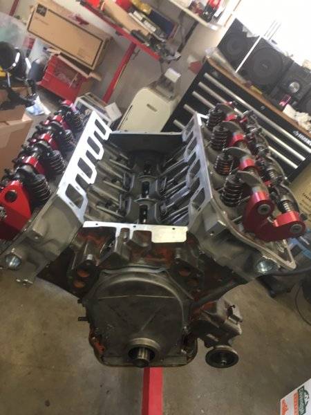

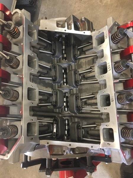

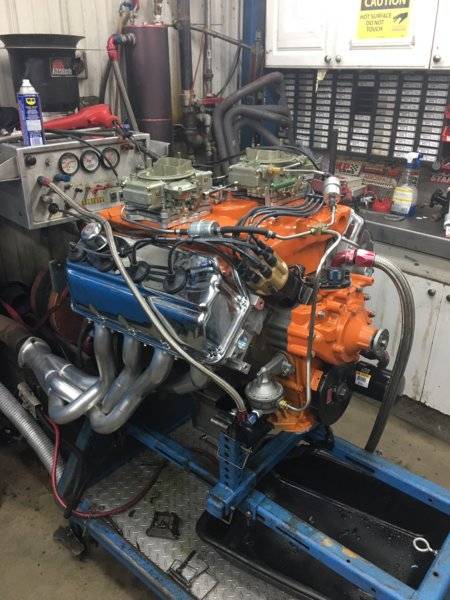

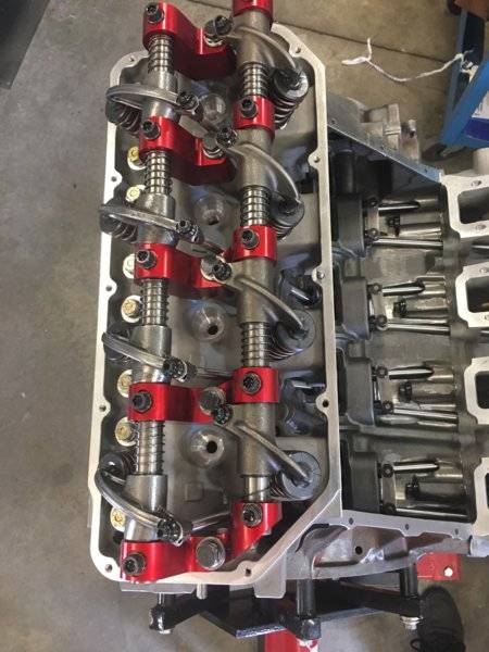

I know the offseason is over for everyone, but I am finally getting my motor back together. Started as a cam swap to a solid roller. During disassembly found a leaky cylinder with a missing ring. Windage tray was missing. Rear main seal appeared gooped up to try unsuccessfully to stop the leak. Valve guides worn and seals needed replacing. Off to the machine shop to hone the block and service the heads. New springs then installed. Needed new push rods for the roller. First set of push rods from Smith Bros ended up on the brown truck in SE Asia. Second set arrived and were assembled to length. Motor assembly almost complete and hopefully to the dyno tomorrow.
View attachment 778377 View attachment 778378 View attachment 778379
It's a good thing that you went deeper to find and correct those issues 65Hemi. It's a good job done now though. Good luck tomorrow on the dyno, will be waiting to hear how the day went and the numbers.

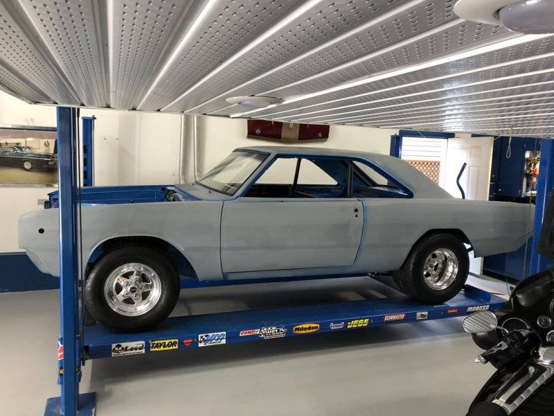

The Dart came home somewhere around the third week in September, I threw the ProStars on it. 4's and 12's.
Rear shot with the 29 X 15's. 3/4" inside tub space, outer sidewalls, protrude out past outer quarter 3/16". Perfect fit.

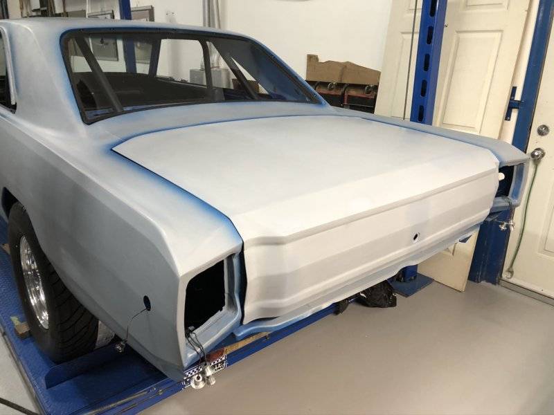

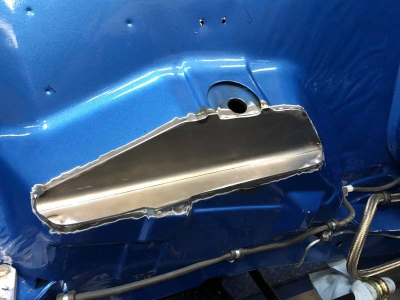

Dragged the old trunk lid in and spent a load of time on it. There was a full rear panel, got rid of that and ended up with a load of holes to weld up.
Bodywork done and fit.

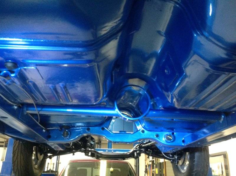

Underside finished.
Top side finished off the car. I'll be using RM2000 Clearcoat on the Dart, it lays out pretty good, this is 3 good coats.

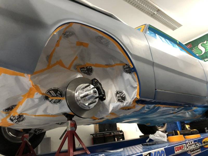

Dart is all taped up now. Monotonous bloody job! Getting real close for paint now. Body is wet sanded in 600 already. Next up - build a paint booth.

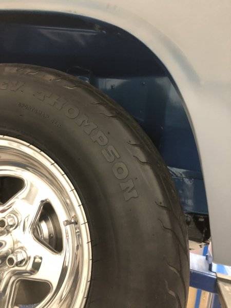

And, I also got the 28" tires to fit the Dart too. I cut a pie out at the front lip and shaped it ahead. No tires rub issues now, they were catching before.

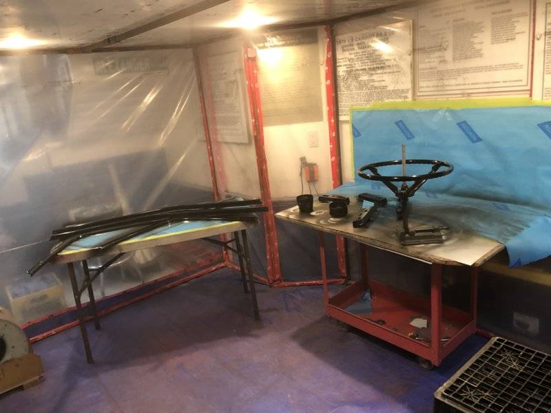

And, I have started assembling the poly paint booth! Gonna be a busy week ahead over here!

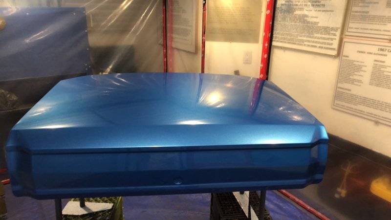

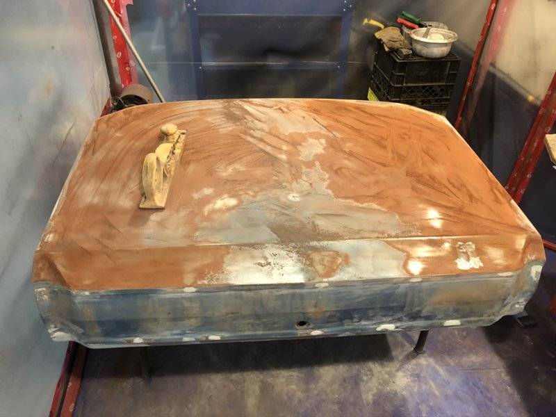

Drop this stuff off to the machine shop said it will be done in 4 months

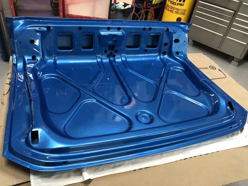

Located a better back glass and a nicer trunk lid. Gonna have the lid media blasted inside and out and get it in epoxy. New drag radials for next season and a new engine wiring harness as well. I need to drop the trans and do a front pump seal, check internals and probably do an aluminum pan while I'm at it.
