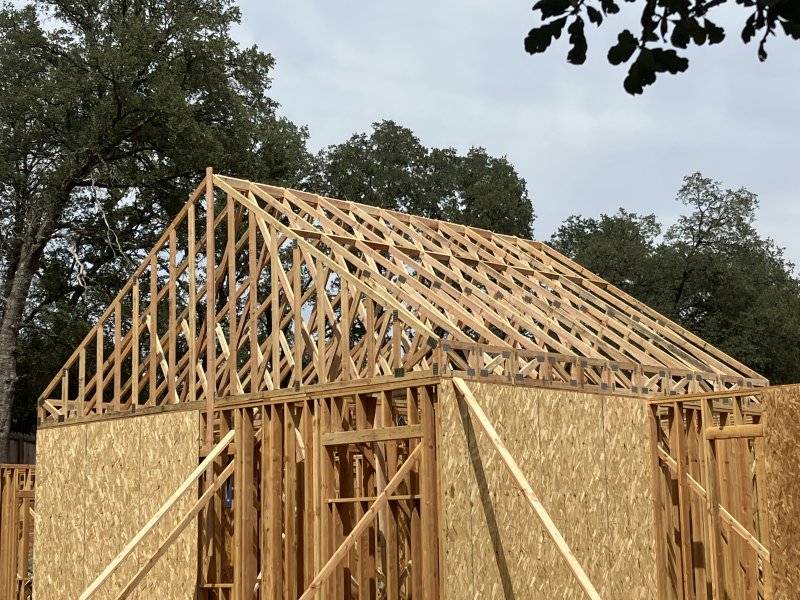

In the early 2000s, we worked a job where the roofs were an 8 in 12 slope. That is 33 degrees like seen in this photo:
This is an uncomfortable slope to work on so I always put 2 x 4 cleats down to give me a ledge to feel safer. OSHA would have me tied off to a rope or cable mounted at the ridge/peak. The harness is intrusive and cumbersome. It makes me sweat and feel angry. Wearing a harness in cold weather is still a pisser but nowhere near as bad. If one can't nail cleats to the roof sheeting, the options are the harness or scaffolding below the work area.

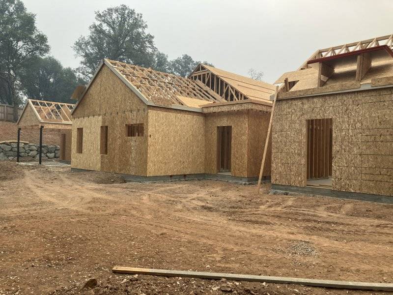

Back when my old company was still building houses, there was huge resistance to the harnesses. They invested in some bolt on scaffolding that was a godsend! This attaches to the top plates of the wall frame and rests against the outsides of the walls. It allows 2 planks to be used so it was plenty wide enough. We could frame the roof, sheet and nail it then remove the scaffold for use in the next house. Other jobs we worked employed full height scaffold that started at the ground and ran the full height of the building.
Here is the rub though....
Once you get used to the scaffold, you can lose some of your guts-balls-nerve for walking on roofs without it. You get accustomed to the "training wheels" and either relearn how to be comfortable with it or wear a harness.
