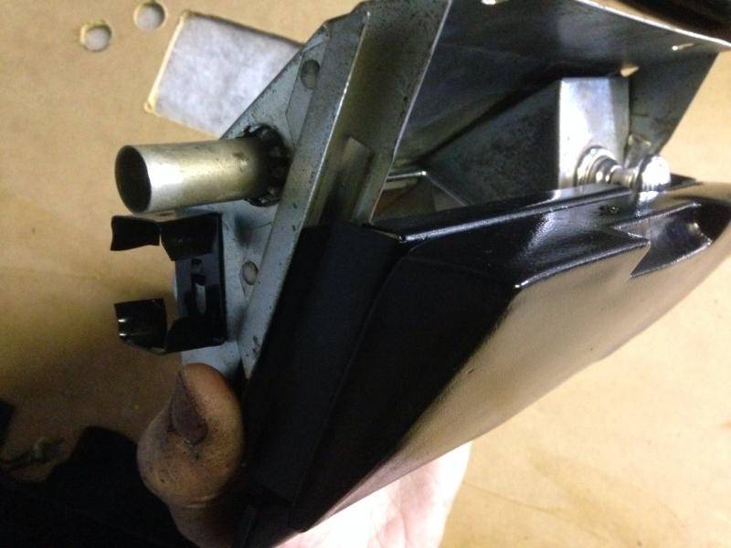

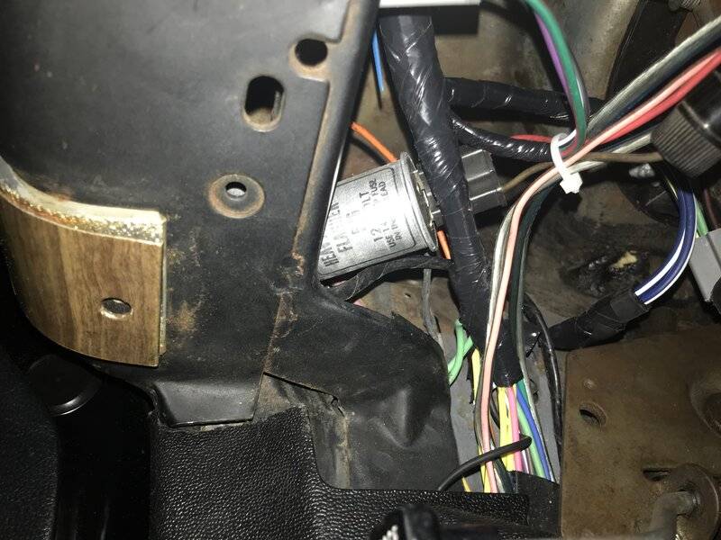

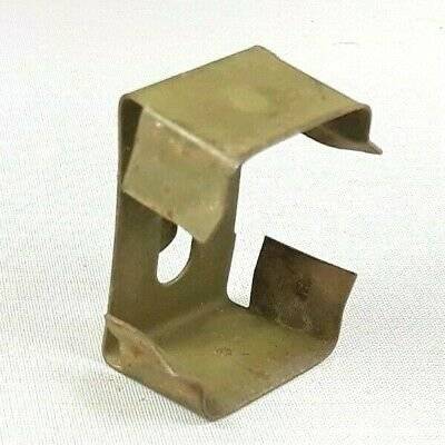

hazzards flasher is around brake pedal area, turning signals is attached to the ashtray housing... If everything is correct both are attached ( to brake pedal brackets and ashtray housing ) with this clip
like this
usually serviceable without pull anything out but just the flasher itself from the clip, then reinstall the replacement on same location just clipping it on
