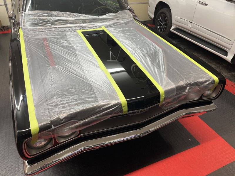

Next, I’m going to try some paint correction. Other than a couple small areas the GTX has never been cut and buffed. I’ll try a couple areas with minor blemishes, if it works out I might work on some larger areas.

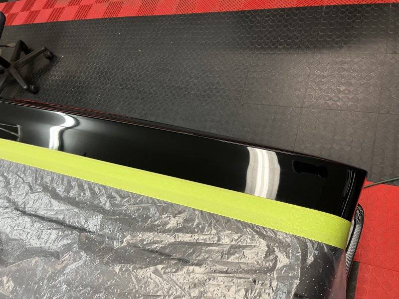

I’m using Chemical Guys products. Clean Start to remove old wax. Clay bar with Clay Luber. C4 with the orange pad first. It gets rid of the holograms in unsanded paint and polished out the areas that I sanded with 2000 grit. After the C4 I switched to P4 for gloss and fine swirls. The last step is a coat of Mirror Finish sealer applied with a black finishing pad. After each step the areas were wiped off with a clean microfiber towel.
Like I said earlier, most of the car has never been cut and buffed. The paint is almost 25 years old, so I needed to address normal swirls and minor scratches that accumulated over the past 22 years of regular use. I did sand the top of the drivers door and the top of both front fenders. The center of the hood was buffed without sanding. I think it turned out pretty good!
Once the whole car is polished it will get a coat or two of Collinite 845 which is the best wax I’ve ever found for black paint.

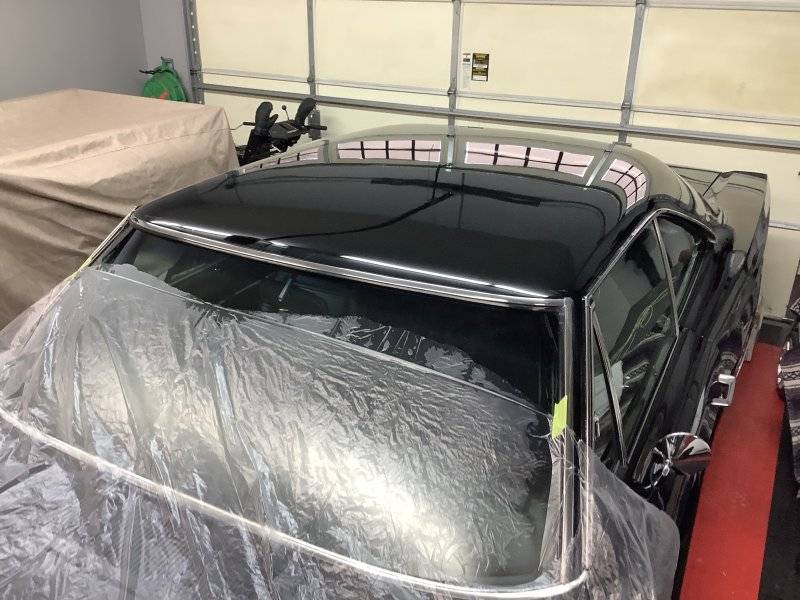

Getting ready to polish the roof and b pillars. It’s been washed well with clean slate, clay bared and washed with clean slate again. First round will be correction compound.
