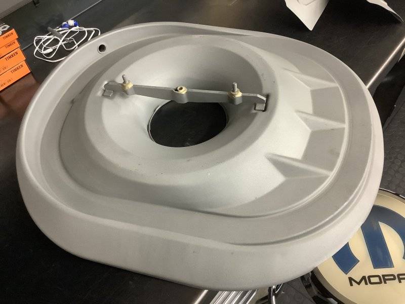

What they use? Glass beads? Zoomed in a little, might be a little more aggressive than the beads.
No blast cabinet?
No blast cabinet?
Can’t say for sure but I was told fine Garnet media, it put very little texture on the surface.

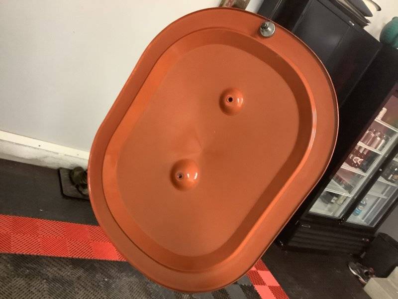

The Air Grabber lid had a bunch of dust specks because I laid it flat when I painted it. I lightly sanded it with 1000 grit and gave it a couple more coats with the lid hanging vertically.
I had previously painted the underside of the lid with Street HEMI Orange and painted the top side with air cleaner orange. Here are pictures of both sides for comparison. There’s quite a difference…
Yes Just a little!
Looking great Mark!
Yes, pictures of the paint cans leave nothing to the imagination/
