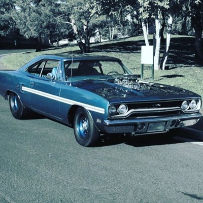

Yep using their relocation kit, we are fabricating the tubs and the rest. Gary did this car in the past
ED63DB30-9723-4BE6-AA63-FD02E399D379.jpeg 6FA698F0-D97F-45E3-A420-4D284374111B.jpeg
You need to ditch the scoop! Been thinking about a blower set up for the
Dart myself. Interested to see how your project goes.
Have another hood to use. This project will take some time, but i'll keep you posted.

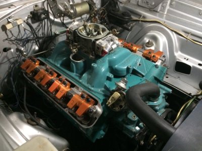

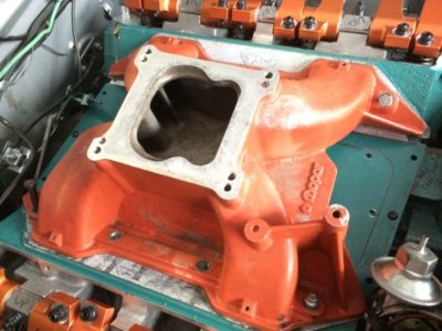

Went from Eddy RPM heads on my 505 to -1 325 cnc. After i took .030 off both sides of the AndyF billet valley plate, I dbl checked that there was enough space with the new heads so they wouldnt ride on the plate.
All good there.....but the crossover on the underside of my Indy 2D intake hit's the valley plate.
So I either need to cut the crossover off or find another intake....
No MW heads have the heat x-over afaik....... just cut it off.
The new intakes don’t have it anymore.

Givin the 3,900 pound weight and 3.54 gear....i'm not sure on intake choice.
Pump gas, .600 inch...260/268@50 flat tappet cam....my M1 and 2D both have std port while my -1 heads are max wedge size.
With the 8" convertor the car flashes to 5,000 off the line. I got 11.0's with the M1 and about the same with the 2D.
Wondering if the M1 would be better with the -1 cnc heads.?
I figured it was a given that when you put the -1 heads on that you opened the 2D up to MW size.
I don’t see the point in running MW sized heads with a std sized manifold on them.
IMO there are two suitable intake choices for you...... the 2D at MW size, or the 337.
