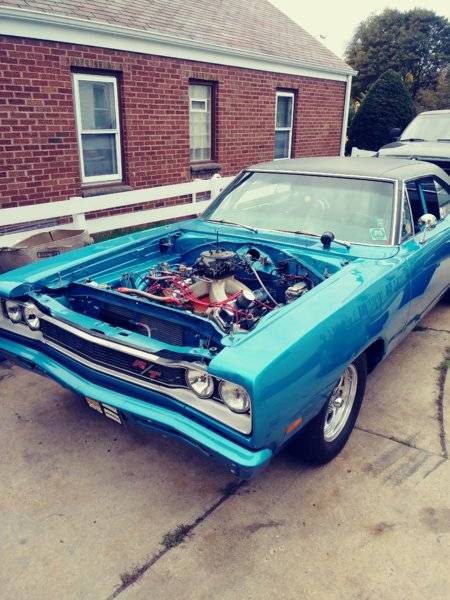

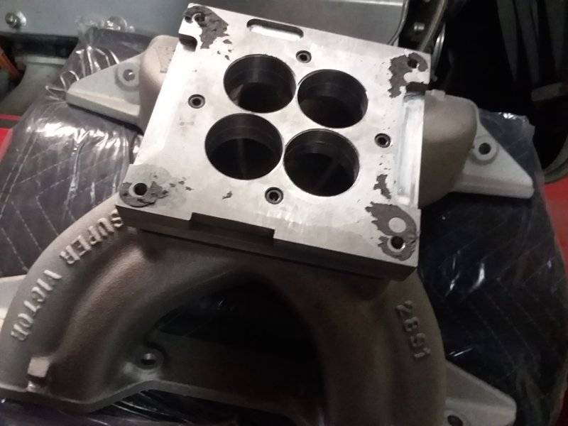

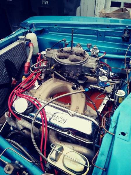

@67Coronet440, I can answer that, cause I have the same manifold. It's a max wedge port, dominator flange super victor.
I made an adaptor to be able to use my trusted 850dp until I can get a dominator to dial in.
I did some research, now edelbrock says it's for standard or max wedge port. That is the intake edelbrock says works with their max wedge port victors .

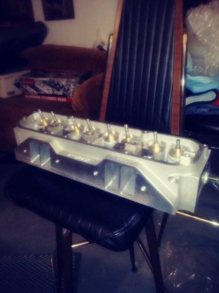

They sure aren't as big as my old iron max heads.

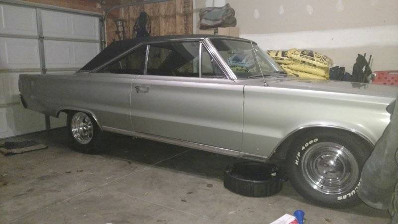

some body decided they wanted pro stock size tires on there b body...its been back halfed with leaf springs,and i added cal-tracs bars,dana 60 was custom sized to the wells...which measure 20 inches..and the 4.56 gears offset the large tires.it had 5.13's..at 65 mph , its taching 3100 rpm's going down the freeway..it scares the prious drivers when i blow by them at 75 down the freeway,,,has a vibration though at around 65+ and up mph?
I don't think you want 5 - 7 degrees down for Cal Tracs. If I remember correctly, it's more like 1 - 3 degrees down.

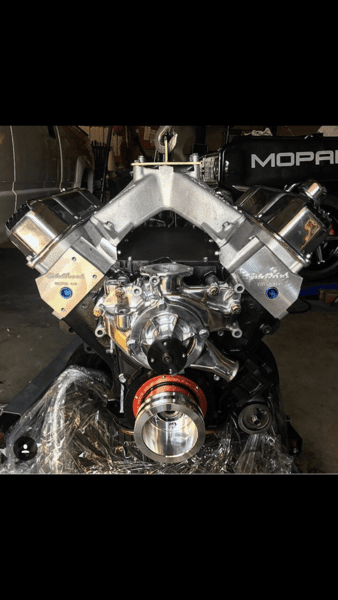

What is everyone using for a harmonic balancer for street strip build
I was looking into it last night and it says the 2893 is for the old iron MW heads.
Bryand
thats where i am now at 3 1/2 down,,should i just run the cal-tracs tight to avoid any chance of nose up? cars smooth until about 65 then it starts..
We want the trans and pinion C/L to be parallel under power. The rear axle rotates upward at the nose under acceleration. This is the reason we add extra pinion angle. Leaf springs move the most. Adding traction bars, Cal Tracks, etc limits this movement. Ladder bars limit it even more, 4 links more yet. It's very possible that the trans is angled down at the rear. In some cases if the trans angle is enough, the pinion could actually point upwards in relation to the ground. Remember parallel pinion/trans. Then add what ever extra angle your suspension type requires. read more here;
