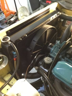

After sitting on my arse since last season, I finally got busy with some work on Lemonwedge. Ordered and received a pretty good slug of parts from Summit, and got busy in the shop this past weekend.
I’m tossing the belt driven accessories in favor of an electric water pump & fan with a new shroud. I’ll also be doing front brakes, as last year I began to notice this big sled wasn’t stopping so well. I’m also going to drag the stock radio out from under the dash and install the factory delete plate I got on ebay a while back.
No big projects, but this is how I’ve done it for a few years.... small steps eventually start to show up on the time slip.
The car should be more consistent as I’ll be able to control the temp much better. It should also be a little faster without the drag of the static 7 blade fan.......
View attachment 911165 View attachment 911166 View attachment 911167 View attachment 911168
