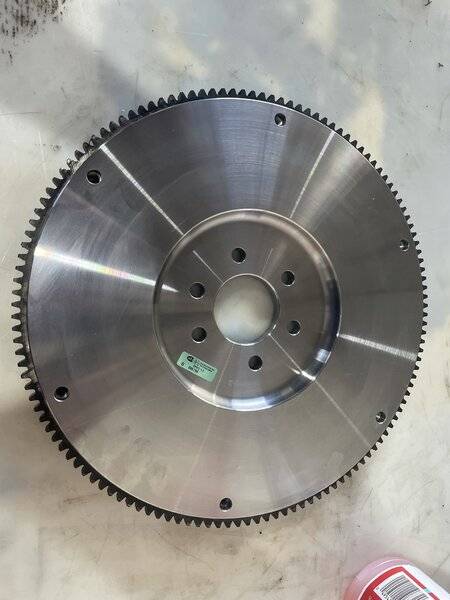

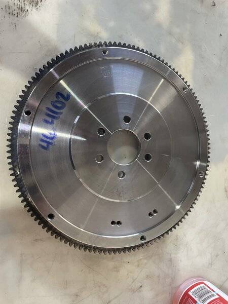

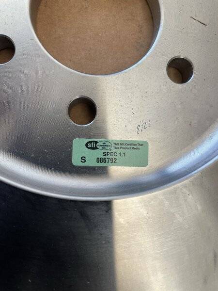

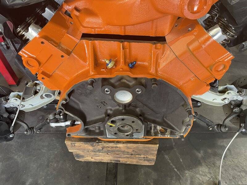

Finall Decided on a flywheel, went with the McLoed 130 tooth 27lb. Waiting on the ARP bolts to install it. I thinking on using a center force clutch disc and pressure plate. Any recommendations on a parts number? I'm guessing my motors going to be around 650hp.

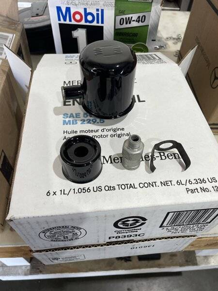

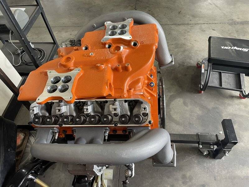

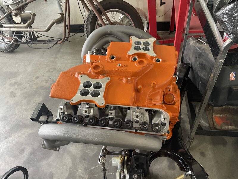

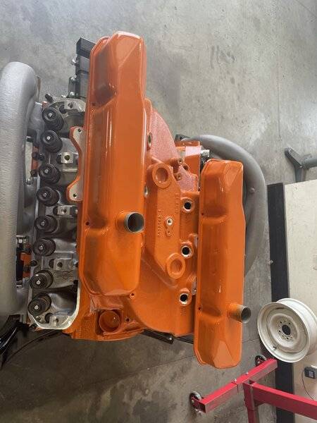

Picked up a pair of 6 bolt max wedge valve covers from a 64 from a nice guy in San Diego. Had the the push on oil cap breather but missing the smaller one with the pcv valve. Also they where race hemi orange but had ramcharger 426 decals so I sent them out to be stripped and I will repaint them and put a super stock 426 stick on them because mine is a Plymouth, Ramcharger was in a Dodge. I'm have the oil filler breather cap powder coated black. The smaller pcv valve one I found on eBay and from Kramer. I'll post picks when they come in. Hung the manifolds on just to see how they look.

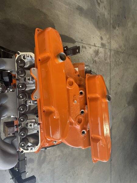

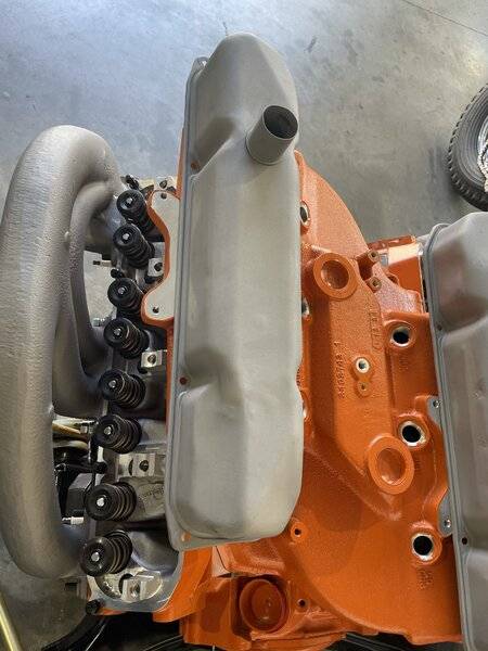

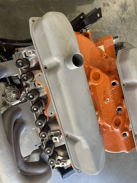

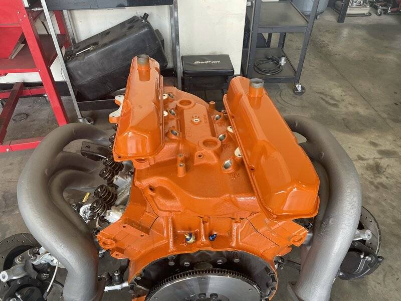

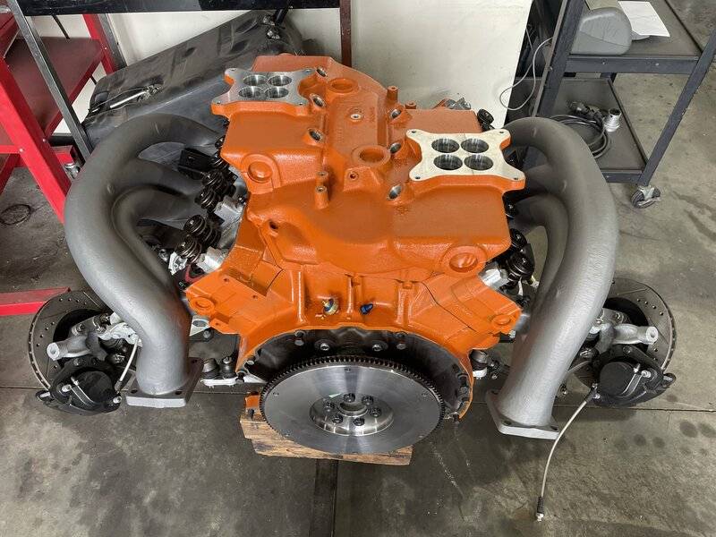

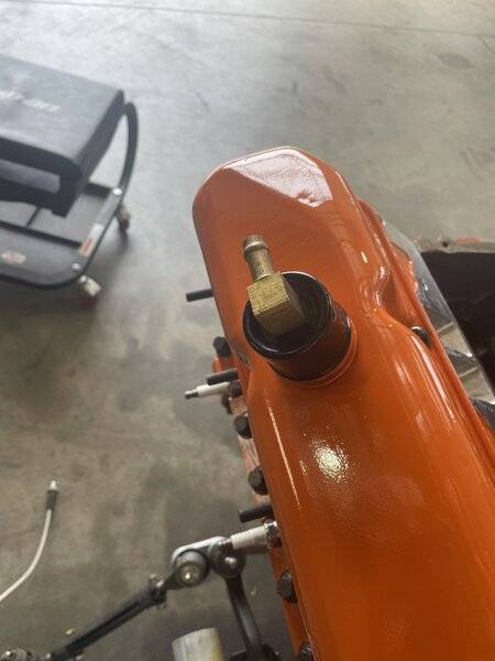

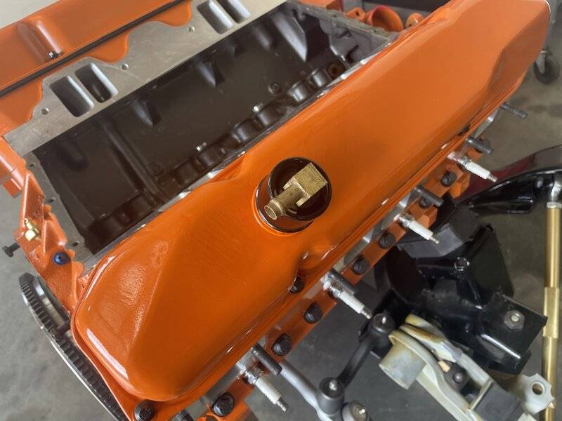

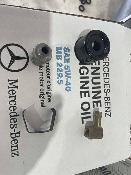

Got the valve covers back from being powder blasted to remove the old paint. Also had the oil breather and pcv valve holder powder coated black. Primered and painted the valve cover Hemi Racing Orange
IMG_1875.jpg IMG_1876.jpg IMG_1877.jpg IMG_1878.jpg IMG_1879.jpg IMG_1880.jpg IMG_1881.jpg IMG_1882.jpg

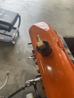

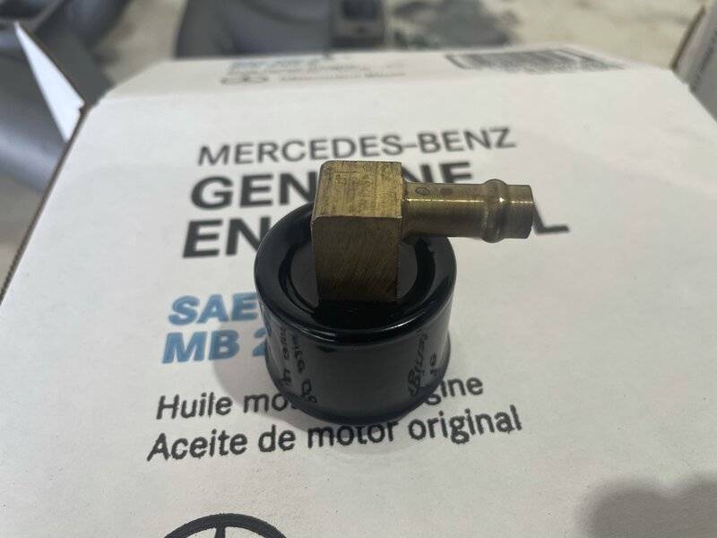

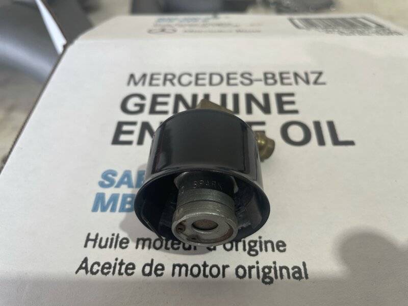

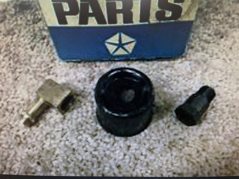

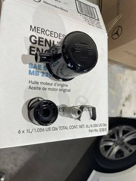

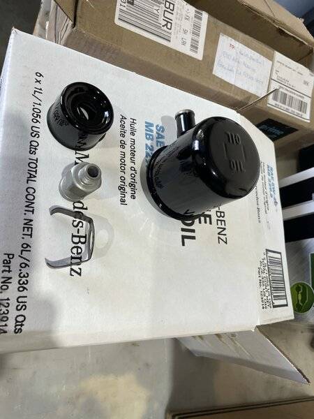

Kramer had the brass elbow for the pcv valve. This was hard to find but I wanted the max wedge version one and not the hemi one. I'm pleased I was able to find everything to put it together
