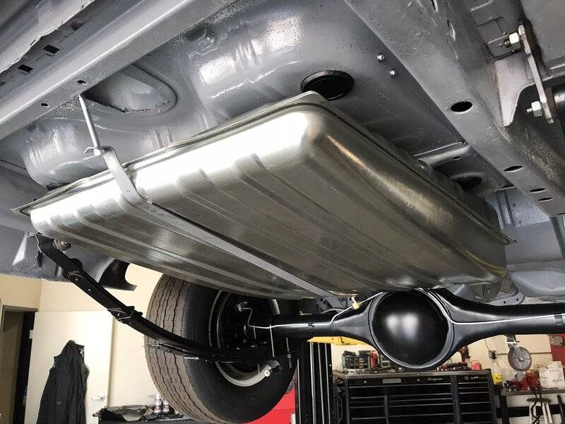

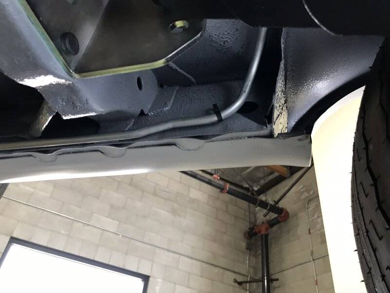

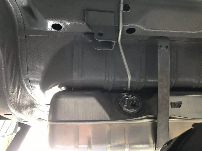

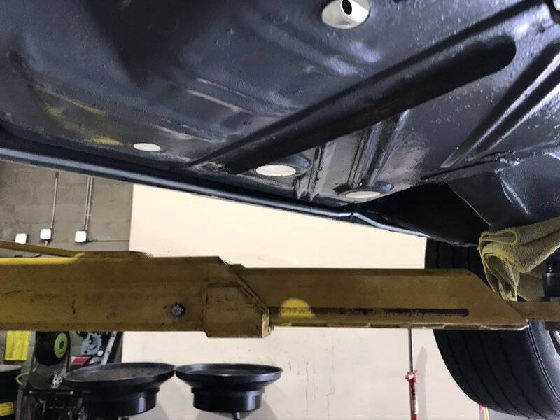

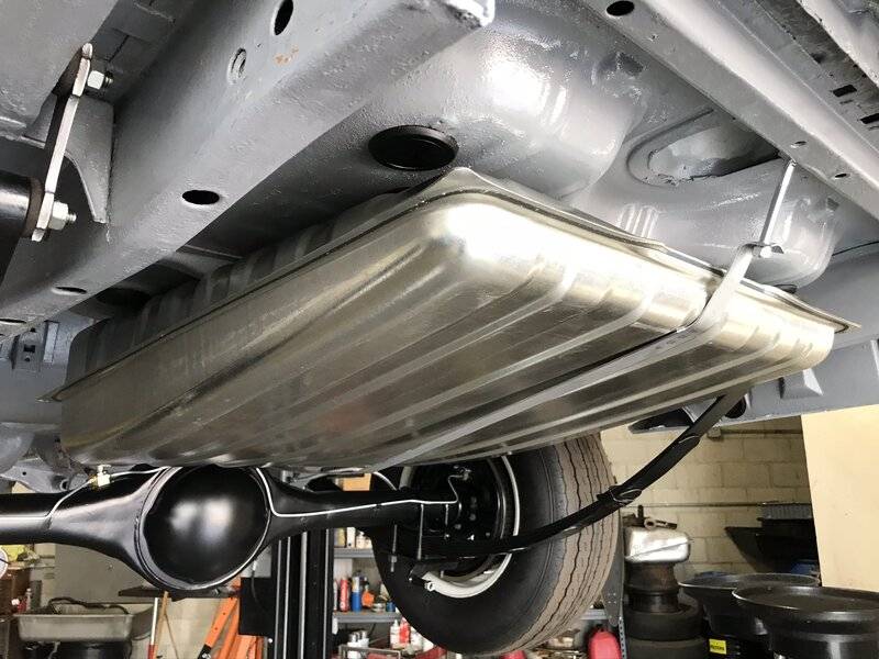

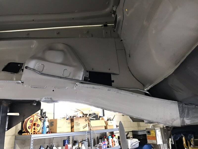

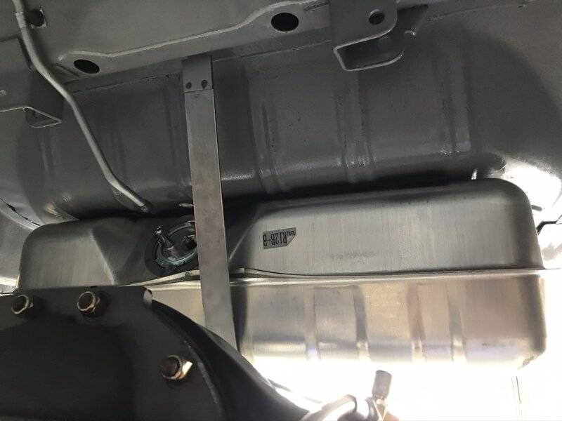

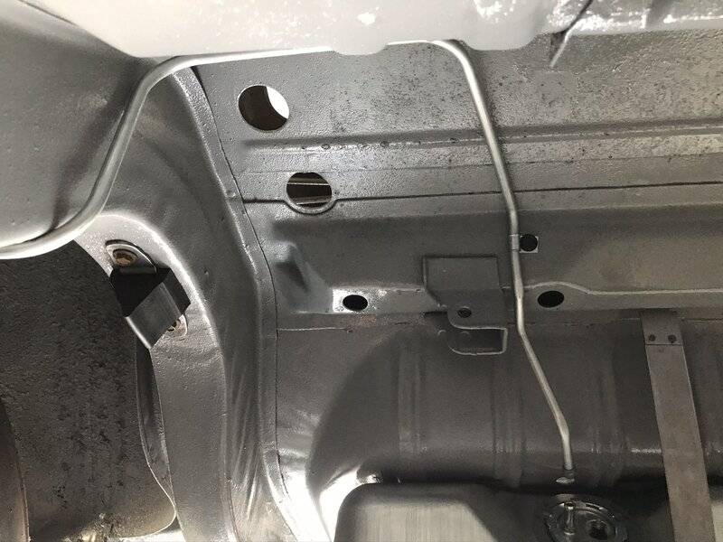

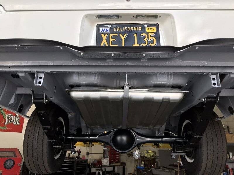

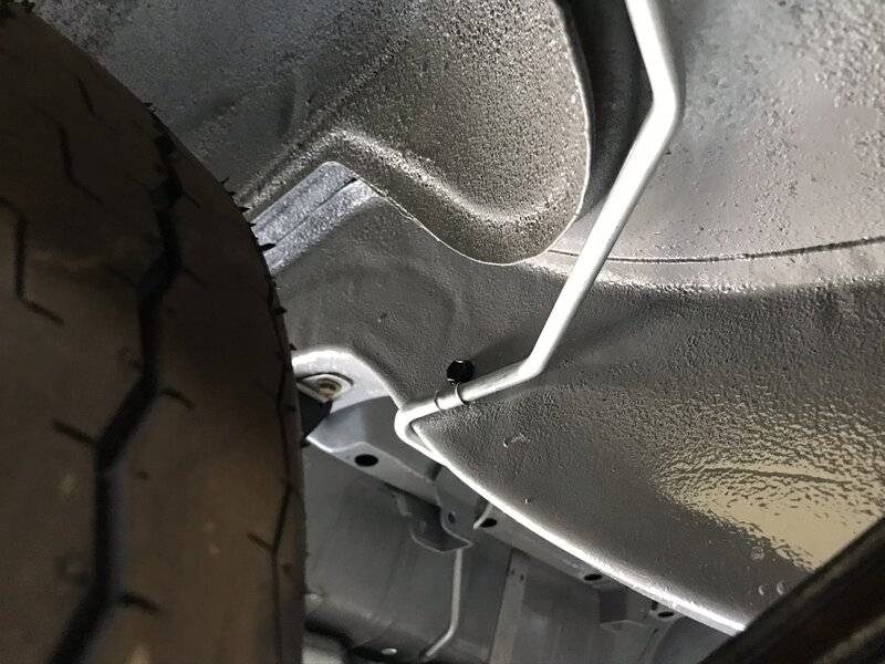

Did you install a insulation pad to the top of the gas tank?Installed gas tank and main fuel line upgrade from 6 cyl. To V8 size
View attachment 1046627 View attachment 1046628 View attachment 1046629 View attachment 1046630 View attachment 1046631 View attachment 1046632 View attachment 1046633 View attachment 1046634 View attachment 1046635 View attachment 1046637
Yes, I don’t know if the original max wedge did but I did put one on mine.Did you install a insulation pad to the top of the gas tank?

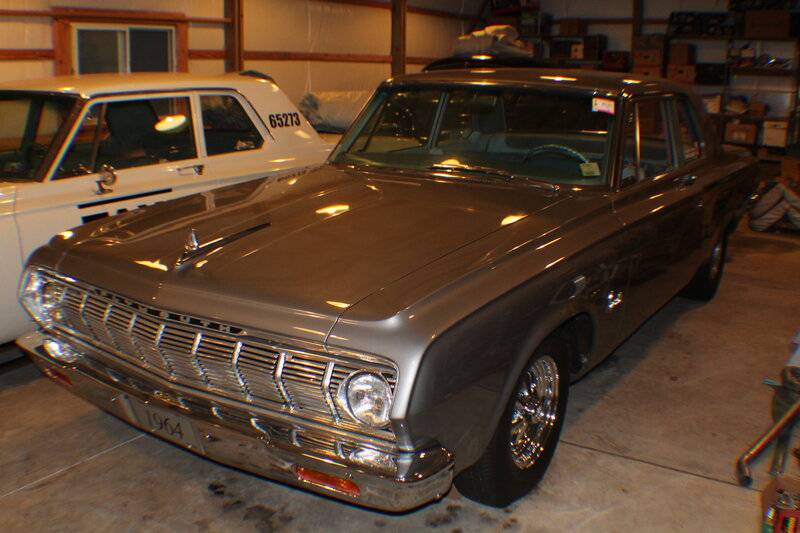

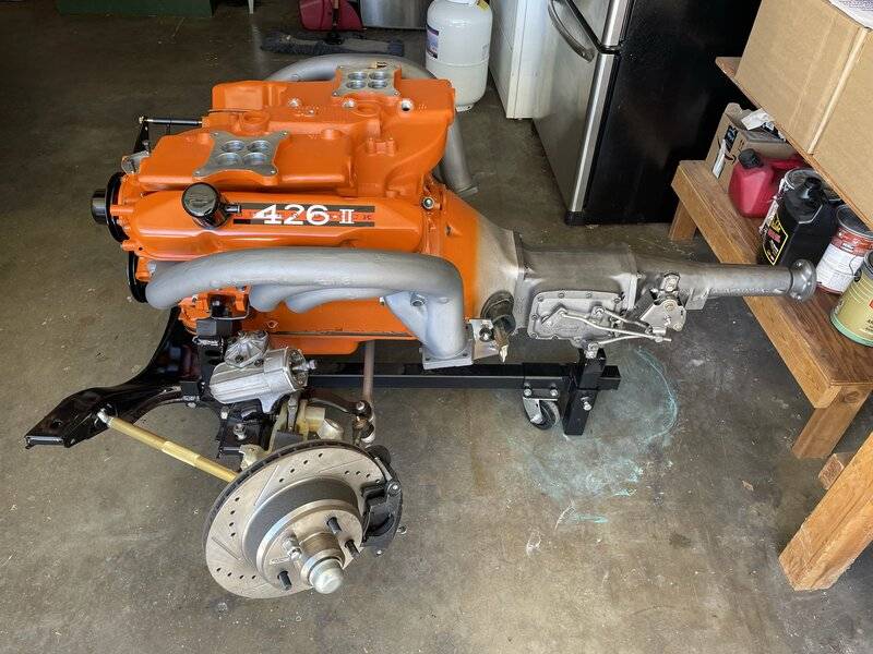

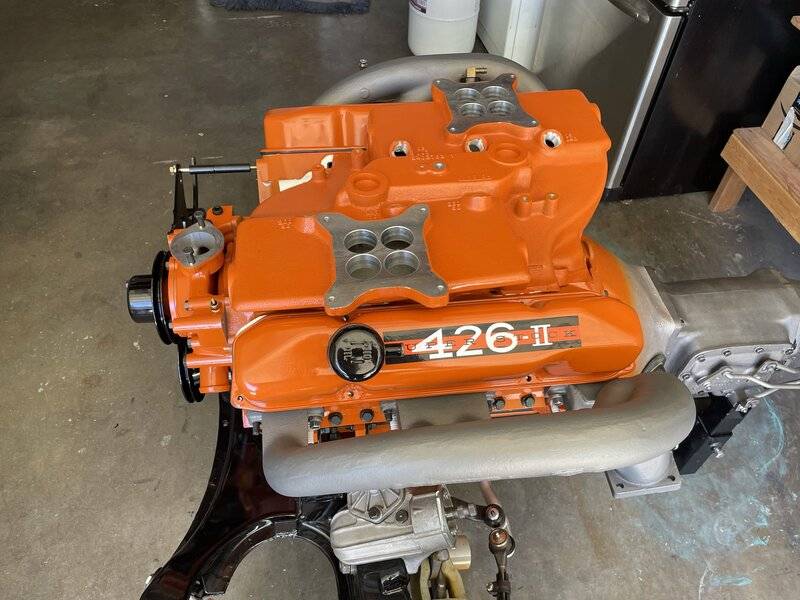

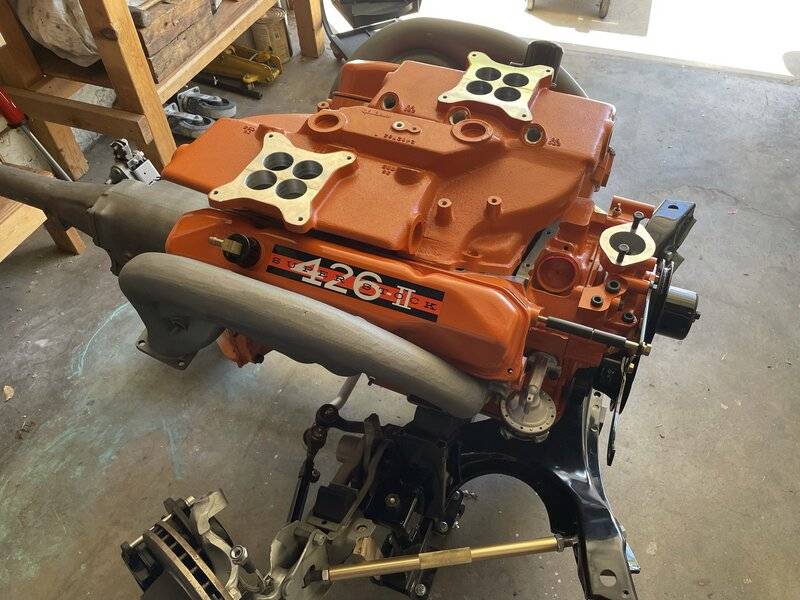

I had a hard time deciding which way to go on those. I have built this car to be how it should be for a 64 super stock Plymouth. I agree with you on people at shows would see the decals and wonder why the II and not III for 64. The biggest problem was the Exhaust Manifolds not being the Tri-Y style which was the most visual change on the motor. The motor looks more like a stage II then a stage III. I don’t know what is best on terms on what I’m representing. What’s your thoughts on this? I could use another opinion ThanksChuck...Why 426 Stage II valve cover decals and not 426 Stage III valve cover decals, which would be 1964...the year of your Plymouth?
I have a 1963 Plymouth Savoy 426 Stage II (June 1963) Max Wedge (4 bolt valve covers) and the 1964 Plymouth Belvedere 426 Stage III (November 1963) Max Wedge (6 bolt valve covers).
Just letting you know that if at a car show, people in the know are going to ask the same question.
Giving you a heads up.
Big surprise when I open the hood. EVERYBODY expects a Hemi Or Max Wedge.Steve...Nice looking machine...
What motor. transmission, rear end 8 3/4 or dana 60 and then what gear ratio?

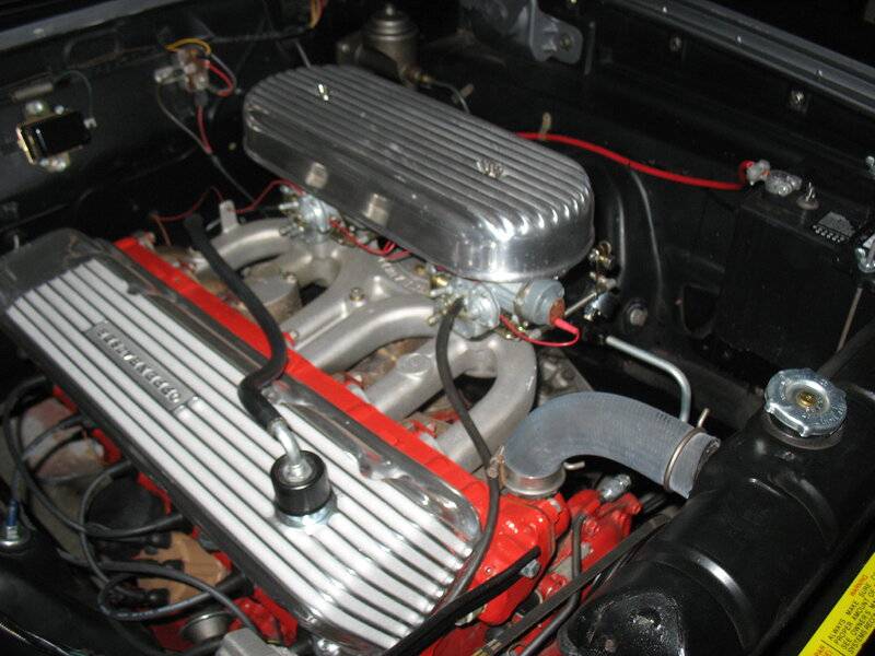

That picture is what I’ve wanted, the fuel filters and lines are running along the valve cover on the right. The lines from A&A Transmissions and Mancini Racing where they are side by side on the left center is not correct. Thanks for this because now I know which way to go. I’m wanting to run Edelbrock carbs because they are based on AFB designs, I’m also running velocity stacks to the hood. Sorry I’m slow getting back to you it’s been a crazy weekChuck Marshall...
Here is the best photo of the original fuel pump to carburetors fuel line T before the split to the two carburetors.
Not knowing what carburetors you are going to run, still I did post the carburetor fuel pump to carburetors for you in earlier posted thread.
I hope that this helps.
