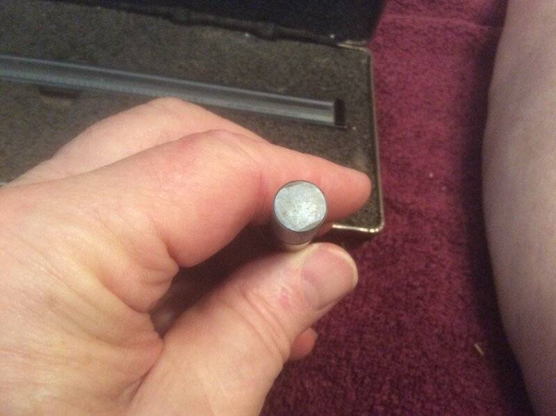

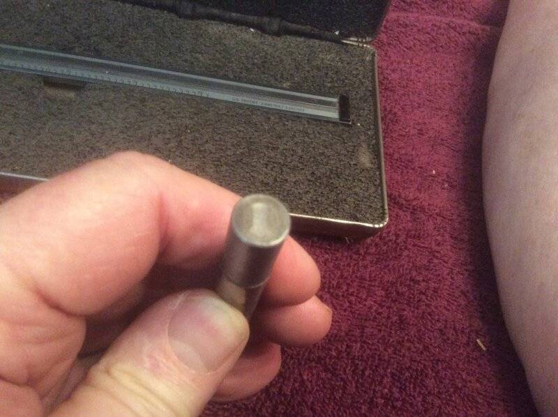

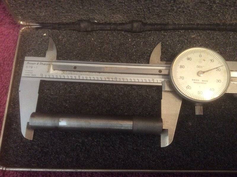

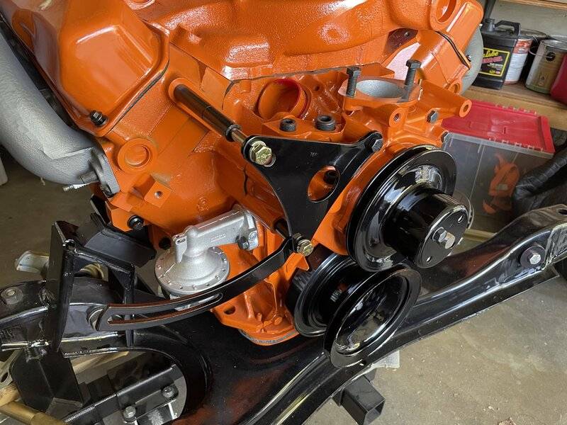

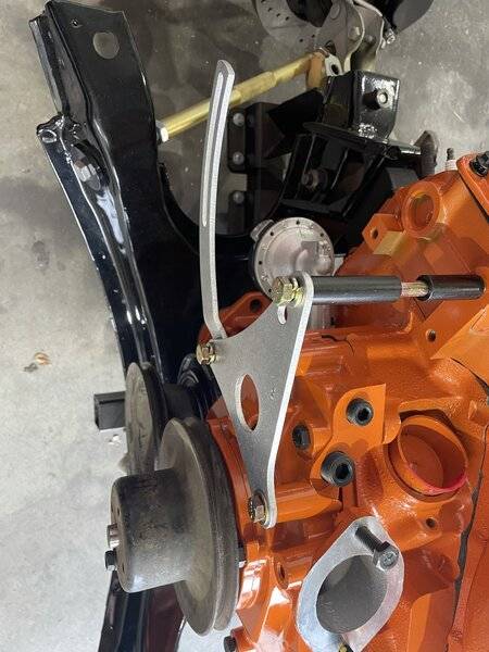

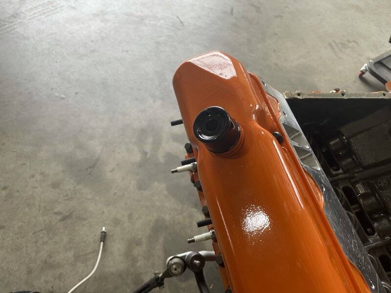

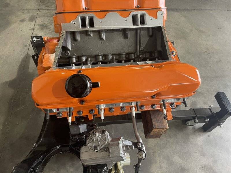

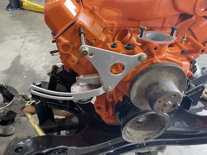

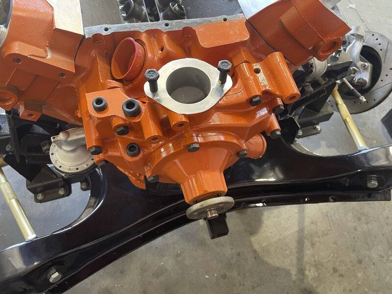

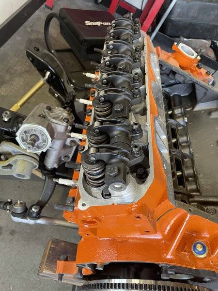

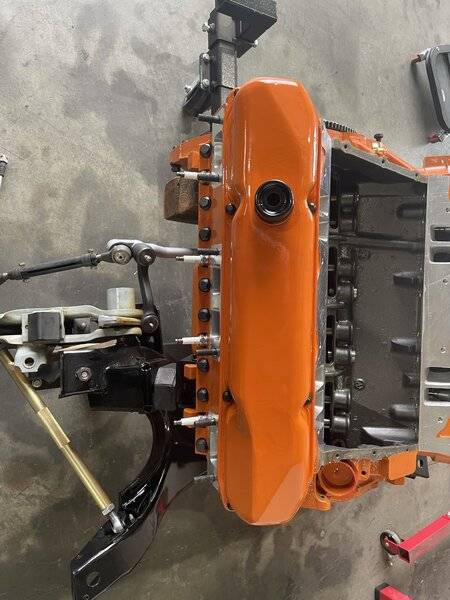

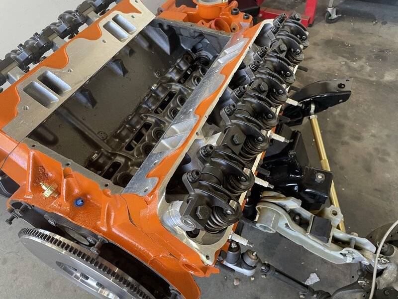

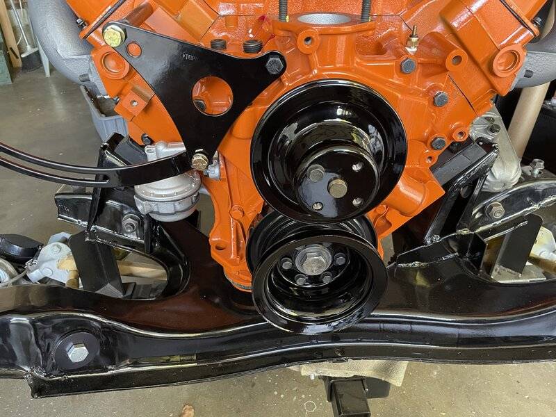

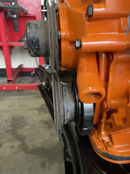

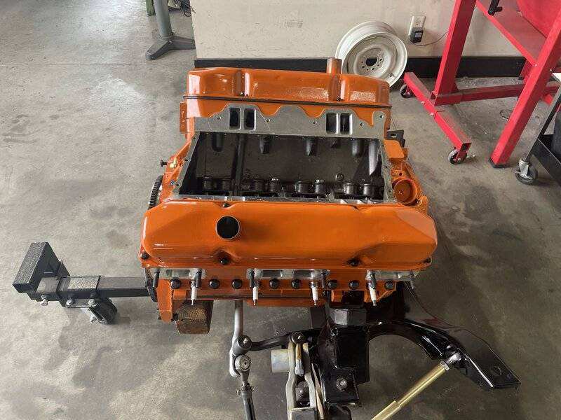

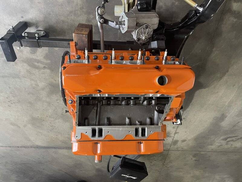

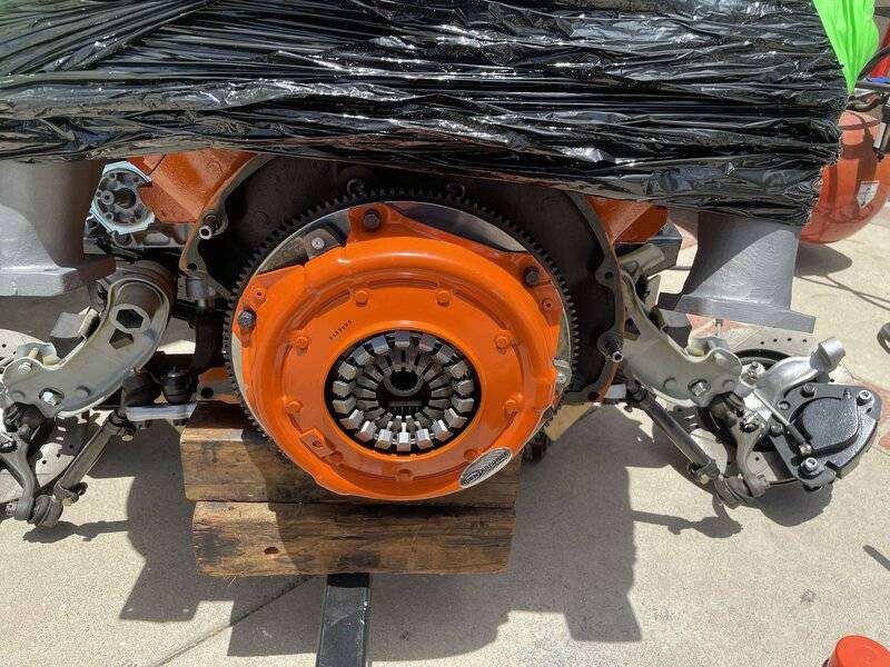

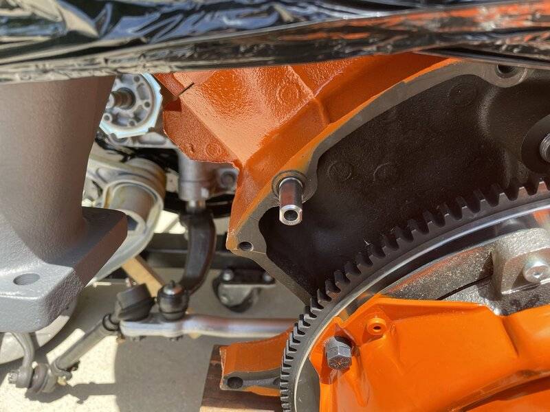

Got the thick black fiber style felpro gaskets for the valve covers and black ARP bolts. Also got a fuel pump push rod from Mancini racing. Steel stock one. The cam is a caster Comp Cam so the steel will work right. Got the Carter M6903 pump as well. Next I will be mounting the rocker arm and measuring the push rod length to order the all Comp cam parts.
