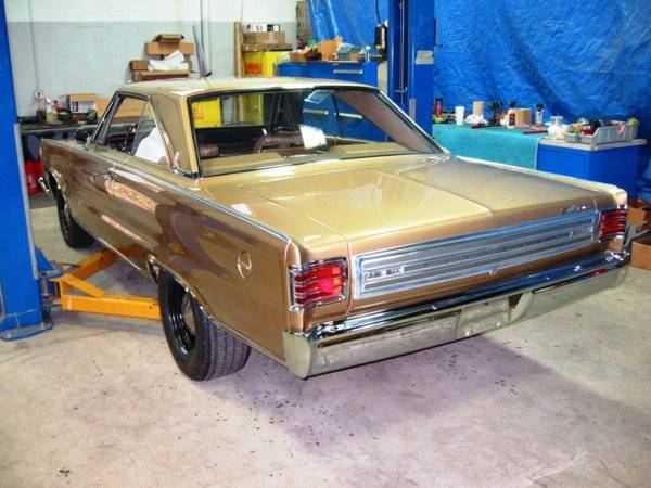

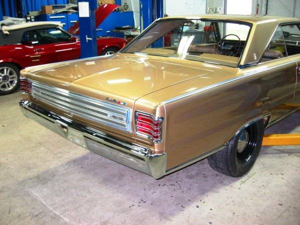

We're cleaning up a bunch of details and we took some photos for the insurance company, I know how much you guys like photos so I thought I would post them. Thanks for looking, Brian.
To POMONAMISSEL and you other guys that felt that gold wheels would be better you may be right but I'm still undecided. I do like it a lot better with the wheel lip trim and rocker moldings. Thanks again, Brian.

Hi POMONAMISSEL, I do think that the wheels would look good body color, if they had trim rings. When I was younger, one of the guys in our group lost a trim ring and it did an unbelievable amount of damage to a very nice car. In my opinion trim rings are also excellent for creating an out of balance wheel assembly.
Back in the day we used to remove hub caps and trim rings at the drag strip, I'm not sure it was required but we did. It became cool to cruise on Woodward Ave. after being at the track with no caps or rings.
In the middle class area I grew up in most all of the new cars purchased were very lightly optioned. Man those old guys were cheap! I'd bet that fully half of the cars on my street were 6 cylinders, 3 on the tree and the option was a radio, most of them had bennie hub caps. Those 10 year old cars were what we bought when we started driving, notice I didn't say my parents bought me, the kids today wouldn't be caught dead in the cars we drove.......LOL.
I guess the steel wheel and dog dish look just evokes memories for me, that said, the car is way to glitz. Thanks, Brian.

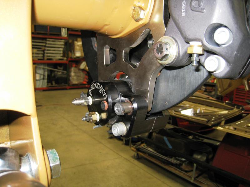

Hi Guy's I've been working on my project but I discovered some build issues..........one step forward two steps backward! First the wheel studs in the front spindle are not long enough. I'm using a steel wheel and I would have thought that would require about the shortest stud of any configuration possible, regardless they aren't long enough! The front knuckles, spindles, hats, rotors and caliper assemblies were about the only part of this car that I didn't think I would have to touch again....LOL. The way the Wilwood kit assembles everything has to come apart to install the wheel studs. I put them together three months ago and I just now got the red stains off my hands from the synthetic grease, not to mention the holes in the ends of my fingers from the safety wire. Then I discovered that the rear axle didn't droop far enough in full rebound to allow me to get the tires on the car. In addition the small single piston caliper that that I mounted straight up to perform the parking brake function was also in the way. It's been so long since I've worked on a vehicle that the wheel well lip covered the top of the tire, I never even considered this might be an issue......dummy, dummy, dummy........ So longer shock eyes, a relocated parking brake caliper, longer front wheel studs and we are back to making progress.

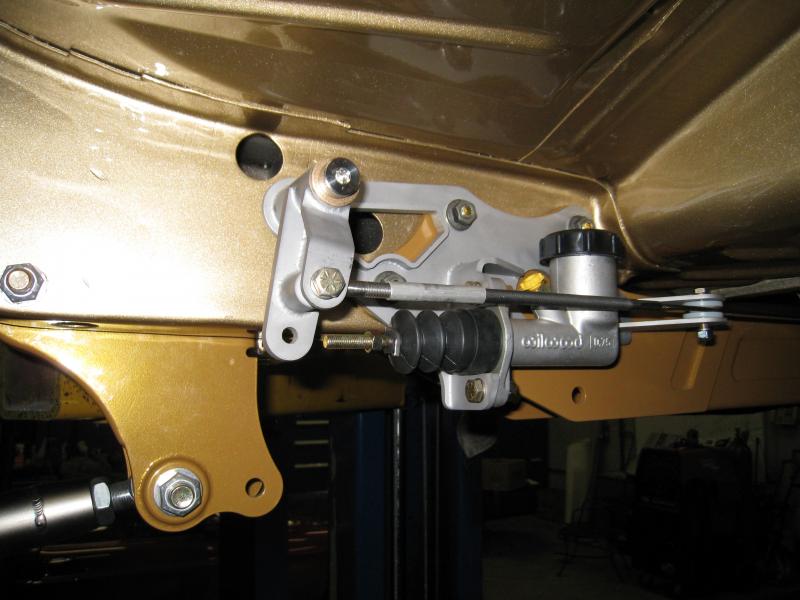

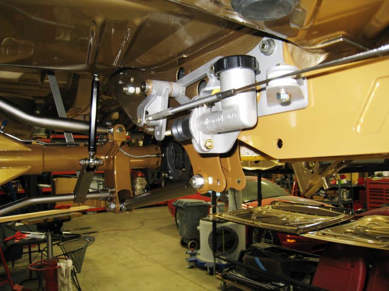

I normally don't post until I have finished parts to show but in this case I needed to feel like I was making progress for my sanity. I wanted to use the original parking brake pedal assembly in the car so in order to integrate it with hydraulic calipers I built this little cable operated master cylinder assembly. The ratio needed to be increased as the cable only pulled about an inch and the caliper stroke is 1.375 in. I'm pretty sure that the system would have worked without the ratio change but then again I thought the tires would go on the car too. The roller is to align the cable for a straight pull and the coupler and clevis still have to be made. The piece of tube between the cable stud and the solid rod end is just a place holder. Actually I've been having fun but I got a little lazy and I was humbled for it! Thanks brian.View attachment 248032View attachment 248033View attachment 248031[
