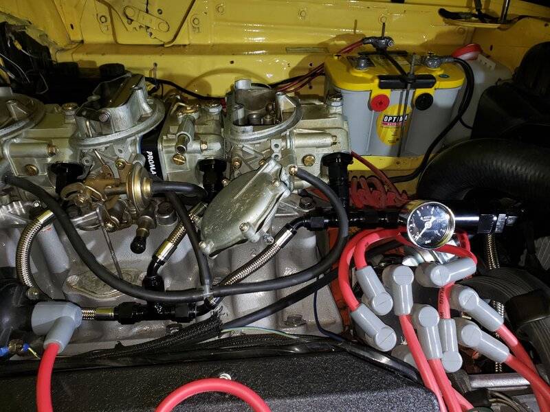

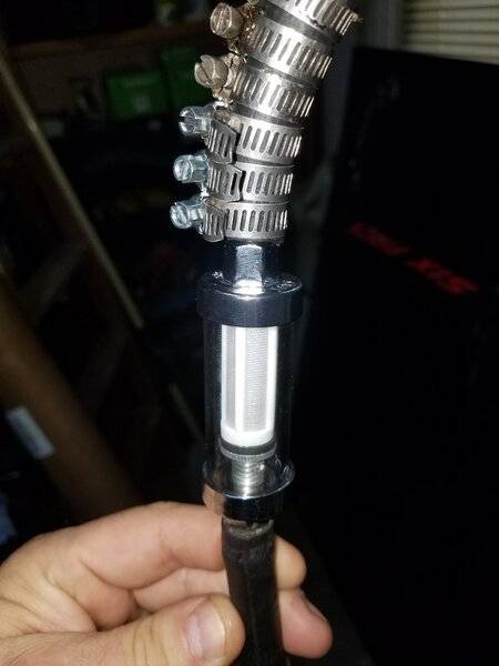

I would not put a filter in front of the pump. Just my opinion.
Yeah, I did order a set of 64's, now'd be the time to do that..If you have a bigger cam than stock, I would change the center jets to 64. 62 cones stock in it.
That hose is smaller than by breather hoseYeah, I did order a set of 64's, now'd be the time to do that..

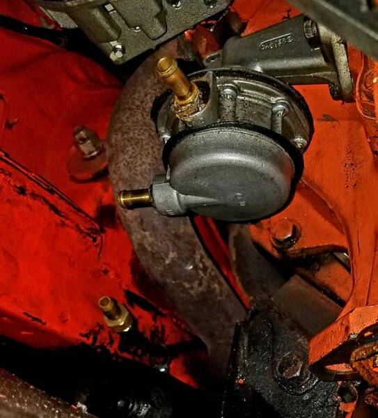

I need advice running a new line, from where tank line ends, THEN, after Pump to carb lines, I don't have but maybe 3"- 4" between tank line and outlet. Isnt this a Carter M6903? Its does seem to be slingin' oil around its gaskets..
You can see my limited angle room to work with fromUnda..
[Sorry its early for me, 18 hr shift last yesterdaynight] Anyone interested in a job with KCMO P.D.? LoL
Gettin old, no lift makes this no fun.. (From Pump to line)
Setiously, dont know how the damn thing ran as well as it did. How did my father NOT put at least ONE damn filter inline..UUUGGGH! Then there are these Glass pieces of sh"tt.. Looks cool. But "Looking Cool" rarely means "Performance".
That hose is smaller than by breather hoseLooks smaller than stock
) so I just replaced it with a new Wix same part# but at least I know how old this one is. 40 micron inline steel mesh filter is in the braided upper line main feed in, right before the fuel pressure gauge and 3 braided lines that go to the carb bowls.

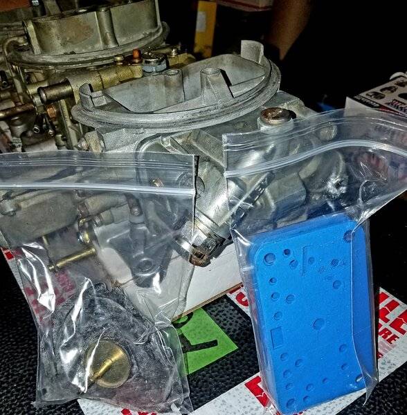

delayed another 2 weeks!? Something amiss with their Dichromating process.. They said
.. I'm.about to slap a "Torker" & 950 D.P. on the damn thing! Anyway, picked this up from E Bay last week,

Wow...that 6bbl definitely needs some TLC. Be careful with the vacuum pod diaphragms, I've read they tear easily.Yeah, I see several going to an electric pump, as u know, you also do NEED a regulator ad seen. Im trying to keep ye ole A12 as OEM as possible. (Knowing these days, with our evil crap Gasoline?) Changes ARE necessary such as blue carb gaskets. Freakin Holley, delayed another 2 weeks! Something amiss with their Dichromating process.. They said.. I'm.about to slap a "Torker" & 950 D.P. on the damn thing! Anyway, picked this up from E Bay last week,
its got some decent retro assy line pics of linkages etc..
Both Promax and SixpackPerformance came through with the baseplates!
I do have 3 Sets Of ALL NEW 4365 Gaskets, diaphragm.

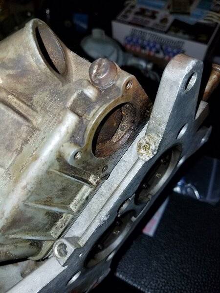

0-4144 is already on the car.. I may not wait on Holley. If my rebuild goes as hoping Hell only really had ONE bad carb out front. I just decided to R&R all 3.. ALSO, noticed this!
View attachment 987266 (Rear outboard)...My God![]()

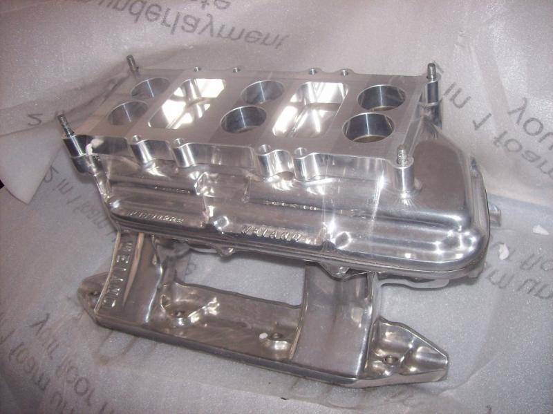

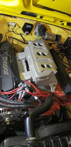

Thanks.Wow, did you have that intake Ceramic coated? Looks killer.
Thanks.
Actually I had it media blasted and clearcoated. I was actually disappointed in the results in that it looks gray instead of aluminum...For the best finishes, that domain belongs to @CudaChick1968
I'm planning on having my Weiand P3690982 6bbl intake polished, but I am going to run it and tune on it first, to make sure I want to keep it.
