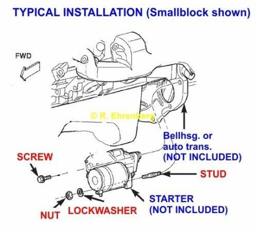

If you have the standard bellhousing you are missing the stud & nut. This is the proper set up and easier to install the starter. Many times the stud is missing because some one substituted it for a bolt years ago.
The stud is actually smaller on the side that the starter mounts to. This gives you more "wiggle room" to position the starter better and more access to the nut.

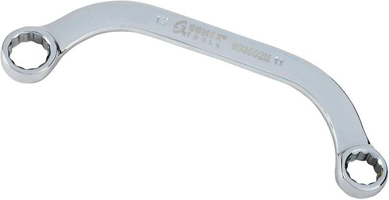

I have 2" TTI headers and starter removal is exactly what you'd expect. I have box end wrenches that are cut in half to fit up in there to loosen or tighten.

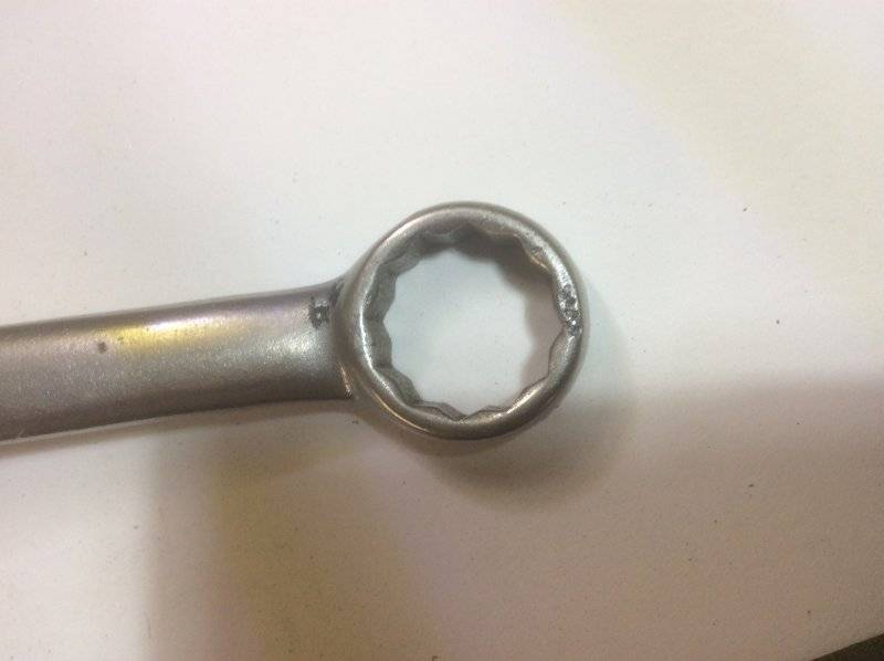

Flattened back of wrench for torque convertor bolts. Top of wrench pic 1 flat pic 2, less chance of rounding head of bolt.
