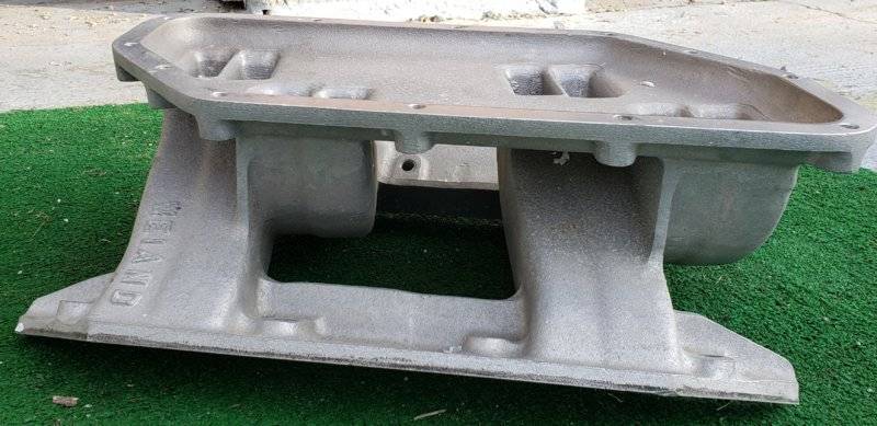

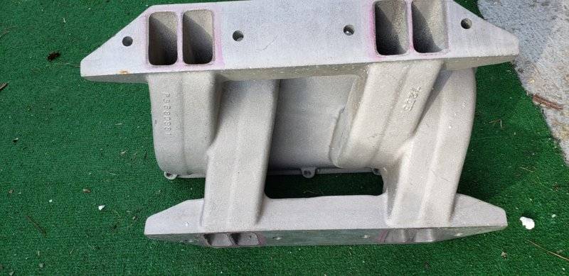

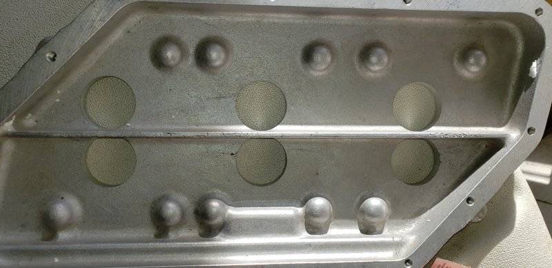

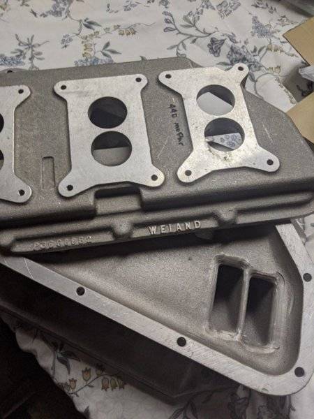

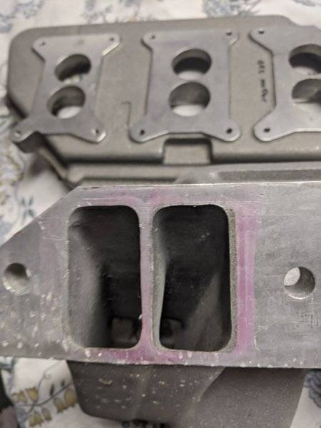

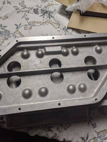

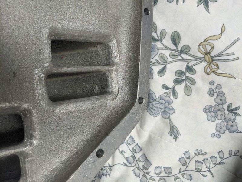

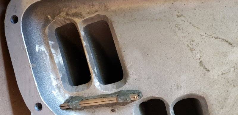

Absolutely on the tiger stripes.Well I got pictures of the other Weiand intake, and I am happy to say it looks great, and I told him to send it.Holes by center carb are not in the Chrysler Performance bulletin, and like all of the areas where material was removed just looks rushed and half-assed:View attachment 898085

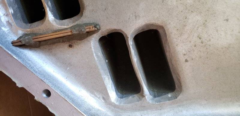

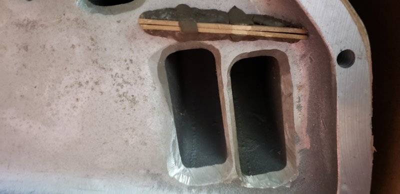

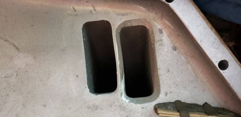

The area behind the one outboard carb hole is rushed looking too, and not enough material left of the original hole by the carb surface:

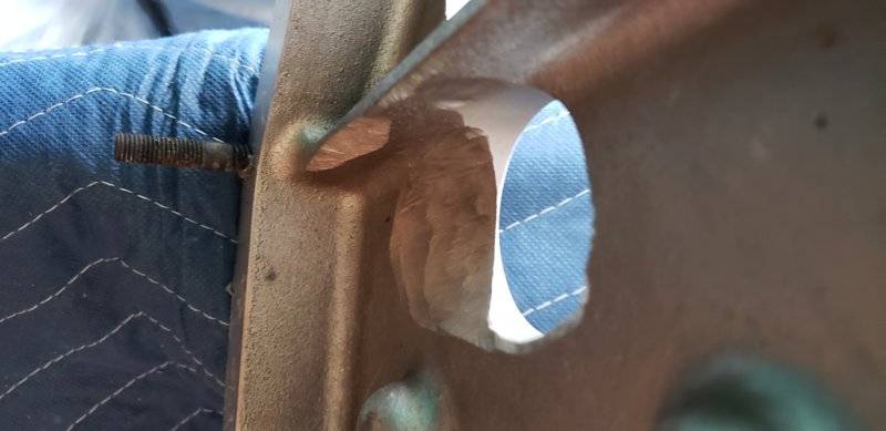

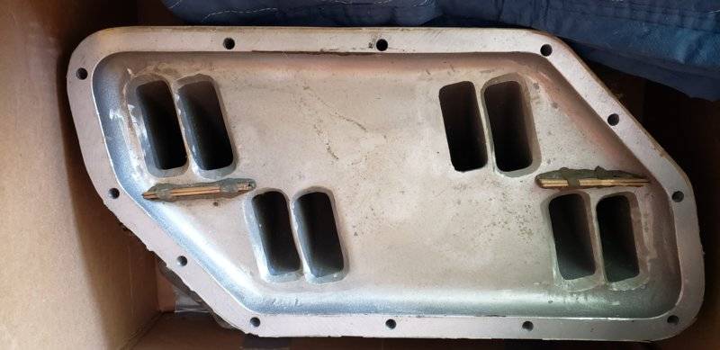

These are the "dams" LMAO!
View attachment 898087 View attachment 898088

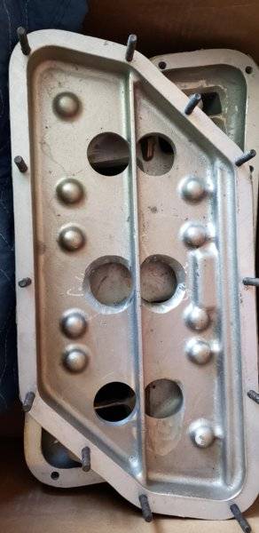

And the bulletin calls for ALL intake ports to be "radiused 5/16" and BLENDED into the plenum floor. Lol! They were ground so deep I was concerned that the port may have a paper thin amount of material left where the sharp, deep angle cuts are:
View attachment 898090 View attachment 898092 View attachment 898093

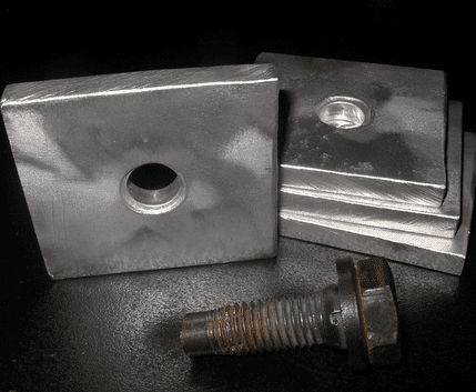

Thanks. I am having a QA1 K-member and front suspension system installed in mid-February. For now, I'm counting on the guy who swears the Weiand will fit. I'll know soon enough. I would certainly consider K-frame spacers if I needed that to make it work.IF you're close but no cigar maybe............
https://board.moparts.org/ubbthreads/ubbthreads.php/topics/1059328/shimming-the-k-member.html
