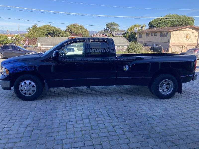

Thats how life gos, thinking of saving money and next thing your spending it. Good luck on a truck.
Can you drive a stick?
