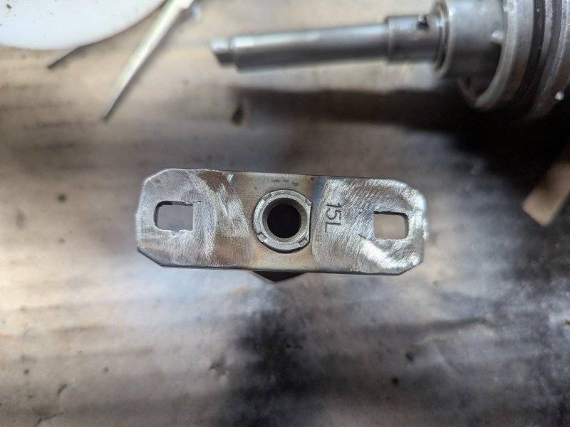

And... did some precision machining on my dist.. need to make the holes a little smaller still, the math didn't math..

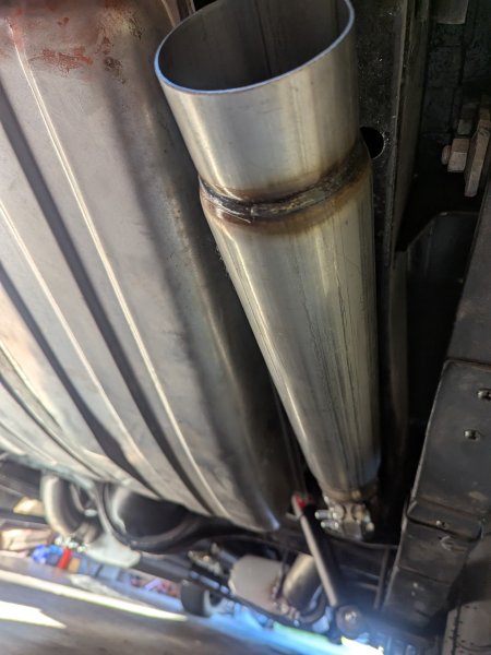

Soo.. tonight i put resonators after the axle to try to get rid of the raspyness and quiet it a bit more.. it did help a bit.. not as much as i had hoped. I only got the 3.5" ones since i was worried bout space, i should have gone 4" and might over winter.

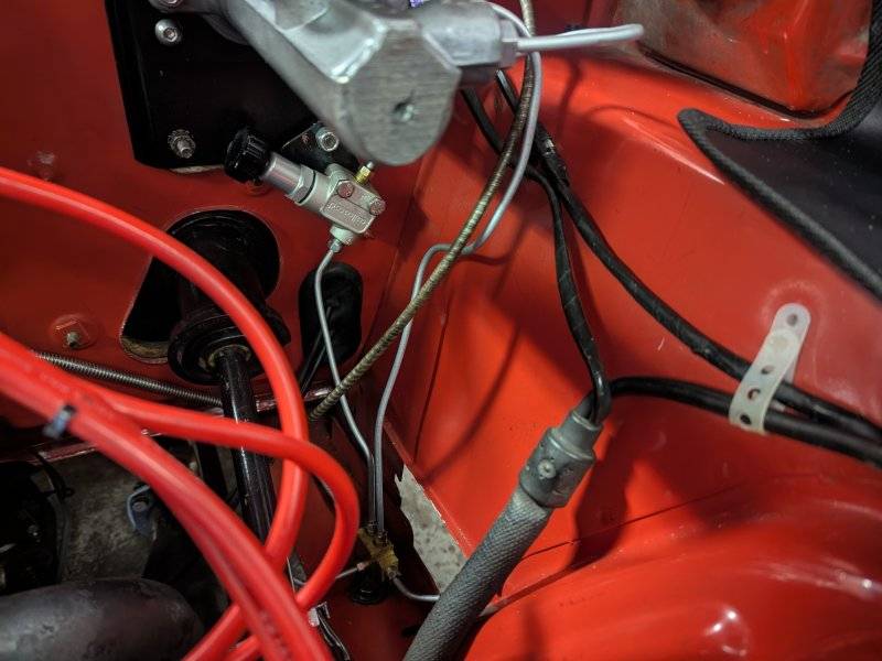

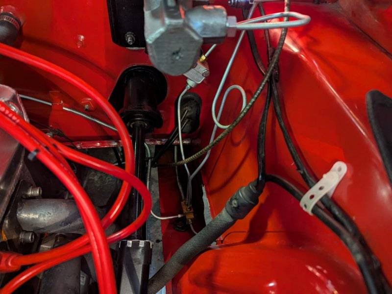

finally decided to figure out my brake problem.. i had checked with a pressure gauge and was only getting 400psi at the calipers no matter how hard i pushed.. was starting to think it was my pedal ratio or something mechanically wrong, then i ran into a post by a guy that tested at the MC (common sense.. just didn't think of it...) and made up a short line and tested tonight.. 1000PSI at the MC.. soo.. losing 600psi somewhere.. first thing i'm trying is, the line for the front brakes i got from inline tube and has a big vertical loop in it, possible it had trapped air, i made a new line in it tonight with more of a Z so it can have a bit of movement (my MC moves a bit) but shouldn't trap air, need help bleeding before i can test it..
