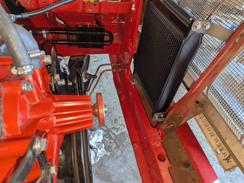

92 degrees out but actually felt good... got home from work,did some yard work then made the lines to the fittings... they fit soo good.. then i took them off to clear them and they fit like crap on the next install. but good enough for my crap.. I will say, i have never wanted a lift before. but doing lines under the car would be sooooo much easier with one..
Need to do the small lines to the cooler itself.. should be tomorrow, ran outa energy today ;)

Power steering cooler works.. theres bout a 20* drop across the cooler..quick drive and pump was around 160..
