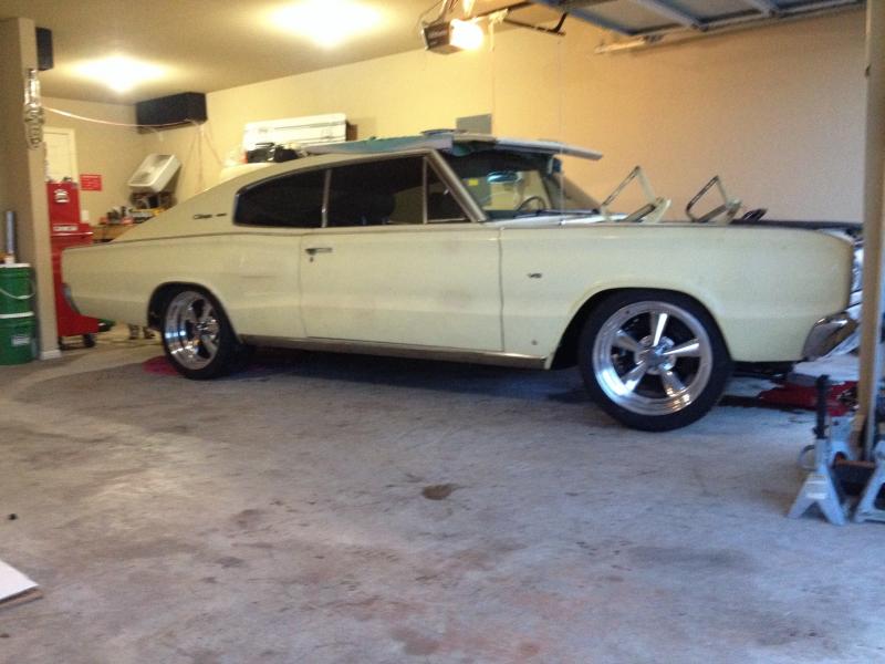

It isn't done but what it will look like with 18x9.5 Cragar SS rims all around with -12 offset or 4.75" of back spacing. 285/35/18 rear and 265/35/18 tires. image.jpgimage.jpg

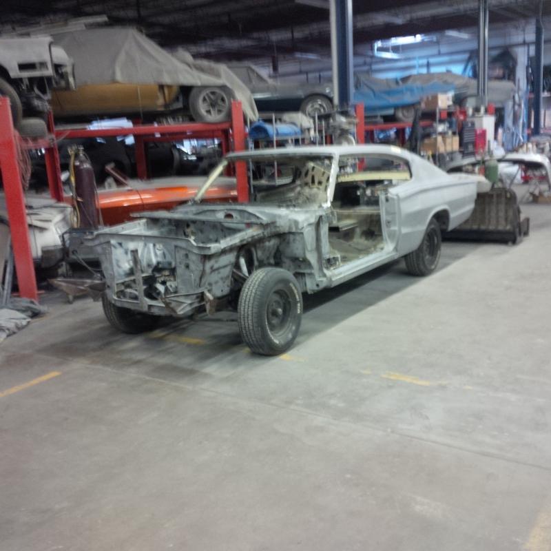

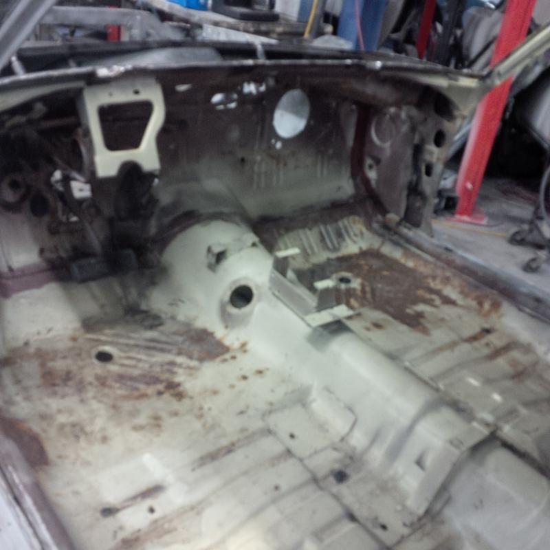

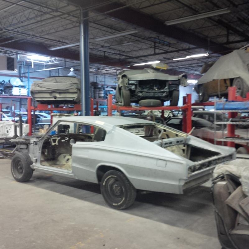

Thanks for the welcome. I attached a few more photos of the current state of the car. a little more information on the car. it is a 67 that I purchased 14 years ago. Had a "friend of a friend" perform some work on it shortly after I bought it which was subpar to say the least. I finally decided to send it to a professional restoration shop this year. Car is non numbers matching as I bought it with a 78 400CI block. Decided to go the restomod route as the motor was in bad shape. Planning to install a 6.1 hemi. Plan to change the car to red (PP-1), it was black right before and yellow originally. Will restore exterior, interior to original look with new hemi, modern transmission, modern disc brakes (have to be able to stop it) and probably newer/modern AC.

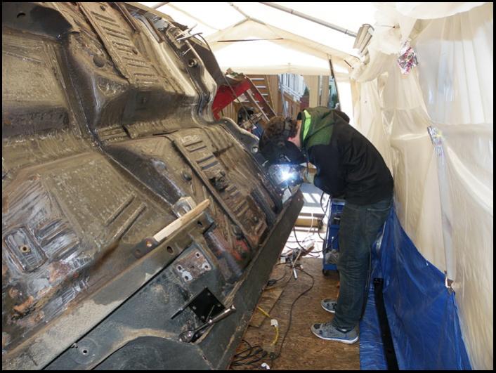

That's my son getting in a little practice with the welder.

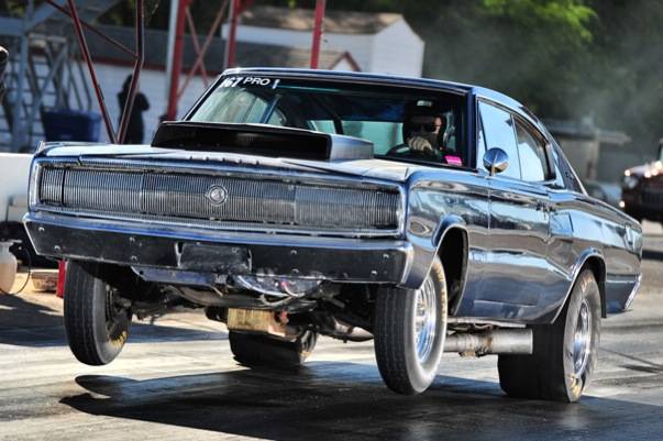

I inherited this car from my Dad twenty years ago.
When I got it it had a tired 440 in it. I was convinced it was a 13 second car but when I finally made it to the track it ran mid 16's.
I'm not sure what happened on the drive from the farm to the drag strip but bit sure slowed down.
Currently it has a all aluminum 572" Indy motor in it, 572-13 heads and it makes about 800 hp.
The car has a cage in it. Is mini tubbed with ladder bars. A Moser 9" with wilwoods in the back.
Front end is mostly stock. K-member is sectioned for oil pan clearance and the lower control arms are boxed.
It has 11.75" brakes with wilwood callipers in the front.
It runs around 10.30 @ 130mph with a best of 10.05 @ 133 mph.
Last year I reinstalled the interior. So this this a pretty heavy beast.
I have a new LSM cam for it so hopefully some high nines this year.
If I can get it lined up I will stick a fogger on it and shoot for some low nines.
I am not exactly sure. It was 3400#. With out the interior in it. With the interior back in. I am guessing it is 3700#
