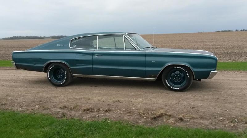

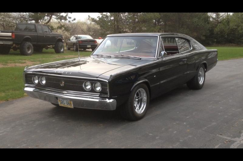

66-67 charger photos

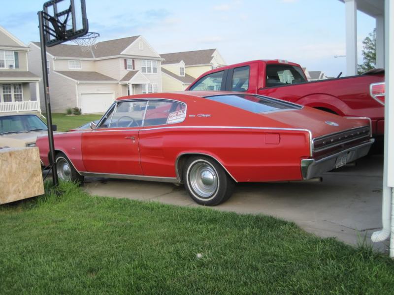

our 66 before and after

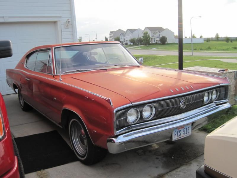

this is the 318 charger when we got it

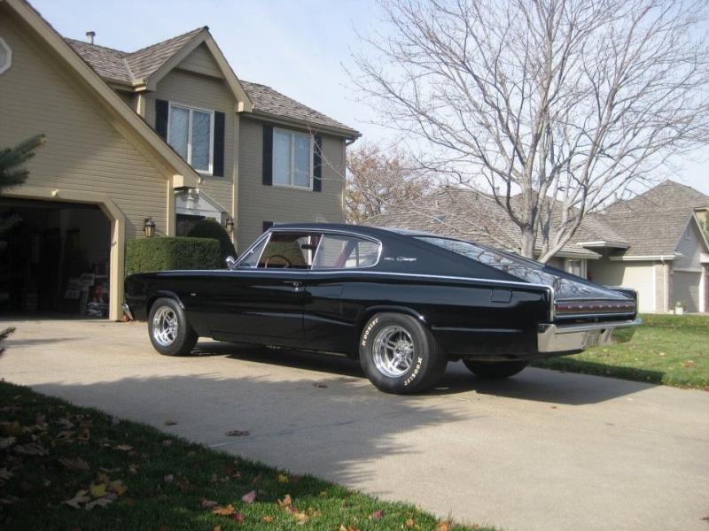

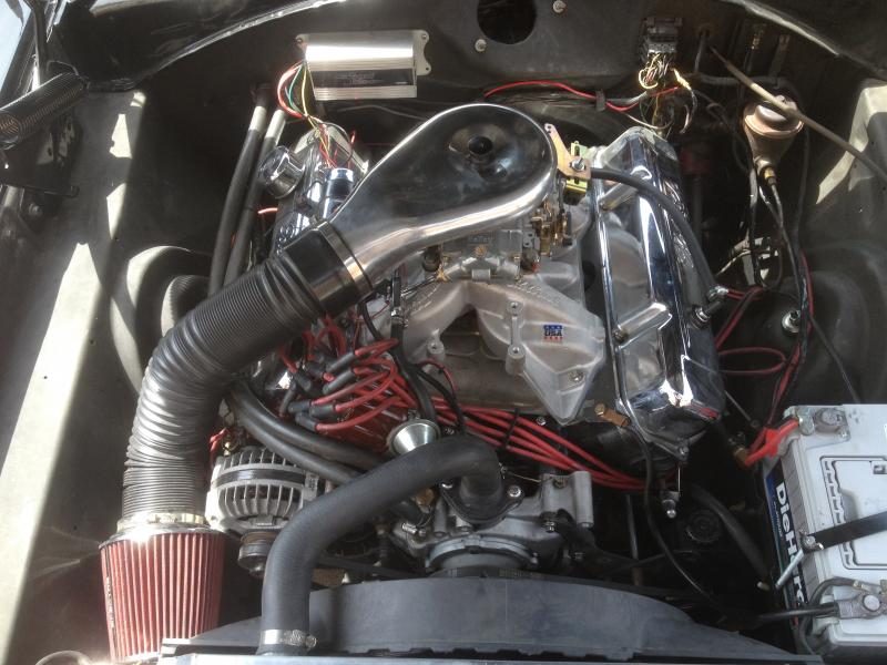

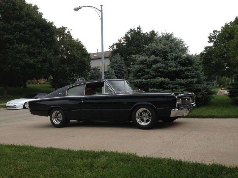

and how it is now
rebuilt 440, 284 comp cam, 750 holley, hookers, and pertronix ignition.
727 with shift kit
rebuilt 8 3/4 with 3.55's
centerline split spokes
complete suspension overhaul, hotchkis leafs, and torsions. energy suspension bushings all around.
interior is yet to be done though
the hoosiers are gone because they were just too big for how much street driving we do. went to a mickey thompson
hope you like it!

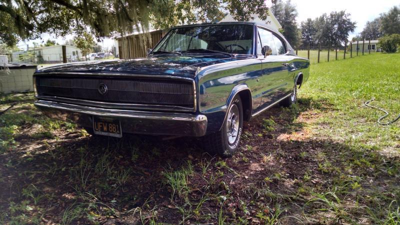

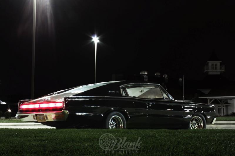

Here's another of the front
Need to figure out where the short for the headlight motors is. The motors work when jumped with power but the switch only turns the bulbs on
Great job on the car! What size rear tire are you running?
Headlamps...could be a bunch of possibility's why they aren't rotating. It is good that they spin when hot wired.
I would start by checking out this link. It is the Charger supplement service bulletin. It has all the systems unique to Chargers. It has good troubleshooting and wiring info.
http://www.retrorarities.com/images/ChargerServiceManualSuppliment.pdf
Thanks to Bob (OZking) for the site
My guess is there is a problem with the 3 relays behind the glove box. If you pin it down to the relays Bryan (A383Wing) here has new plug and play modern Bosch relay kits.
Any questions I'm sure we can help you get the lamps turning.
Good luck!
Reed
Good luck!
Thanks GP.
Another item that everyone forgets about is the relay behind the driver kick panel. If it's bad or broken, the lamps won't work. That is an easy replace from NAPA (or parts store).

charger photos

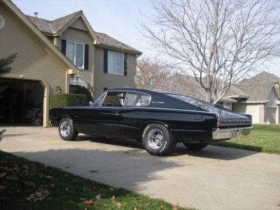

and how it is now
727 with shift kit
View attachment 184229View attachment 184230View attachment 184231View attachment 184232
hope you like it!
HI, beautiful charger, what's the size of the Hoosiers? Thanks

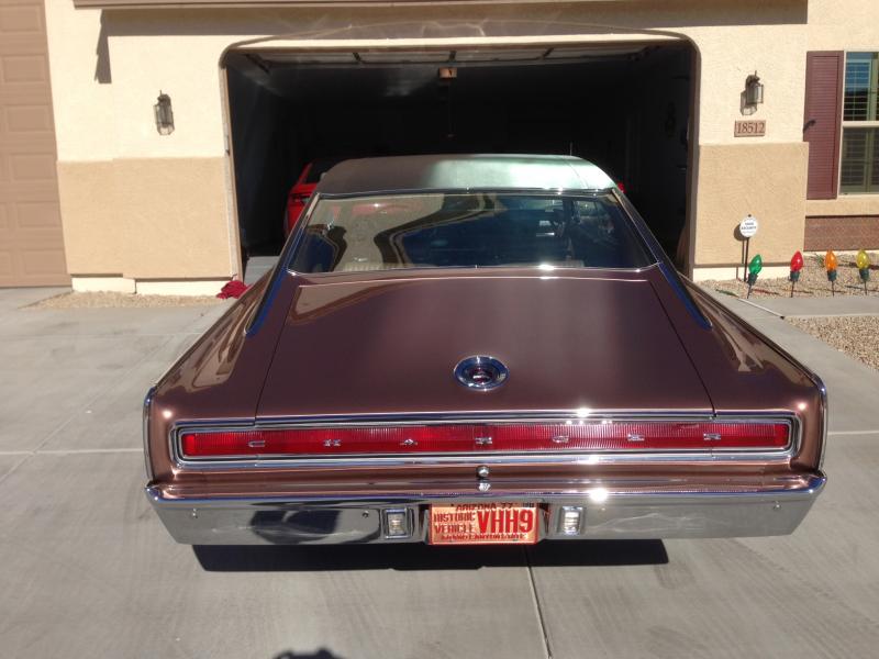

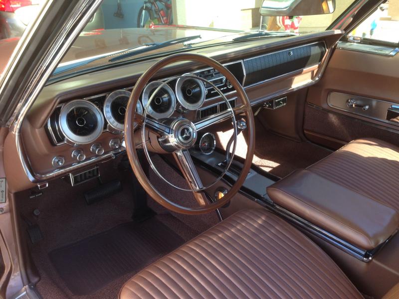

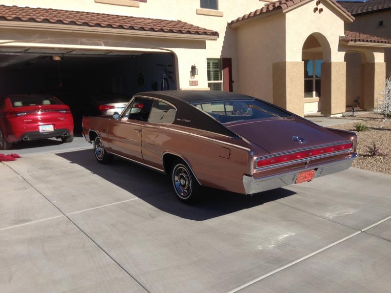

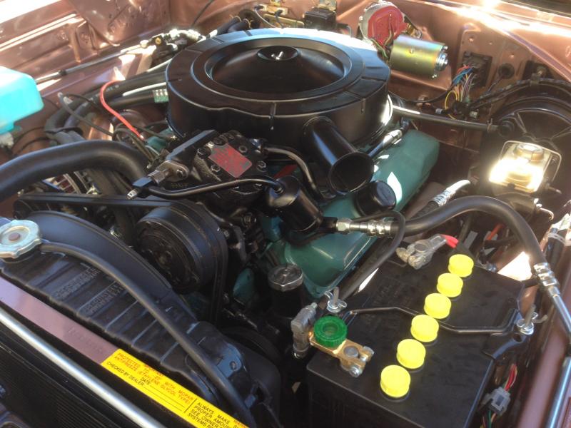

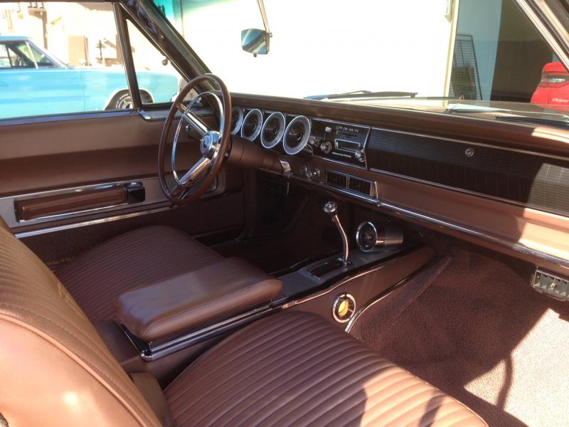

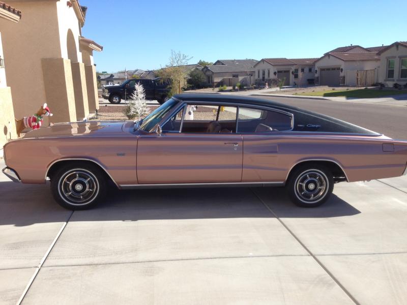

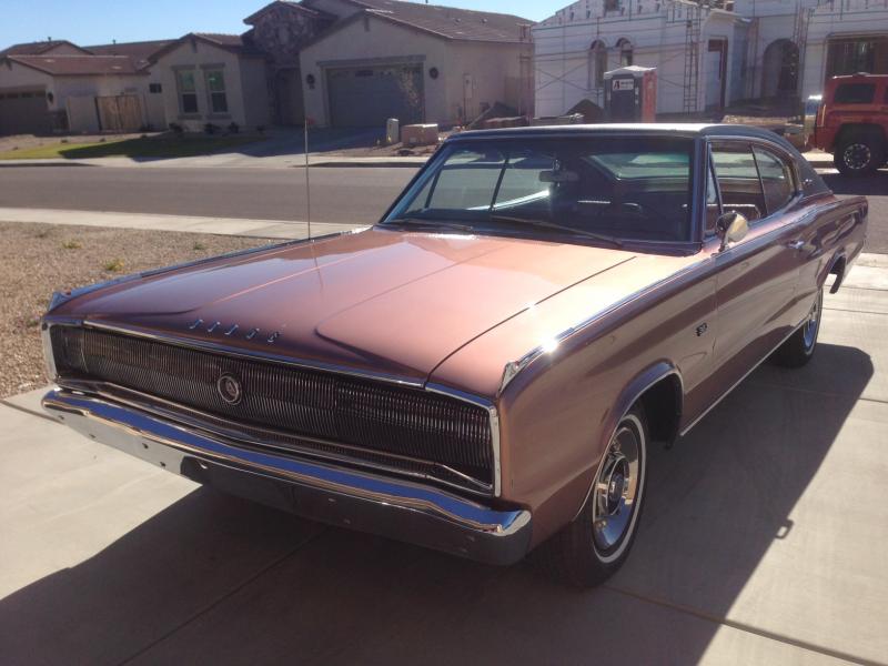

My 67 Charger Finished
Here are some pictures of my Copper on Copper White Hat Special 67 Charger finally finished after a 4 year restoration project. 383, 727, PS, PB, factory AC. From my research it appears to be one of 12 made in 67 with this color combo.
As you can see from the Xmas decorations, it was actually mostly complete in Jan of this year. As if they are ever done, lol!

That Charger is such a beauty Mark! I've always liked that color combo! Some day I hope to see it in person.
My 67's finally leaving the yard and heading into the body shop here in a couple of weeks. I still have some work to do before paint, but who knows, I may have a painted body ready for assembly by spring.
Mike
Christmas in Arizona...LOL!
Thats one of my top 8 dream cars. That specific color combo and top.
