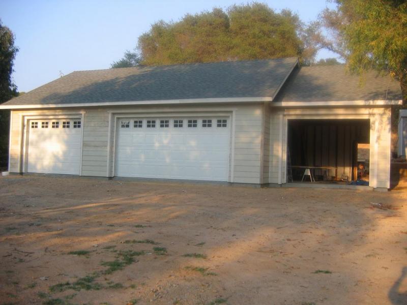

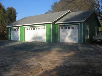

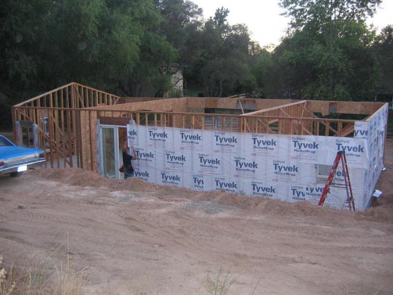

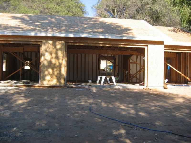

I went with a traditional style building. 60x32... sorta. I reduced the right side to 28' to give the building a little bit less of a boxy look. I framed it, stacked the roof, ran the siding and windows and wired it. I still need to finish the plumbing. 1608 sq ft.
If you use infloor heating map your tubing and leave spaces for bolting your lift if you get one
it is a real pain fixing a cut tube in the floor
Also make sure you use thermal breaks to the outside walls and insulate under the slab
