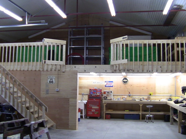

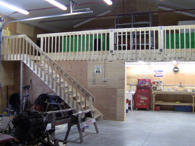

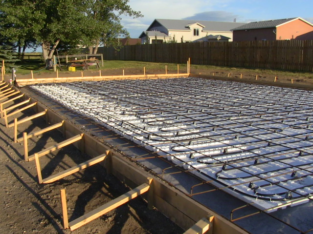

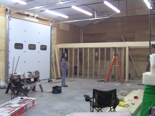

I hear you on no loans. I saved up and payed cash for everything in mine. I did every bit of labor I could as well. Being old it sometimes hurt but it was worth it. I did the dirt work, formed for the pad and installed the radiant lines, then payed some one to pour and finish. Fortunately my bro-in-law erects steal buildings so we did that as well. I went with a "self framer" building. They are pretty well priced. I did all the interior construction and hired a third year electrician to wire it up, after I had hung all the lights, lots of them, and outlets where I wanted them. I even learned how to correctly build stairs. Now dimension-ally, I went 32' X 54' with 14 1/2' sidewalls. 32' was so I would have a ton of room walking around my newer 4 door truck front and back. I also figured this would allow 3 projects stored side by side with shelving along the walls. This is on the end opposite the bench and out of the way of the overhead door, which is the "work bay". 54' was so I could cut 14' off one end for a bench area an office with a mezzanine above and it still left me a 32' X 40' shop space. 14 1/2' sidewall will allow me plenty of height for a hoist......whenever I get it! Here's some pics, I'm really happy with the way it turned out. But I did think about it for a long time prior to committing to the build.
