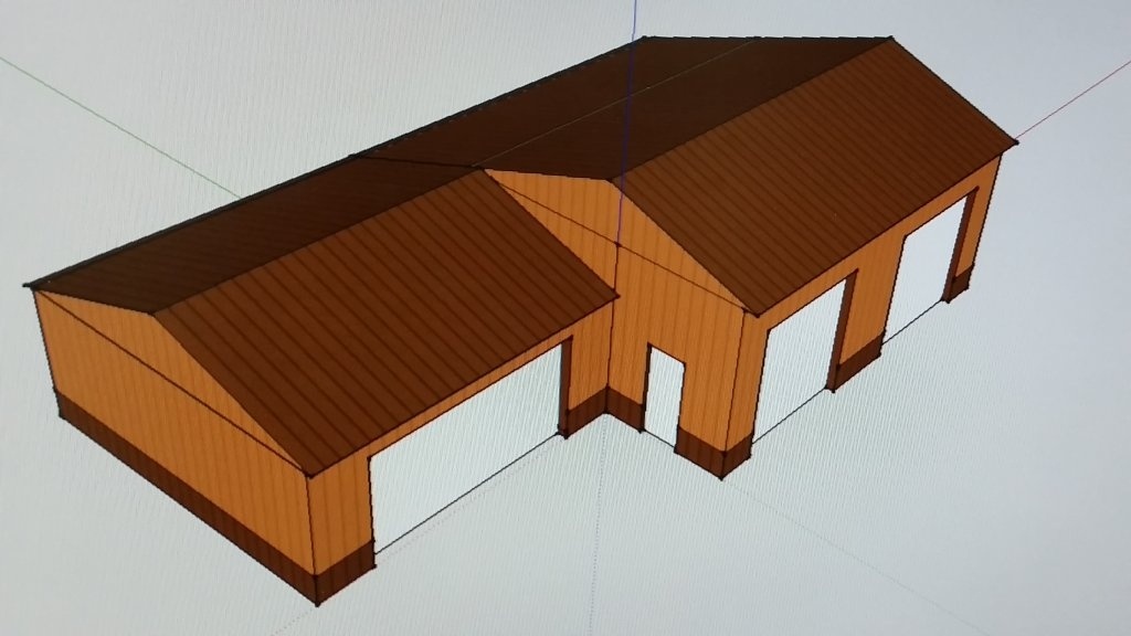

I've changed up the plan, now there will be a 2 car workshop (32X34) with a lift and a 2 car garage (24X24). The shop will be fully insulated and drywalled (I like the fire protection) with a bathroom and a 2 post Benpak. The parking garage will be bare, just parking. Because it needs to fit between 2 driveways the parking garage will be stepped back so the corner isn't in my driveway.
I'm thinking a full foundation under the workshop (cut into a hill) and poll barn style on the parking garage to save time and money. When doing poll barns I pour concrete footers then bolt the timbers down so no worries about settling or rot. Once I get the ball rolling I'll start a thread. Thanks for all the tips... notice a lift was added:thumbsup:.
Here it is, this is a Sketchup program you can download that is very handy.

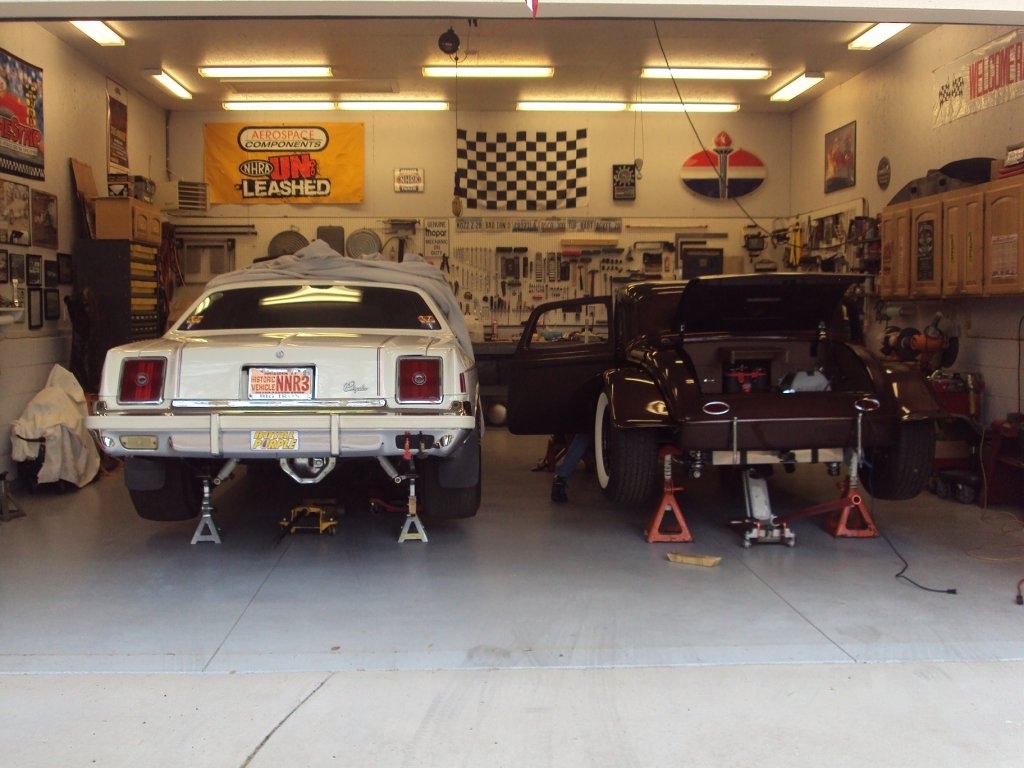

24' won't be deep enough. You need 30 or 40' deep. Remember, most of your actual work area will be up front. I had some space limitations when I built mine (pic). It is 24 wide by 30' deep. That gave me about 8' of working space up front. Also went with an 11' ceiling and roll-up door for future lift possibilities. Also went with a very stout trussed roof and full attic to accommodate a 2000 lb winch for pulling engines, etc. I have a very useable insulated, heated, full attic 2 car garage in a small space.
