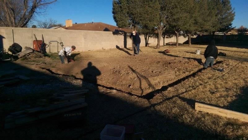

doesn't look like it's ready to pour
Or
I don't see (unless it's not the area in the photos) no ground cover/water barrier
No footings, no wire/rebar for reinforcement, hell no forms, hell no stakes even ?
Will it have no electricity or water going into it ?
or will that be done after from the outside ?
all of which should be done well before they pour
no matter the state you are doing the work in, permit or not

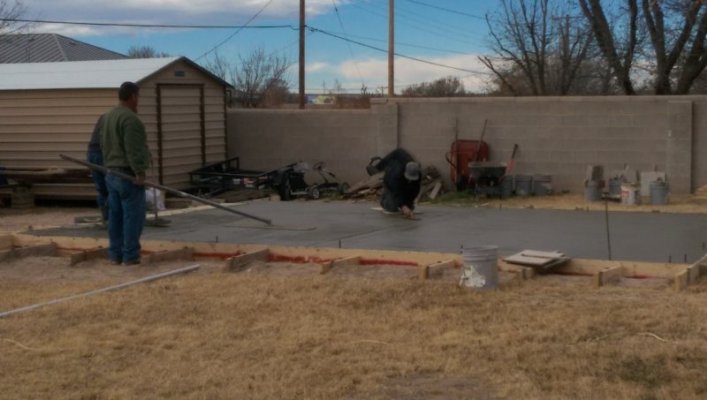

I just had a 24'x30' slab poured for my
shop. Zero access for a concrete
truck. 6 guys with wheelbarrows can
move a lot of concrete in short order,
with no dry pours. They did a great job.
Much cheaper than a pumper.
Tell your contractor what you're up
against. He's ultimately responsible
for any damage to existing property.
If he wants the $ bad enough, he'll
figure out a way to get 'er done.
I also noticed from your last pic that
there is no footing trench around the
perimeter? Even with a steel building
that support is needed with the
expected loads on the finished floor.
Even if you have no frost worries,
you will have moisture in the ground
that will cause the concrete to float,
slip, and slide.

Think so?
I see a footing trench on the sides....
That just looks like gravel to me.
Not a foundation trench. Of course
I have no knowledge of Texas
building codes, but it looks to me
like the OP's contractor is treating
this as one big driveway.
If that is a trench, how is it tied to
the slab other than the rebar in the
floor?
It's still going to have a tendency to
float if not tied in.

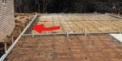

There is a trench and additional rebar at the edge.

Why no plastic sheathing under the rebar? Isn't that needed anywhere a building/room/enclosement is planned.
It’s got footers all around and even in the middle, yes it’s a non stellar pic.
They used a combination of 3/8 and 1/2 rebar. No reason for plastic to be put down, I’ve never done that on any pour. However, they did put “something” down on the house foundation that’s being built across the street. The small area doesn’t have any footers, not needed.
Called a 'Monolithic pour' they work very well. Especially in your climate. :luvplace:
