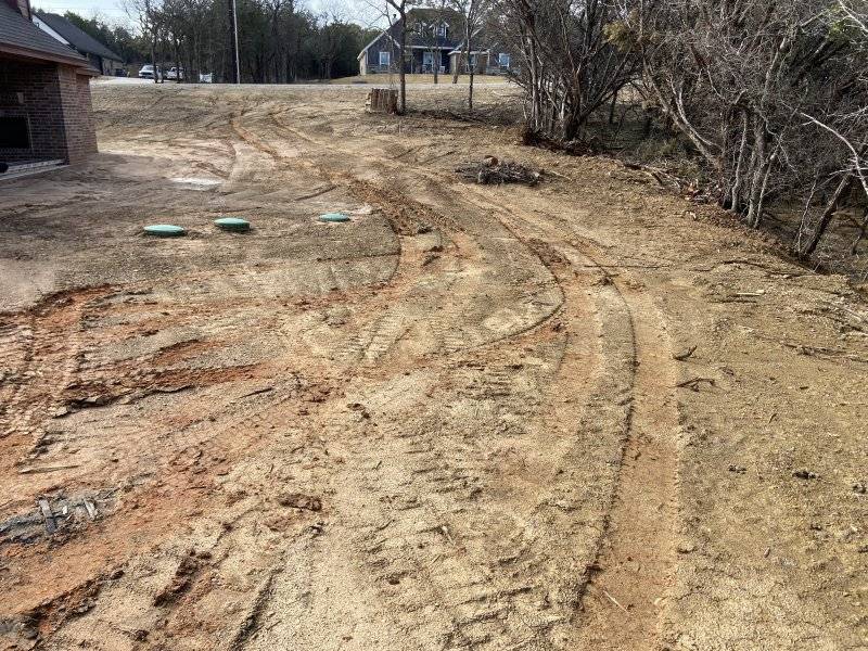

Getting ready for concrete for a shop. The shop will be 22x35. It’s not the biggest shop, but it’ll do. The dirt here is friggin soft, we had some rain come through on Tuesday morning, concrete is scheduled for Monday morning. I’m thinking we need to wait.
My wife backed the trailer onto the driveway and then 4-lo out the back/up the hill. Our truck dropped pretty good in the backyard and that’s where the contractor wants the cement truck to back into. I’m thinking we need a pumper.
A stuck concrete truck is a bad situation. There is only so much time to unload a truck before the concrete is damaged. How this gets poured should be the contractor's decision and risk, not yours.
I'd also add that that new driveway slab will be at risk when the concrete truck rolls over the edge onto soft soil. It needs to be protected with some quarry spalls + gravel, or other means.
He wants the concrete truck to back onto the dirt in the back and pour it. Yikes! I’ve wheel barrowed concrete lots of times, but I think in this case, a pumper would be best. He’ll be here tomorrow, I’m sure he will agree with me.
I would be cautious about putting a slab over an area that soft. How longs till it settles and starts cracking?
That area for the shop isn’t soft. It’s the area to get to the backyard that’s soft. My truck only dropped an inch or so in that area cause it rained a couple days ago.
A pump won't cost much compared to the cost of a stuck Concrete Truck.....or concrete going off in that truck.
Contractor will be here tomorrow morning, I’ll go from there.
