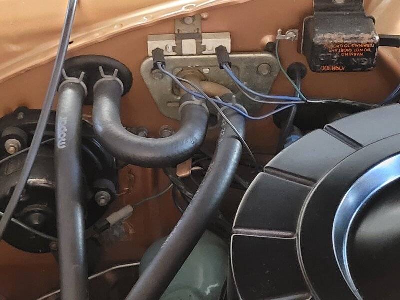

Under hood pictures of the hoses at the firewall would help.

No, the water valve is on the firewall, and you say it's been removed. So is there a hole where it was or just no hoses connected there. A picture would surely help. I don't have a good enough picture of a A/C firewall to point out what you are looking for.
Here is what the water valve and hose routing should look like on a 67 Satellite A/C car. Heat/Cool slider on the dash controls the valve. The valve is prone to leaking and is not a good design so these are often bypassed and the hoses routed directly to the heater core (2 hoses on the left). When I bought it, this car had an aftermarket shut off valve mounted to the inner fender controlled by an additional cable into the car that were added by the previous owner.
Incidentally, the small black hose going though the firewall just below the voltage regulator is the vacuum line for the push button dash switches that operate the heater box doors. This should be ported off the back of the intake manifold. On mine, it is teed off the power brake booster port. The dash switch often breaks over time which opens a vacuum leak leading to capping the intake and doing without moving doors in the heat/ac system.
Yup. Mine is routed directly to the heater core. I didn't realize there were more parts missing. Not very surprising though. I have nothing like that under the hood. I'll just install a valve.
