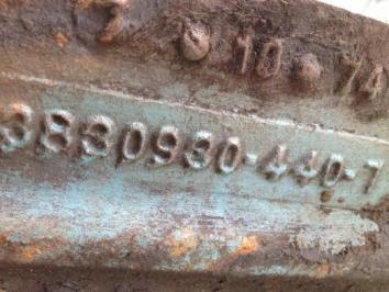

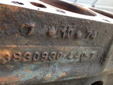

Well I got it today and it is quite rusty and filthy. Upon initial inspection it appears to be OK. I wont know any thing until I get it baked/hot tanked and sonic checked but that will be next week most likely. Then I will sit on it until I have enough to get my stroker kit and then build a 500 monster. Pics are up...cr8crshr/Tuck:blob1::blob1::blob1::blob1: 003.jpg001.jpg002.jpg
After running the numbers for this motor, it says it is a 1974 casting but the number indicates a 1975 build. If that is the case then it should have a cast crank but instead has a forged crank. And yes I do know the difference. One never knows about MA MOPAR now do we??? So hopefully a good corer and starting place. By the way...I got also with it the following:

I bet it's a truck motor. They had steel cranks all the way until the demise of the big block. I tore an original 400 down that was a 77 model and it had a really nice steel crank in it. The big blocks were made until 78 but in some applications such as marine and some trucks went as far as into the very early 80s.

Rusty...Not knowing if the chap I got it from remembers where he got it, he stated it came out of a c-body. It would be nice to actually know, but as a core I am sure it will make a nice stroker. That is if all goes well with the cleaning and sonic check. It does have a lot of rust everywhere so hopefully it is salvageable. But Free is Free so really I won't be out anything if after the cleaning and sonic check it proves to be non-servicable...

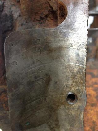

SERIES:
S = 1962
T = 1963
V = 1964
A = 1965
B = 1966
C = 1967
D = 1968
E = 1969
F = 1970
G = 1971
H = 1972
J = 1973
4T = 1974
5T = 1975
6T = 1976
7T = 1977
8T = 1978
OTHER STAMPINGS:
Diamond = 0.008-in. oversize tappets
Maltese Cross = 0.001-in. undersized crankshaft
Maltese Cross and an X = 0.010 undersized crankshaft
A = 0.020-in. oversized cylinder bore
B = 0.010-in. undersized main and rod bearings
E = cast crankshaft
H = standard 4bbl
HP = high performance
LC = low compression
O.S. = 0.005 oversized valve stems
P = premium fuel recommended
R = regular grade fuel may be used
S = special engine
WT or TW = water test
X = oversized valve guides
ASSEMBLY PLANTS:
K = Toluca
PT = Trenton
M = Mound Road
T = Trenton (400 and 440 only)
MV or MN = Marysville

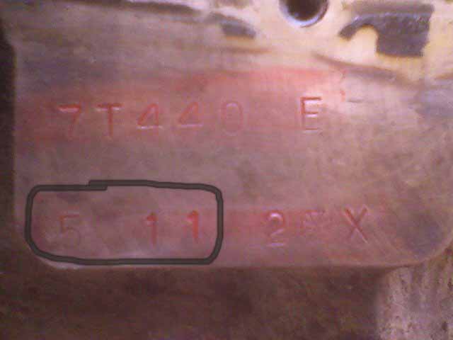

I was too lazy to ID it myself so I just posted all of it lol plus I cant read everything on the pad
I believe this is the date circled

Cool I hope this works out for you. BTW happy that things went good for you with your test.
