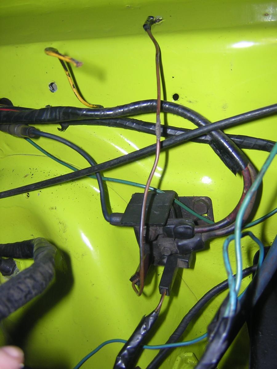

I put the stock ecu back on since I have to get some parts for the chrome box. Now it won't fire at all. Tested the starter relay and it's fine. It cranks when you put a screwdriver against the 2 posts. I don't hear the fuel pump kicking in at all. I recently painted the engine bay so I had everything off... thought I had it right... guess not. There's a yellow wire near the starter relay...should that be hooked to anything. I think it's a hot wire.

Here's what it looks like. It was just hanging above the starter relay. (it has black paint all over it.)
the yellow wire is the wire that actually trips the relay allowing voltage to the starter in your pick it looks like you have a brown wire coming off the relay just laying there? that brown wire looks to me like someone rigged up there own extension for the yellow wire by your pic i would say you need to connect the yellow to that brown wire
