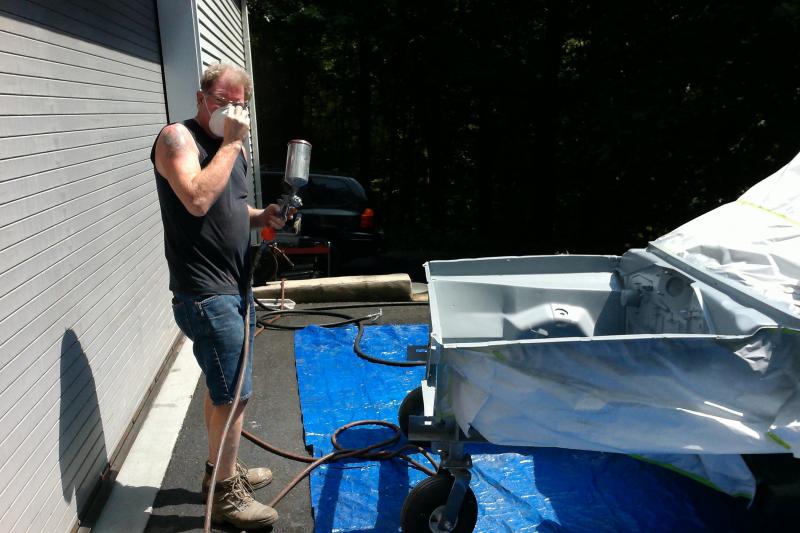

i did mine last year with one quart of off white single stage.

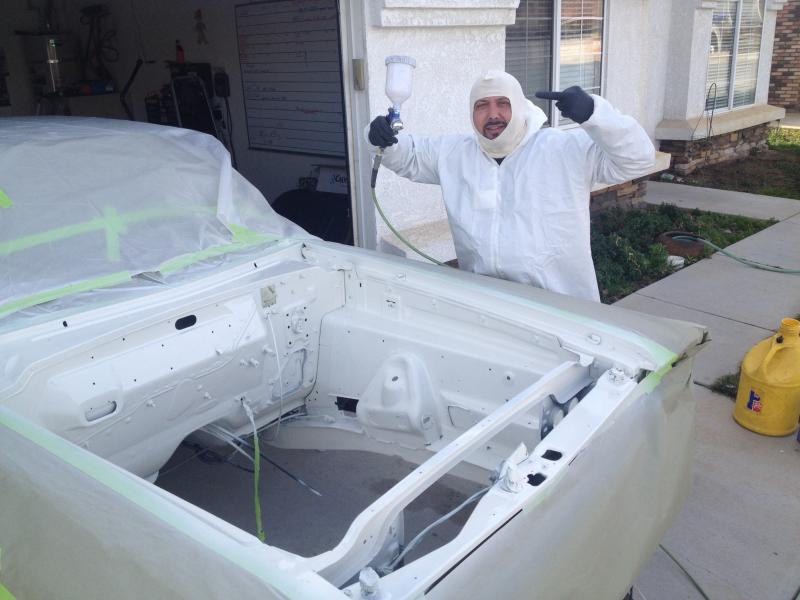

Motivational pics !! lol

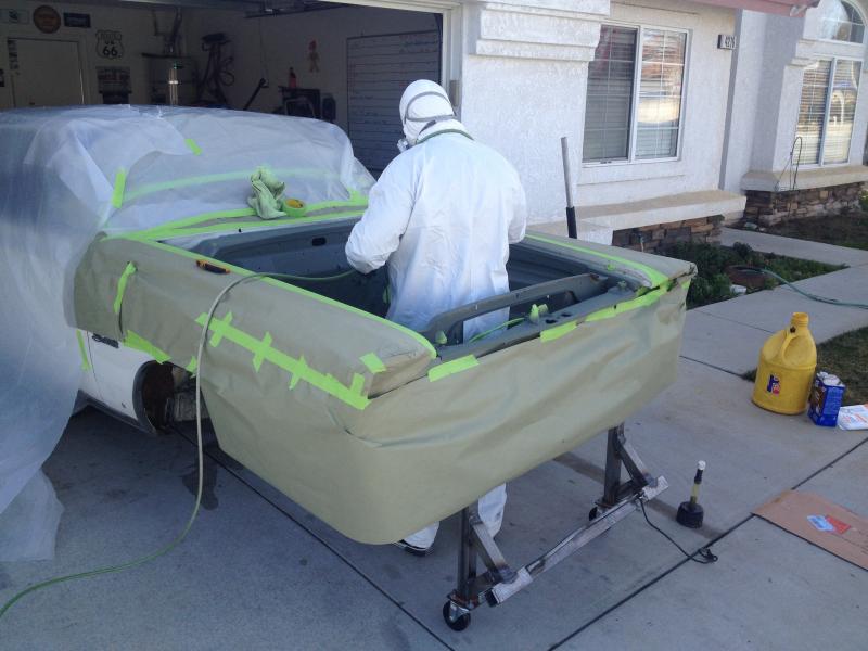

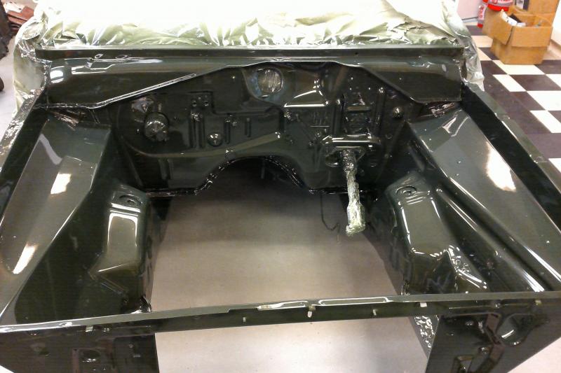

Did this one with a quart of single stage.
