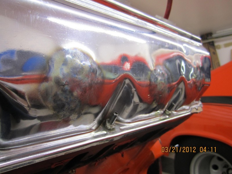

Be certain the rockers are not contacting the valve covers.Don't ask how I know:blob1:
No that area was one of the first checked. No contact at all. And that is using the MOPAR Aluminum Valve covers with the Baffles installed plus a thicker metal and ribber gasket combo. So there is plenty of height clearance. Thanks for that thought though
