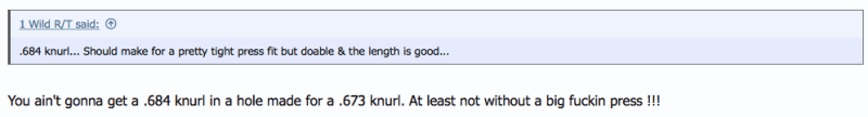

I did buy the Dorman 610-446 wheel studs and installed them today.
Re-Rebuilding the 440-493 in a 1970 Charger
Post # 354.
Wait!!! I thought those wouldn't fit... Stanton sez so right here..

Milodon, Moroso and Moser Engineering make wheel studs for the rear & front, personally i am using the Moser for the back cause the knurl is .685, 10 thousands over stock. Since we have to push the stock ones out, and some metal is lost and/or moves around, i figured something a little larger might be best. shrug... but i might be nuts... :)
For reference Moser Part # 8020.
