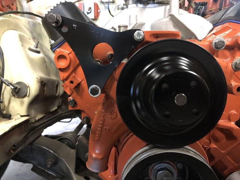

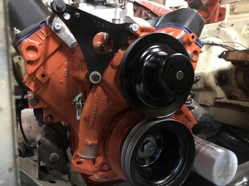

Water pump and housing are on, the pulleys are painted and ready.
View attachment 1075130 View attachment 1075131
I see a 73 & up style pump....

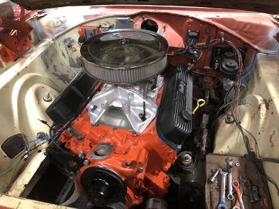

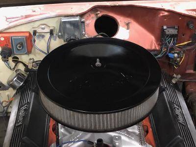

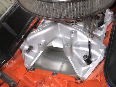

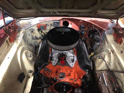

I was thinking the same thing because I also need a drop base on the Coronet, and it still barely clears. I'm solving the issue by getting a 6 pak hood.The air cleaner seems to fit.
That must be because of the LOW deck of the 383.
I am using the Performer RPM on both cars and on Ginger, I had to have a dropped base made for the air cleaner to clear.
