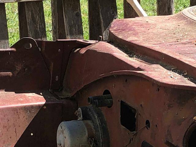

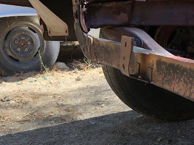

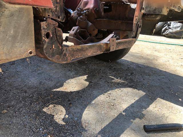

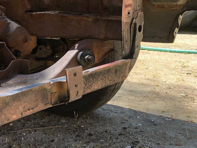

The RH frame rail has a buckle in it about 10" forward of the firewall near the cutout in the fender apron used to reach the rear alignment cams. Hard to show in a picture. The K member may be bent too, the forward RH bolt is missing and looking up, the holes do not line up.
I have a spare K member.
I am considering getting a rudimentary brake system working so it will be easier to transport. If I can find a frame shop willing to straighten it, the ability to stop it will be appreciated, I'm sure. Yesterday the prior owner said the car did have an 8 3/4" axle in it originally but there is a 8 1/4" one in there now with a 2.71 tag on it. For an additional $200, he gave me a 3.55 Clutch Sure Grip center section. Score!
I have a junkyard fresh K member in the backyard.just put a rail in it...... you can do it in a day
bolt an unphucked K frame to the good side and go from there....... it will practically put itself together

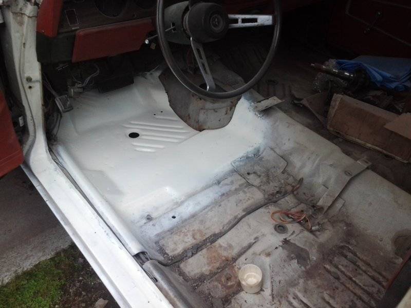

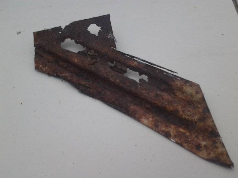

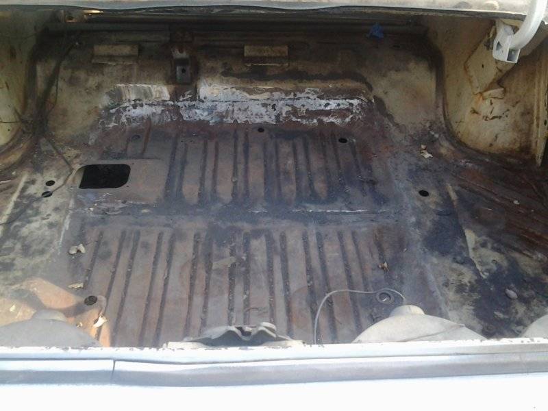

I cut that trunk floor section out of a Charger parts car in the early eighties,before reproduction trunk floor pans were made. Soon after that they became available,so I kept it in my loft and used the reproduction pieces,because most Chargers I restored needed the full trunk floor pan. Then this California Charger R/T came along that only needed the center section,and that old center section I had in the loft was a near perfect fit for this car.That center section of the trunk floor looks like what I have planned.
I was thinking of the furthest forward seam...to put it over the shock crossmember but I might as well put the seam just past where the rust ends.
