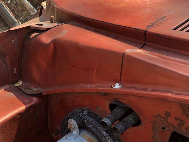

beat the firewall out from the inside, it don't need much...... I'd probably go as far as cutting the damaged piece of cowl off, beating it straight and welding it back on........

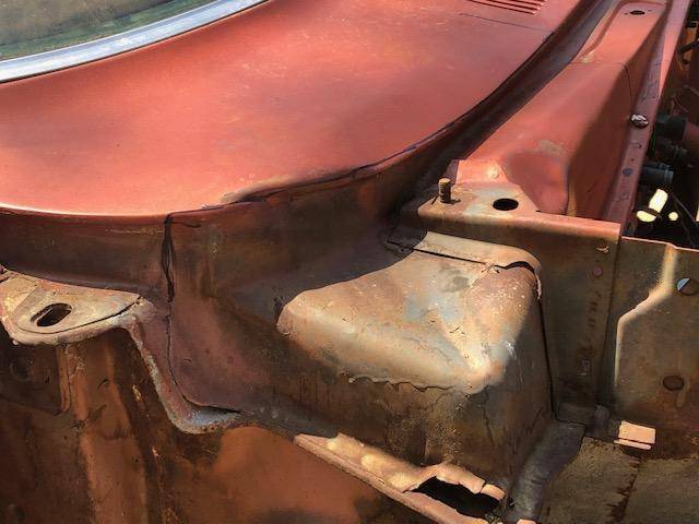

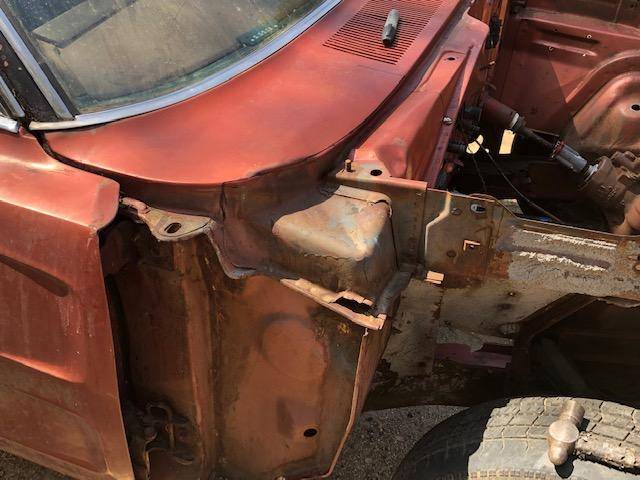

Here is an idea: Since the cowl top is curled down at the edge...View attachment 832451 View attachment 832452
What if the panel was cut along that edge..... See the point where the horizontal part of the cowl turns almost 90 degrees into the engine bay? Cut along there, Then going down that black line, remove the spotwelds on the lip leading down to the drain, turning left across that lip....
Then cut vertically up that black line ? The section could be hammered into shape, the cowl top could be straightened as well.
There are some leaves in the cowl that need to come out. This would allow me to get a vacuum hose up in there too.
Was this what you were thinking?
Personally I think I would move the one cut away from the top of the cowl & down to the bottom of that vertical area.. It would require more dolly work to fix the hard line at the cowl but it would reduce the heat going to that flat top area of the cowl..
I added to my post...I think we were typing that at the same time...... great minds lol
